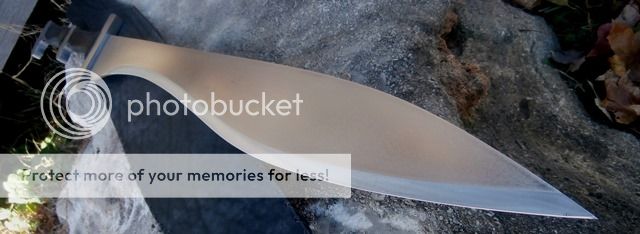

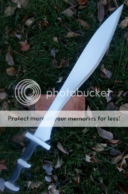

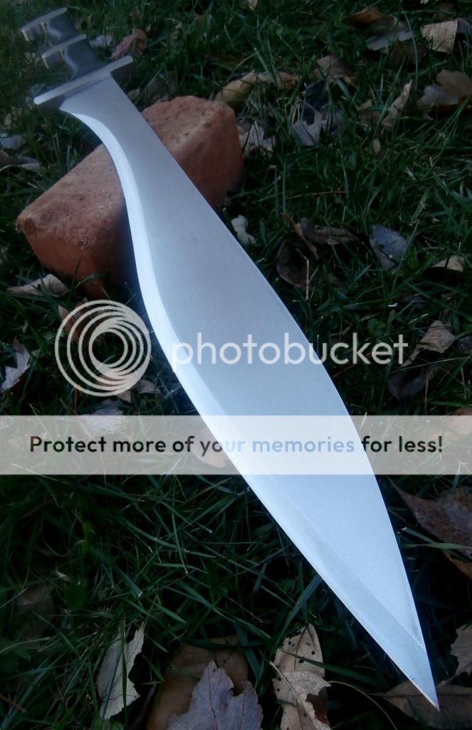

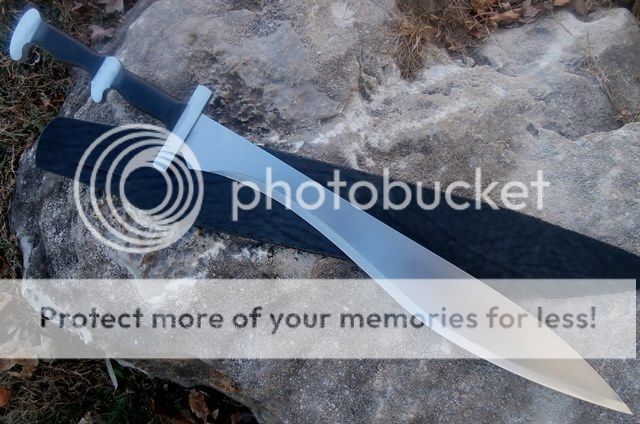

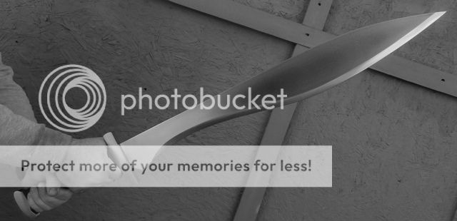

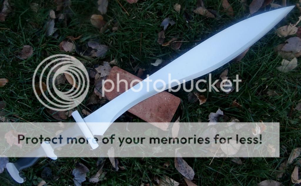

Hi all. Just completed this beast. Will be adding to the website soon and will be making a video on it. It’ll even split firewood in one swing!
The Titan Falcata Sword
Just Released the Video:
https://www.youtube.com/watch?v=796B2IHSdaI
Shop Details:
1095 High Carbon Spring Steel. Steel is Heat Hardened & quenched in oil. Heat Tempered @ 500 degrees for 2 hours, and letting it air cool.
Measurements:
Total Length = 37 “
Blade Length = 26 ½ “
Blade Width = 3 ½ widest point ”
Blade Thickness = 3/16 “
Handle Length = 10 ½ “
Handle Width = 1 ½ “ widest point
Handle: Black Linen Micarta
Weight = 5 lbs
Pictures below. Thanks.
