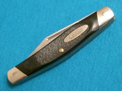

Here is a sawcut pressed Delrin scale Camillus/Buck knife. Contract made in the image of a Buck 301 but with a Camillus shield. Likely sold as a Camillus model for a spell. Delrin is hot pressed inbetween the bolsters with Delrin protruding thru holes in the liner and hot mashed flat in a sort of rivet like effect. At the same time 'Sawcuts" are pressed into the Delrin. Current Buck made factory models are made the same way but with the material "Valox". 'Oh' for those wonderful days of the long nail nic.
Fascinating! I know I've seen a thread on here somewhere where some of the techniques for mimicking sawcut marks on bone in "modern" traditionals were spelled out (can't find it, though!), but I had no idea there was a wholly separate process for doing that with synthetics.

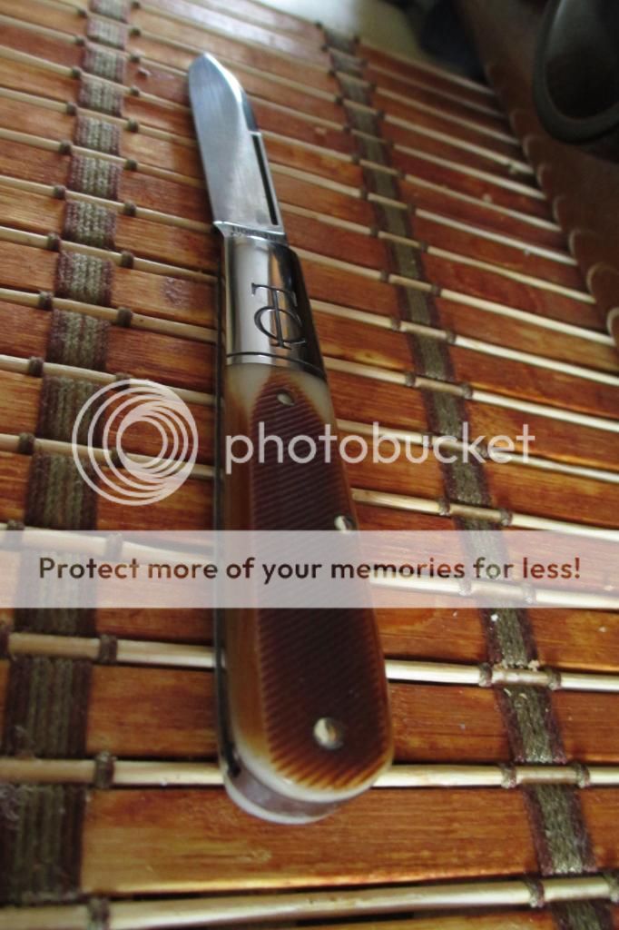

For 20 years, maybe 25 years, I have carried the Rough Rider Sowbelly frame with Sawcut handles and fluted bolsters . . . see picture comparing my knife (on bottom) to a brand new knife. The touch and appearance of the Sawcut handles has been everything and more that is mentioned in this thread. BTW, the fluted bolsters have far exceeded my initial expectations regarding wear, scratches, etc. There are more expensive handles, more exotic handles, but Sawcut just feels and looks so good.
Old & New Sawcut
