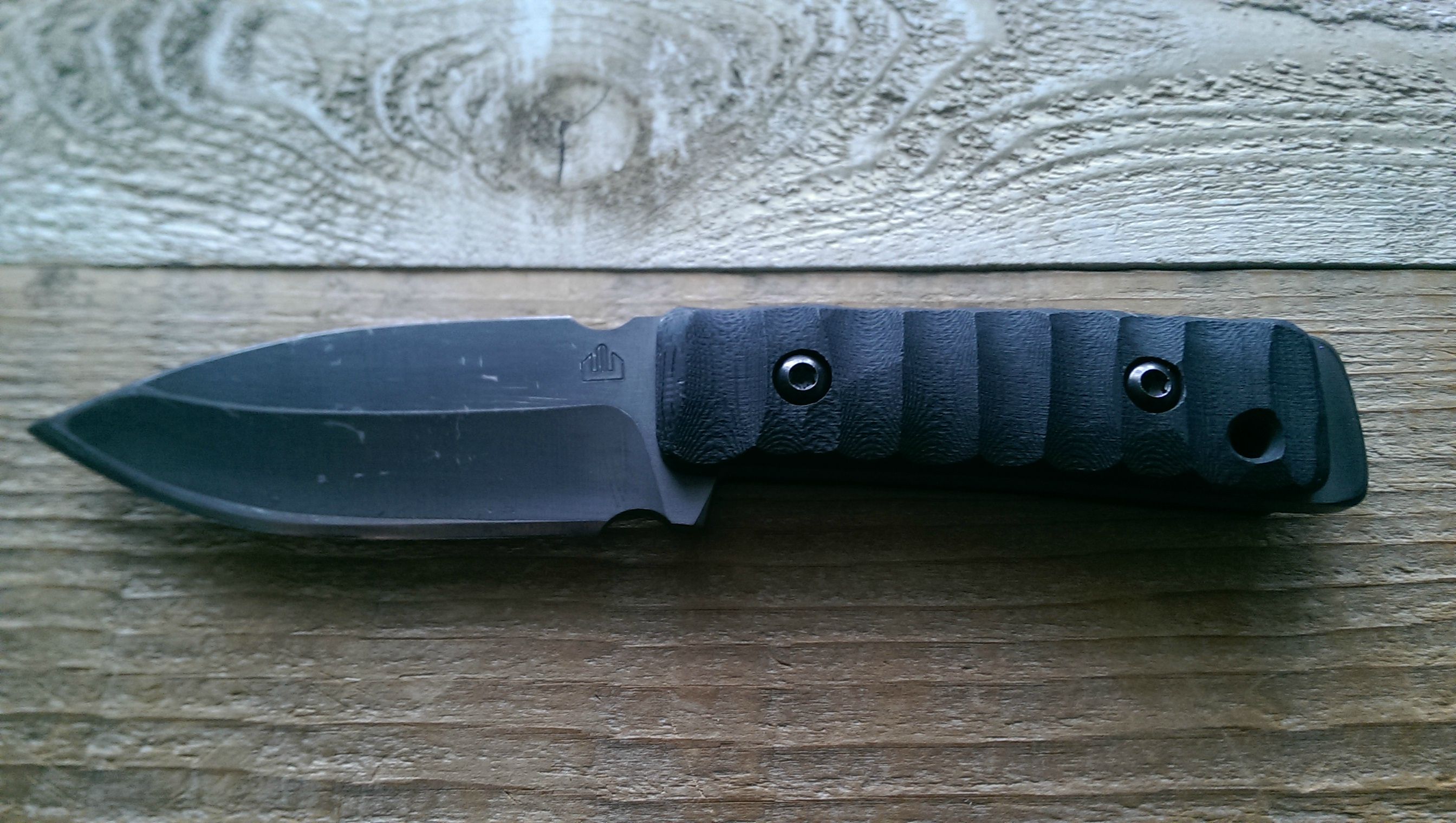

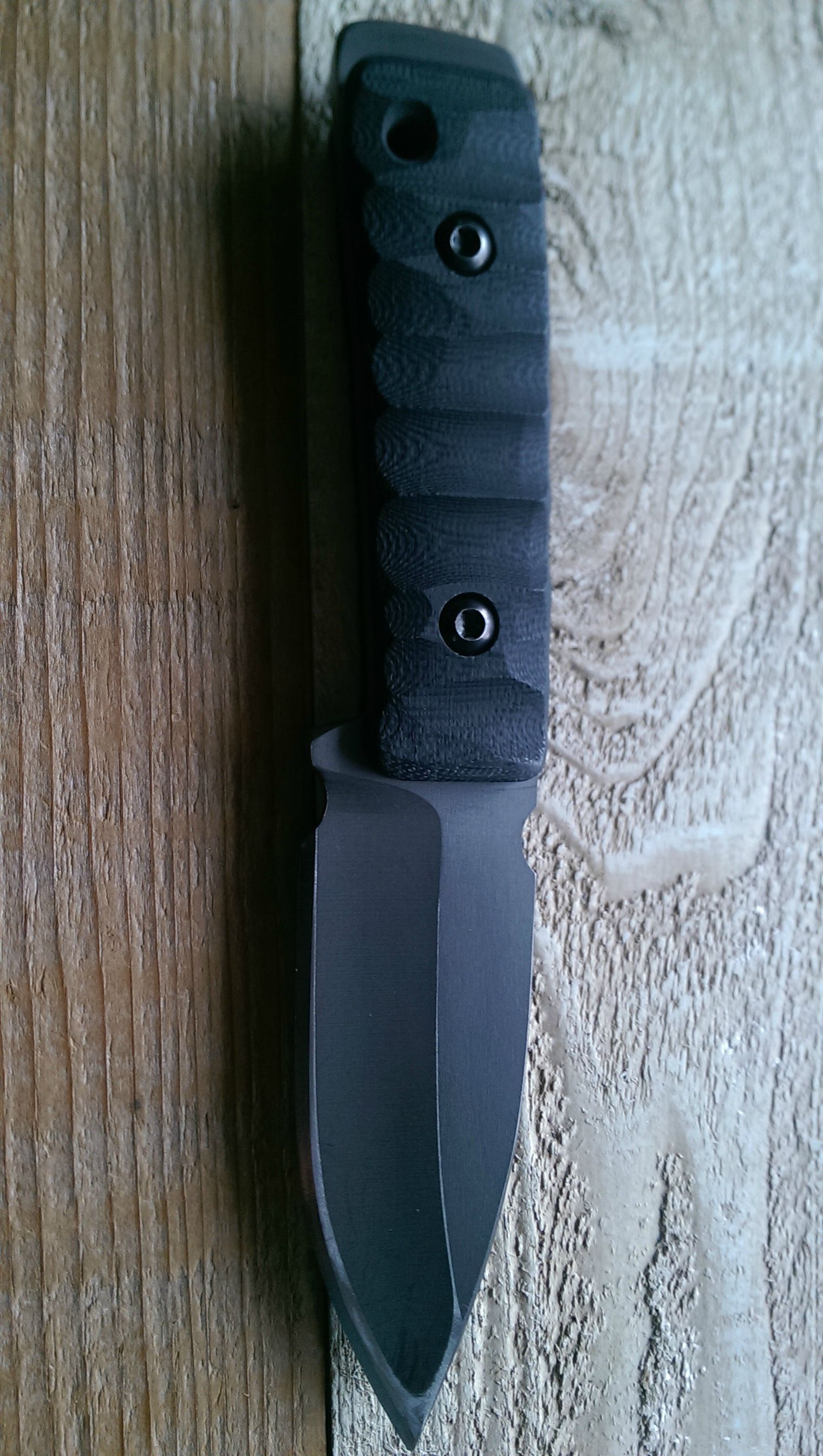

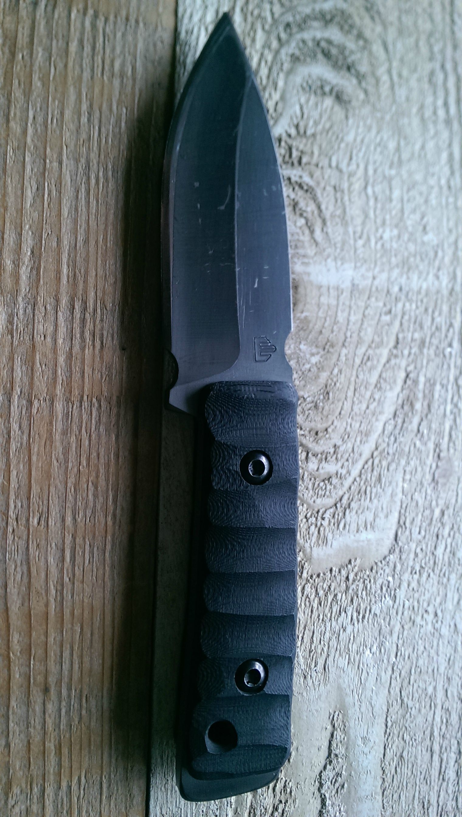

So I had a forum member send in a Crusader Forge fixed blade for a complete makeover. It was amazing to me that this thing was called a knife in the condition it was in lol. The edge was so thick and steep that a sharp axe would have out performed this easy, even if it was "sharp". The edge was about .100" thick at the shoulders of the edge and about 30 dps. I left the tip a little bit thicker after the regrind for prying strength. This was done with two colors of Cerakote: Jesse James Cold War Grey and Zombie Green. I added the toxic/zombie green liners as well, then did all the contouring after. Oh, and I don't do scale work btw... this was a one off. Enjoy!

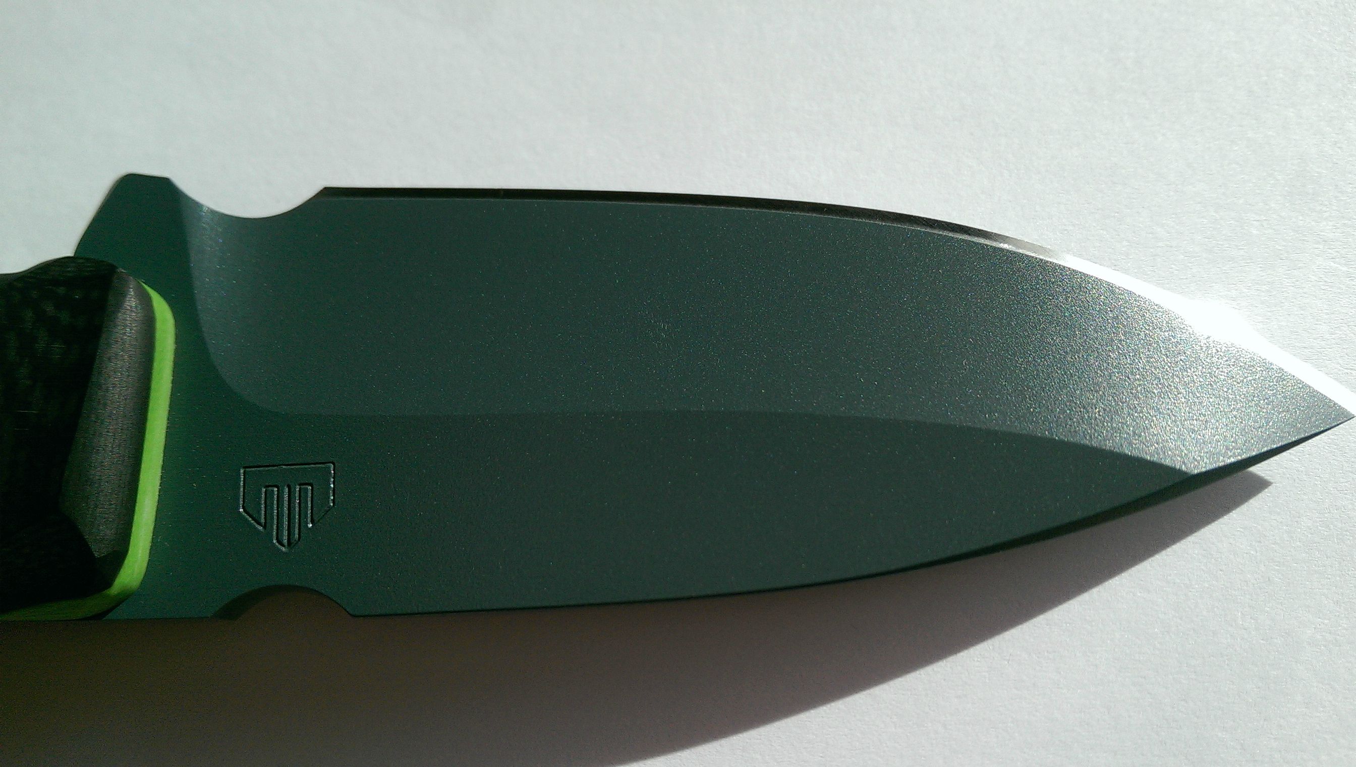

Now it is time for my favorite part: the blade work! I reground and reset the edge to more proper geometry - 15 dps at about .025-.030" thick hollow ground.
15%2B-%2B6
15%2B-%2B7

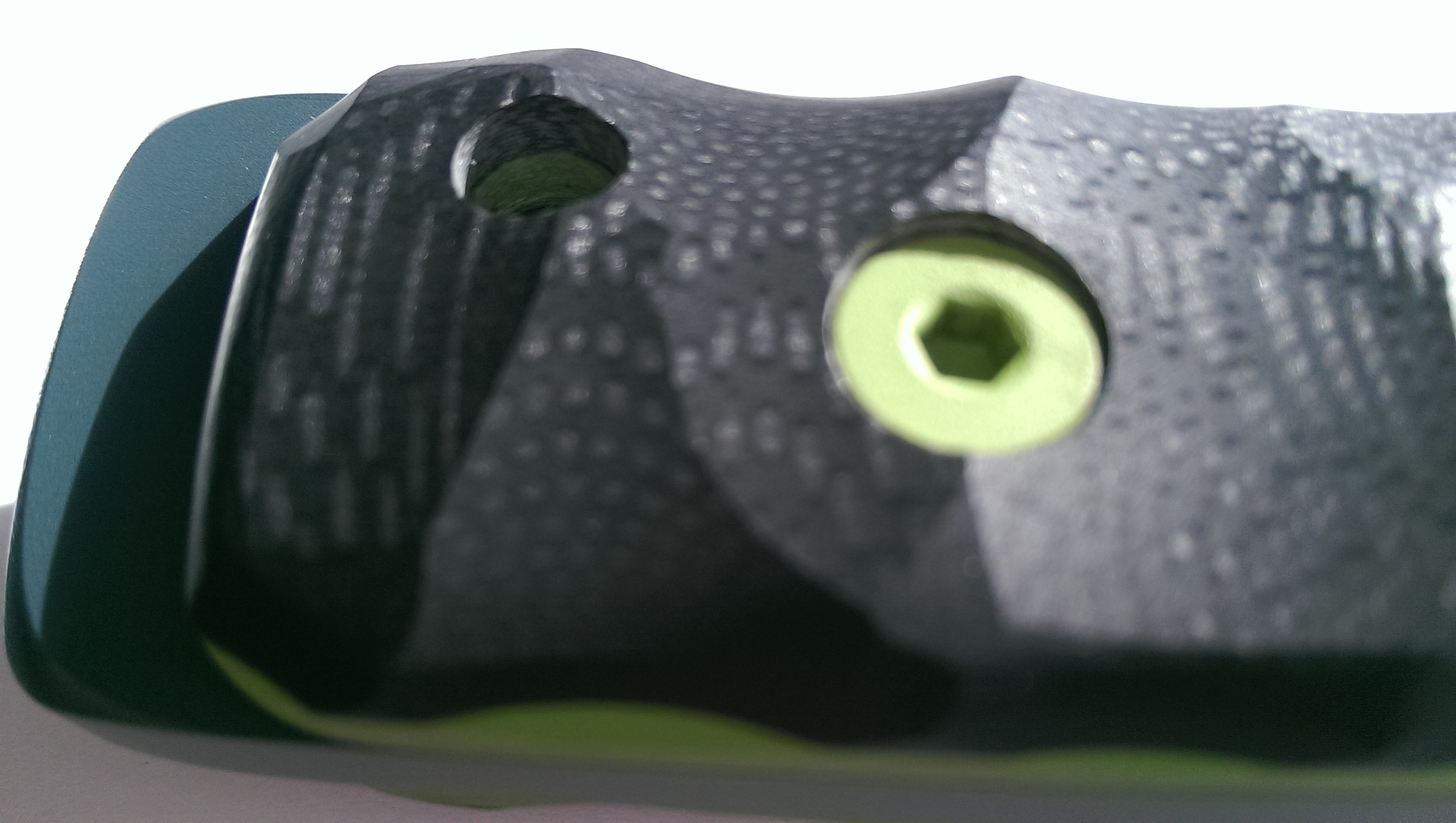

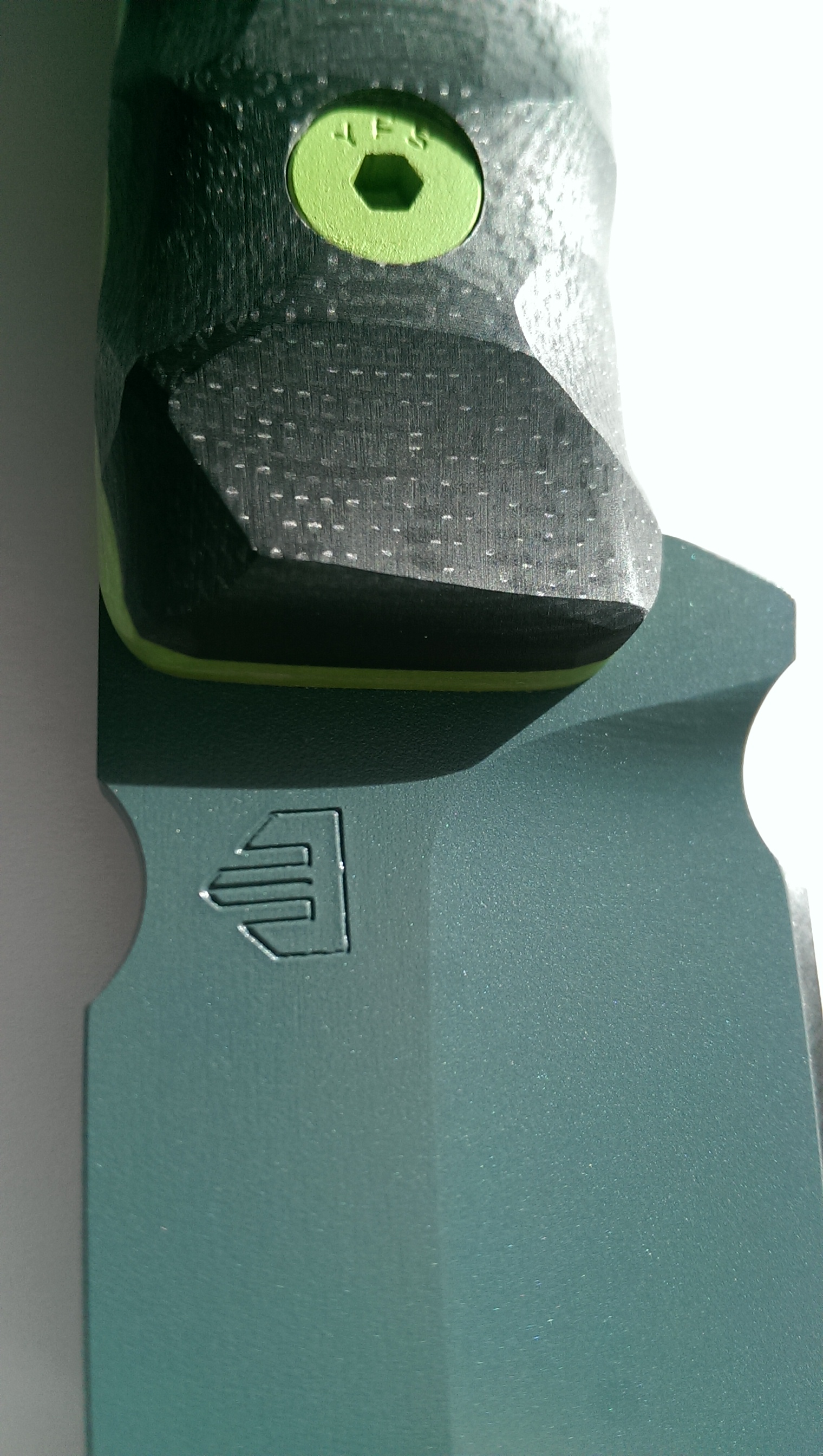

Next up was the cerakote process and then texture and contour the scales. Here it is in all it's glory! It now fits like a glove...

Notice the before and after thicknesses and edge angle of the tip:
15%2B-%2B16
15%2B-%2B18
15%2B-%2B19

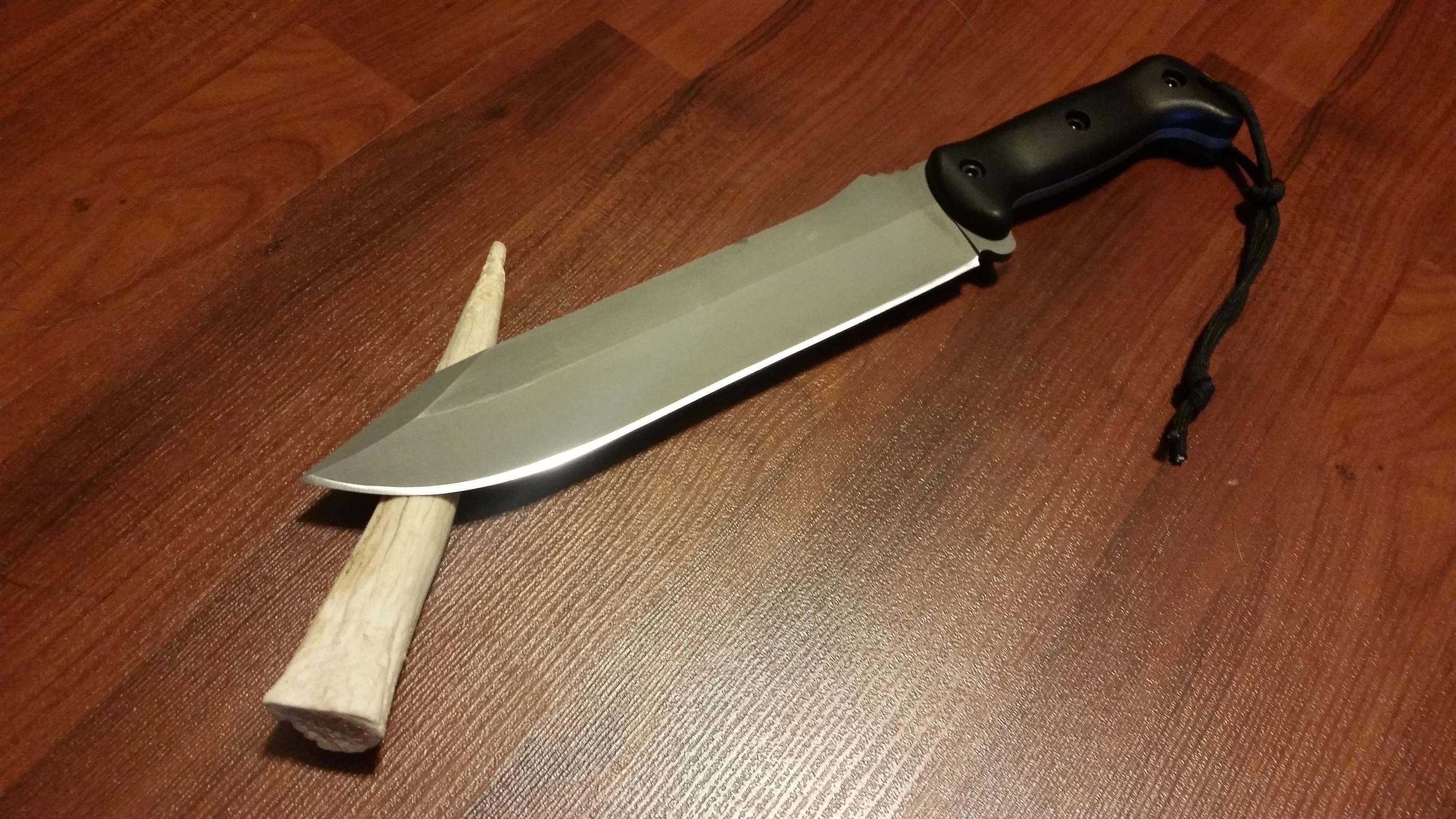

What it is now!!
And what it was...
It's just sick! My first impression.

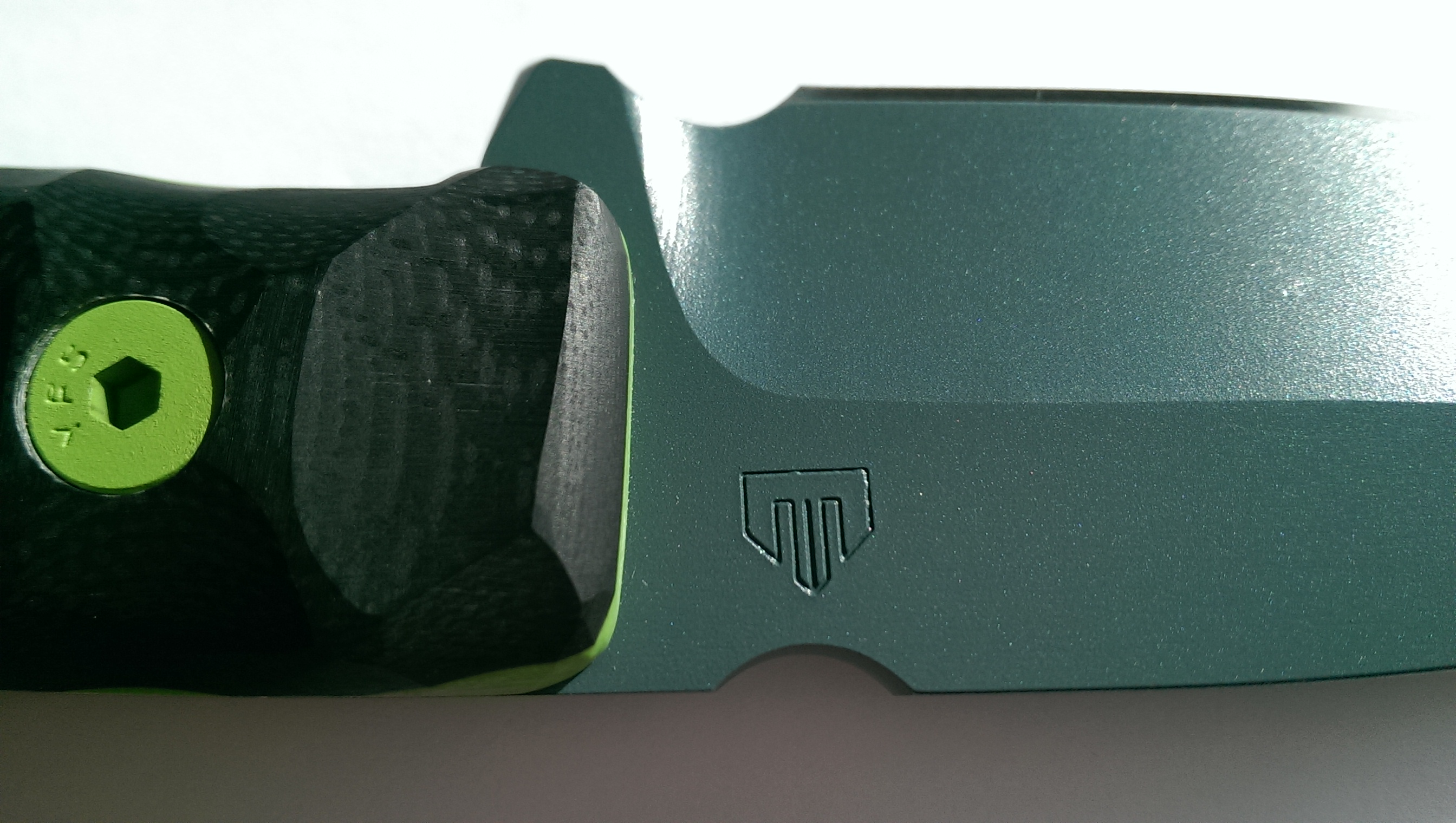

Josh's attention to detail and expertise is better than anything else I've had done from others. He earned another client with this one. Many of you on the forums have responded to me about Josh's work with your own and it was because of this, I had Josh do a full restoration.
It's incredibly sharp and still has the heft and thicker tip to do some prying.
The cerakote finish is exactly the color I wanted and is just beautiful.
The scales and fasteners are also spot on with the Toxic Zombie Green.
Josh even contoured the scales to make more of a palm swell and let me tell you what...I friggin love it. It not only looks good but feels great in the hand. Much better than originally by Crusader Forge.
Josh...I can't find a thing wrong with your work. Honestly, I am very OCD and scrutinize EVERYTHING. This is perfect! Thank you so much.
