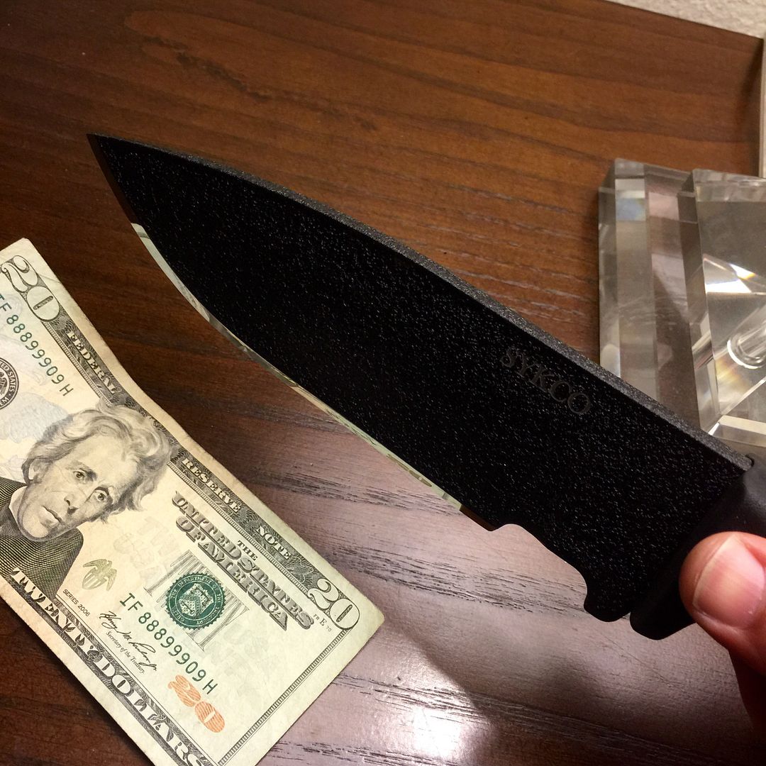

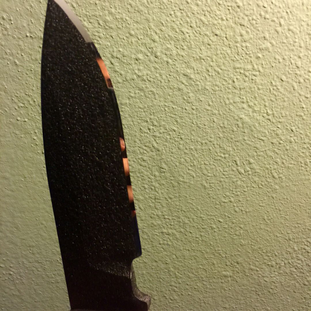

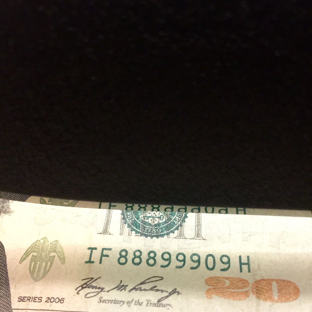

They say one man's trash is another man's treasure. I received the TRASH-1 and fell in love with the balance, ergos, and design. I felt the instant urge to bring this babe of a blade out the ghetto and into the bright city lights. So I did and now she loves me for it.
It was time for another mirror polished edge. So I re profiled the edge and the shoulders to 19 degrees per side (38 degrees inclusive). Once again, it took a while ---- but now I know this knife can't perform any better. Check it out friends!

Thank you sir!! I sharpen the edge to 19 degrees per side and use the following grit progression:
Diamond Stones: 100,200,400,600,800,1000
Ceramic Stones: 1200,1600,1.4 micron, .6 micron
Balsa Wood Strops: 5 micron, 3.5 micron, 1 micron, .5 micron
I love my Wicked Edge Sharpener and I have yet to see a sharper blade at the same edge angle
