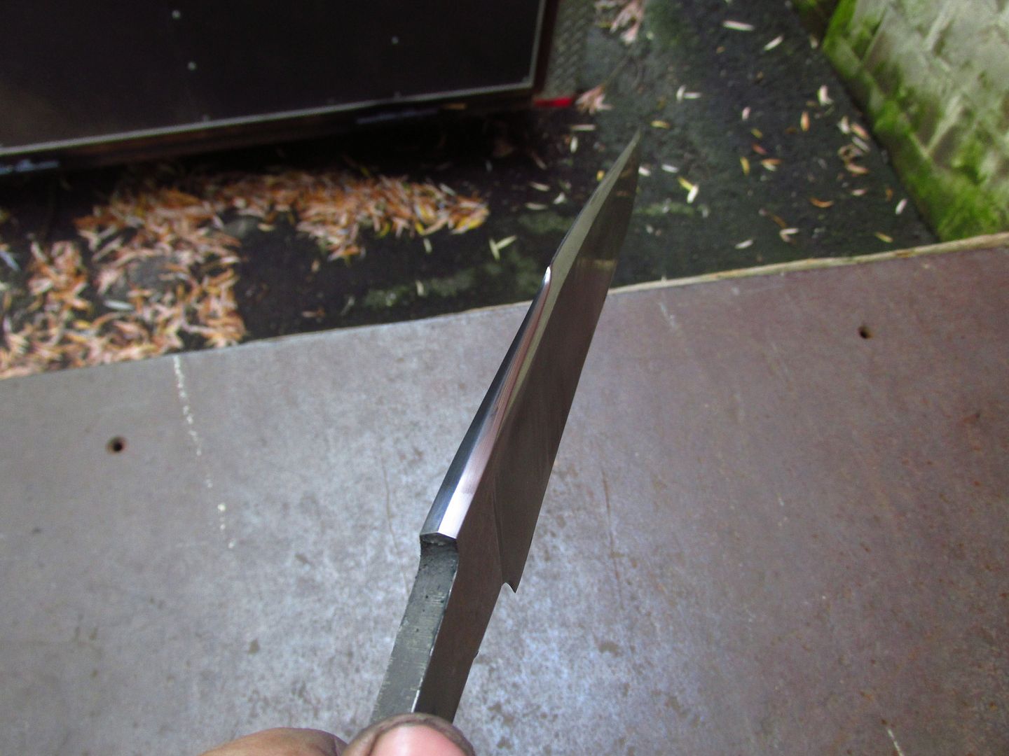

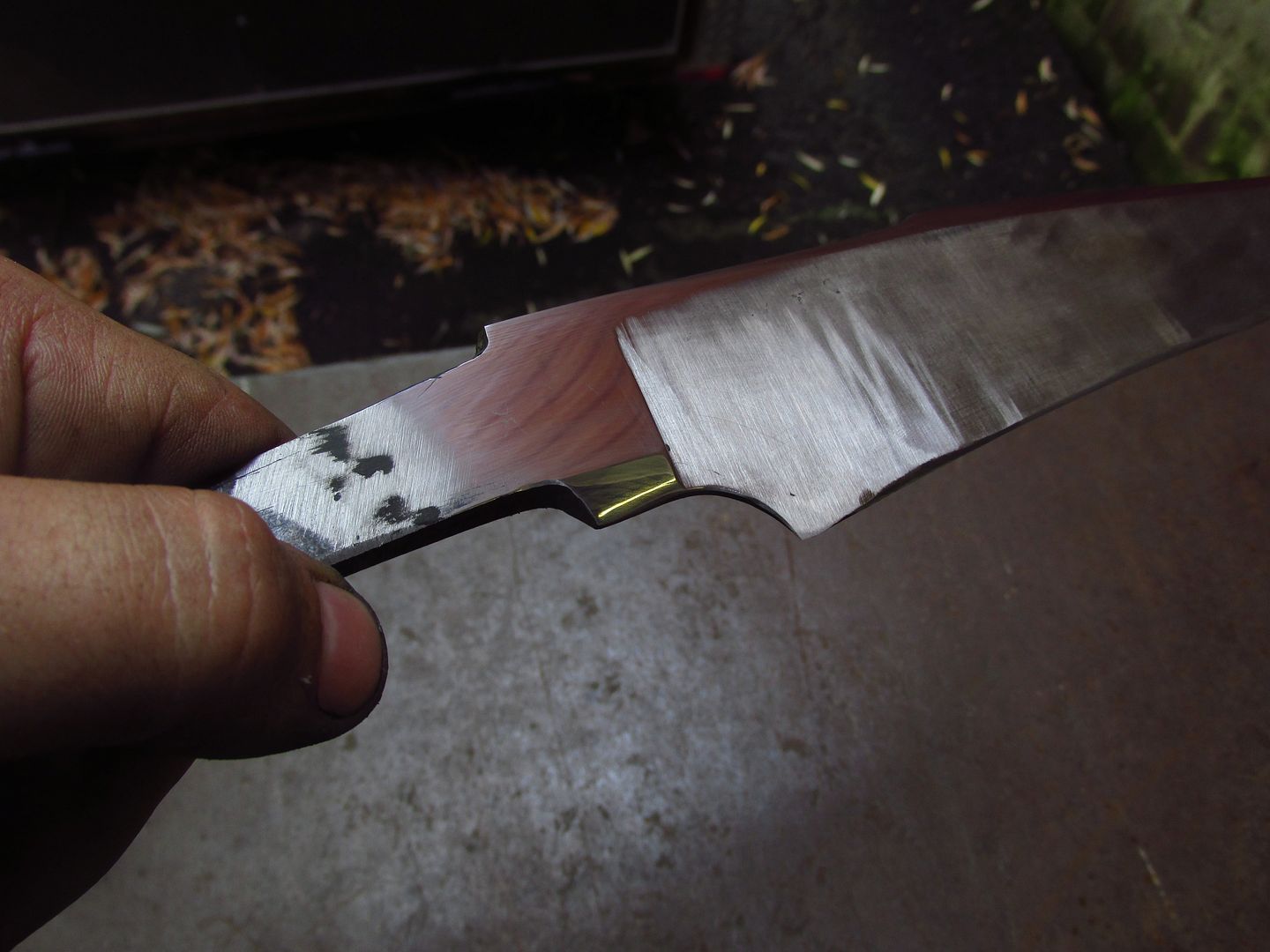

Here I have polished the ricasso and clip to a rough 1,000 grit
Then up to 1500
And then the spine bevels brought up to 1500

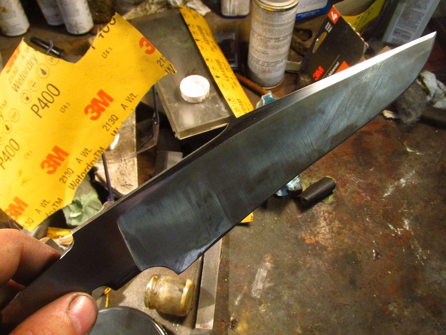

And then just at the very end of the day I started sanding the primary flat of the blade. Only six more faces to go!!.....Why do my fingers hurt so badly??? :P

Gary that's kind of you to say and far from the truth lol but it is still the highly layered steel and you won't see the layers until later on in the polishing process but after the initial blade cracked and I folded the parts back into a new blade it brought the total layer count up to between 6,000 and 8,000 layers so pretty darn fine. When holding it at just the right angle you can make out the layers in the current state but it will become much more apparent later on.

So unfortunately I only have one photo today, I am hoping to have all the polishing and etching done by Monday, but as of today one entire side and the spine are at 1500 grit:

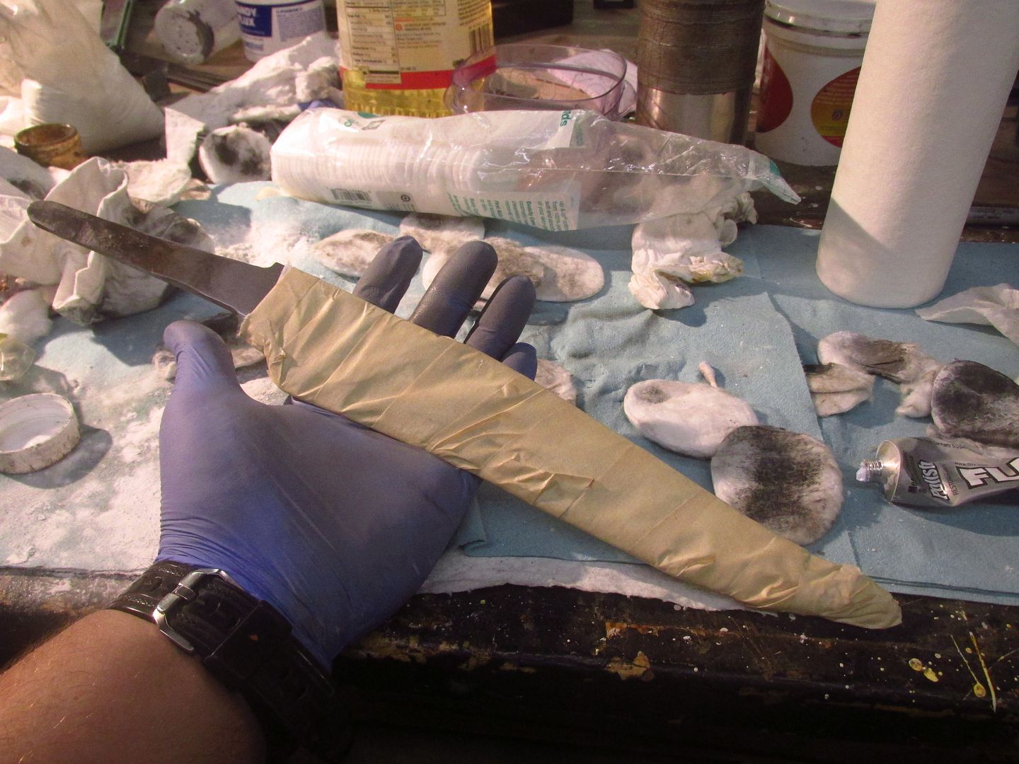

The blade is all polished up and hidden away from prying eyes...muhaha! But in all seriousness I forgot to take a photo of the nearly finished blade before putting the wrappings on and didn't want to go to the trouble of unwrapping it. :)

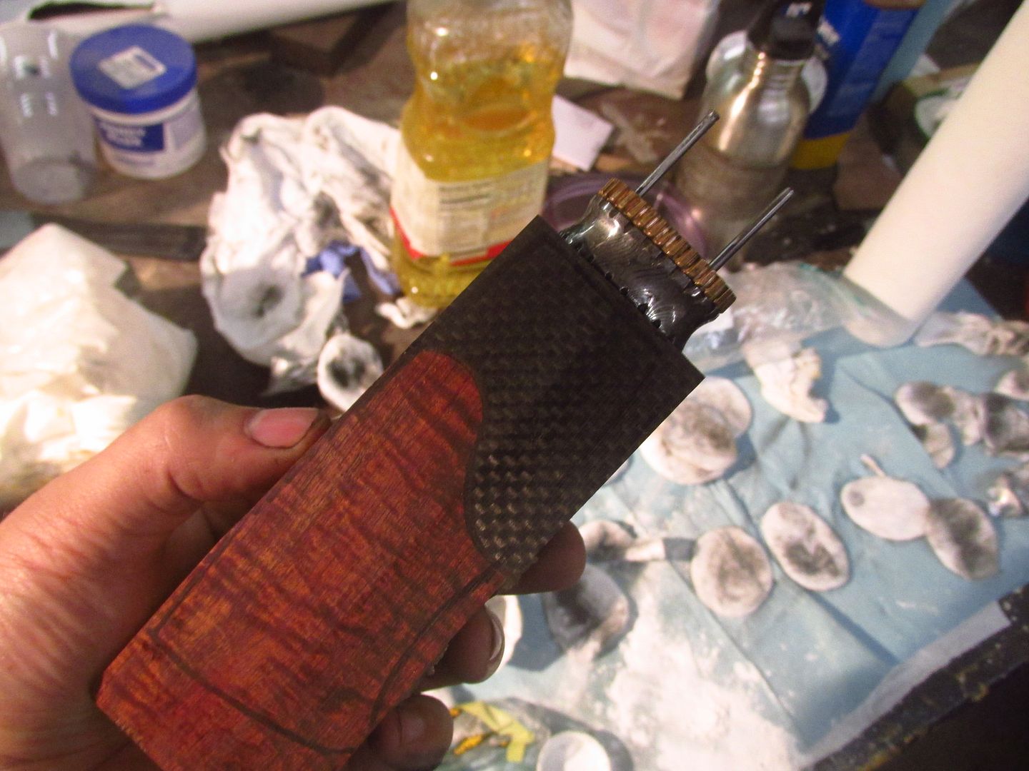

Once everything is all flat I then super glue the guard spacer on to the top of the handle to prepare for the pin holes to be drilled:
Then everything is drilled and checking the fit:
Then I brought down the carbon fiber to flush with the spacer so that later on in the clean up I won't have issues with clean up.
And that is all for today, much more to come tomorrow:

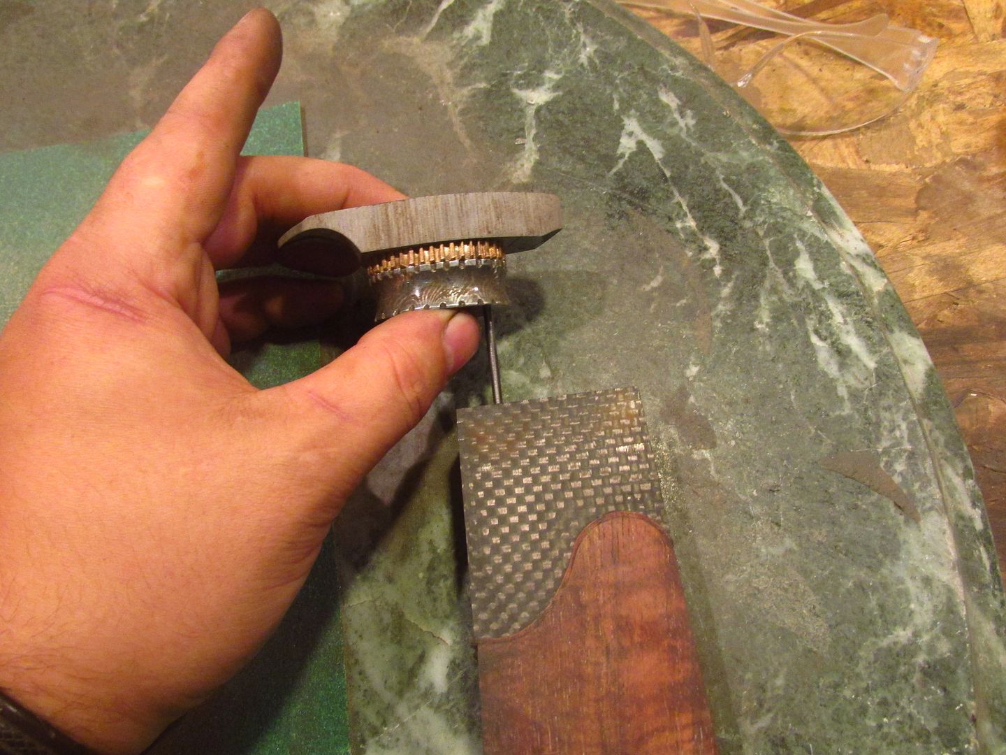

- I realized that I forgot to post a couple of pictures from yesterday, so before I take off here is where I am at currently.
The handle, bronze spacer, and pattern welded spacer are now fit onto the handle leaving only the main guard left to be fitted which will be done upon my return. Yesterday after getting everything fitted I did the first round of etching on the spacer to see how everything will go together.
