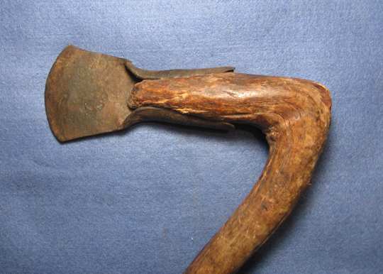

Behold--the first draft prototype of the Traveler's Celt! A pack-friendly tool that can be used in a variety of ways depending on what the situation calls for. Use as-is as an ulu or hand axe, on a haft made from the junction of a branch with the trunk to use it as an axe, adze, or hoe. On a straight shaft it can be used as a bark spud or digging bar. The lashing holes (for an extra secure fit) are missing from this example and the rolled edge of the socket will be going away so they can grind the socket on an angle so that the top-down profile forms a virtual wedge instead of being off to one side.
It was inspired by Bronze Age socketed axes and the various tools prized by poor rural agriculturalists in developing nations. As most of you know, I'm a huge fan of machetes, and for many of these blue-collar (or no-collar!) folks the machete is the tool of choice when you can only afford a single quality steel tool. However, in many places like rural Africa and Asia, the hoe is the tool of choice. For others, it's the axe. This tool is designed to serve as a counterpoint to the machete in such a "one tool" situation for the kind of survival those people call daily living.

The idea is in the ability to have a versatile tool kept in the pack that can be readily field fashioned into a larger harder to pack one. It travels with the user in its "larval form" where it is of some use as an ulu, hide scraper, chisel, small splitting wedge, etc, and if things should turn serious it may be turned into a capable chopper for crafting things away from civilization. :)
I suspect that if you added an edge to one side at a ninety degree angle you'd have a serviceable cleaver and axe on there too. Make some sort of sheath that could reveal only one edge at a time and the versatility of this thing goes through the roof. I like it, reminds me of the Cold Steel Bushman but taken to the next level.
I plan on squaring the concavity on one side for use as a scraper when making handles, and do agree that a double-beveled edge on one side could be quite handy--I had been considering adding one. The question is whether or not to have it come stock with those options as opposed to letting the end user modify it to their own desires. ;) I may make those Special Grade options and simply build compatibility into the stock sheath.

have you actually mounted it on a branch yet? im seeing a whole bunch of work to get the needed section of log/branch out of the donor tree... without already having an ax, how would something like this be accomplished? also, i am having doubts about the strength of the limb to trunk connection, especially once its been wittled down to such a small section and mounted. the design lends itself to a huge amount of pressure and leverage being imparted on that branch/tree joint.. i would hate to spend such a huge amount of time fashioning such a handle, to have it break off in the first few good whacks.
i feel as though i could do the same with a small ax or hatchet. do you have any ideas of why it would be a better choice to pack over a small ax or hatchet? seems like a healthy hunk of steel!

To remove the section of branch/trunk, baton the blade into the trunk to remove the needed portion. The strength is quite high, as it is made from wood grain that flows through the curve. Such hafting methods were used extensively during the Bronze Age and early Iron Age, and even survives today in rural Africa. See examples:
Bronze axes
Modern steel African axe (locally hand-forged)
