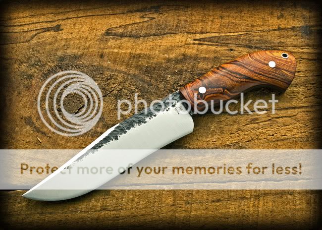

I started doing some "rough" knives a few years ago, and it wasn't for economic reasons. I will qualify that my version of rough is not very rough, meaning that there are forge marks or pseudo forge marks, but they are right where I want them and nowhere else. It doesn't take much less time to make the knife that way, than it would a typical blade with no marks left at all.
This is a typical example of what I'm talking about:
In the case of this knife, the blade isn't hand-finished, but I've done them that way too.
For me, like Tai, it was about giving the finished piece a sense of where it came from. I remember thinking about all the time taken to forge a blade, then going back and systematically removing all evidence that it was forged at all. From the few years I've been doing it, I find there is an increasing demand for them - maybe an increasing appreciation for them.
