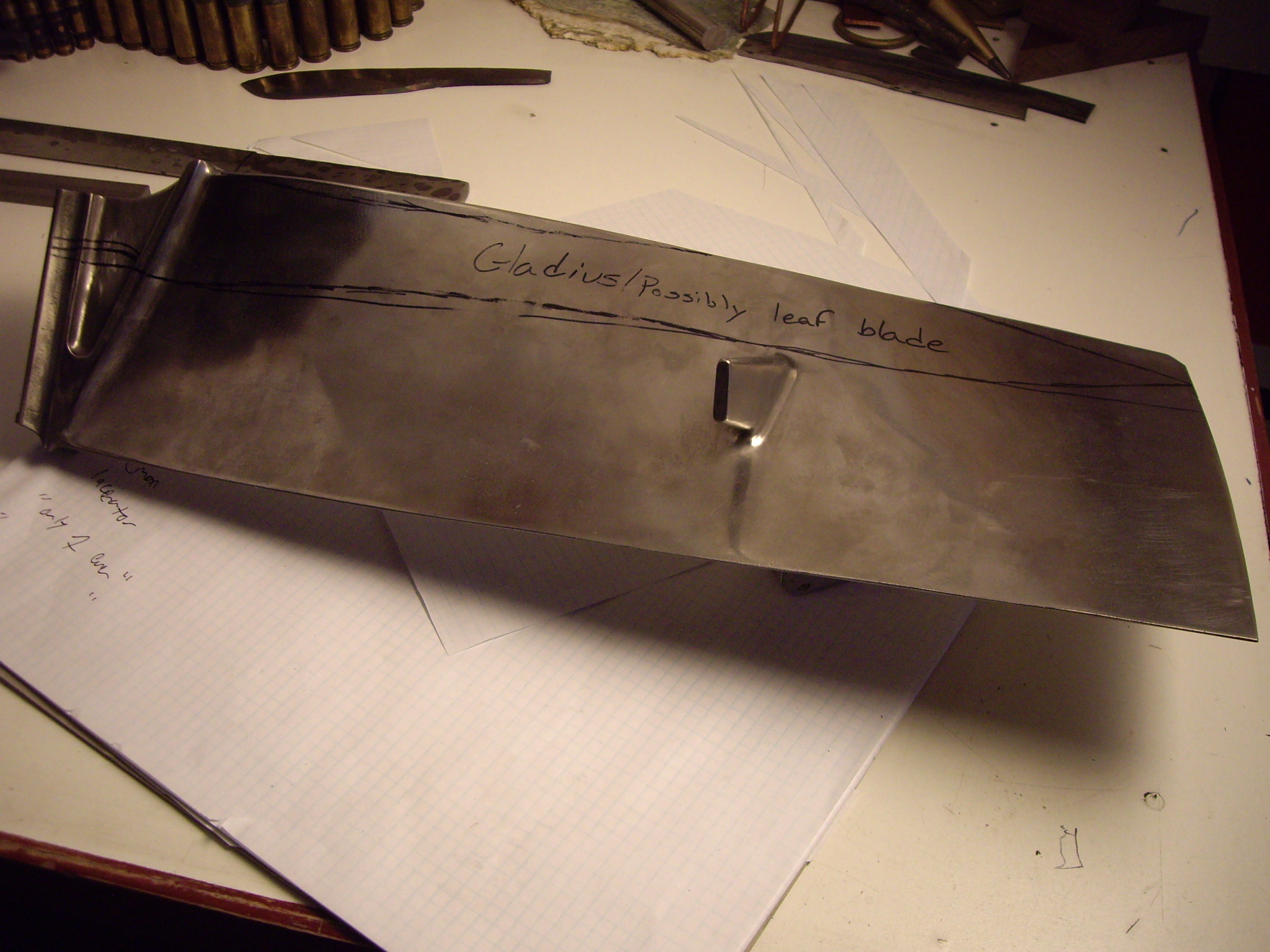

It all began when a suspicious and ominous package arrived, containing this:
A cast titanium fan blade from a C-5 Galaxy. According to my sources, this is alpha-beta titanium alloy 6-4-2-4, similar to Ti6Al2Sn4Zr2Mo, but more juiced up. This is basically 6al4v (grade 5) on steroids and pounding protein shakes. Hooray, a new titanium alloy to try, and it's even sort of flat already! What could go wrong? :D
The metallurgists who designed the alloy did a good job - its properties are just what you would want in a turbine blade: very rigid but able to flex, slick and hard-surfaced, yet gummy and resistant to crack propagation. If a bird was going to get sucked into a turbine engine, I'd hope the blades are like this one.

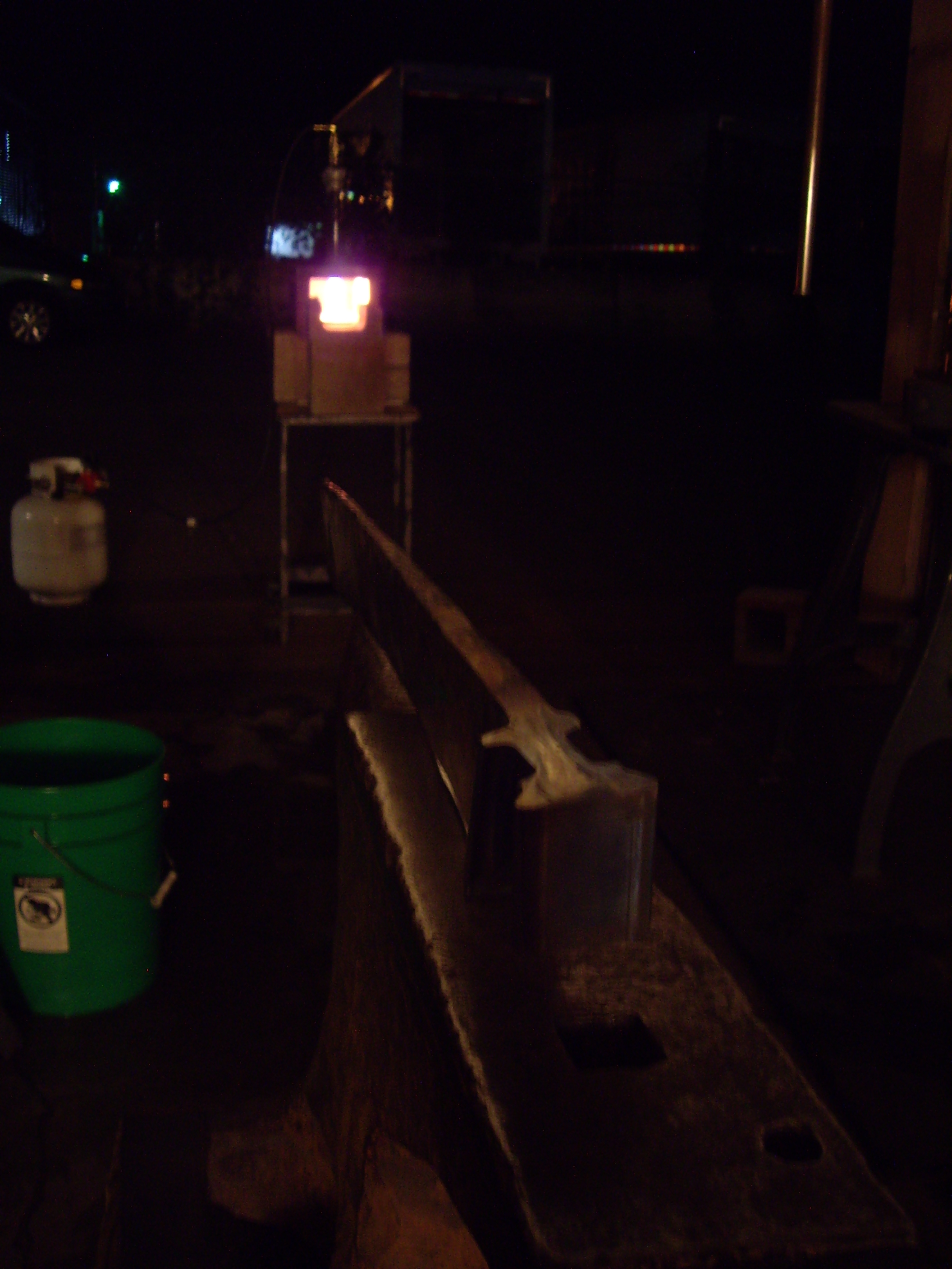

It took NINE German-made reinforced cut-off wheels to get through this blade. It is tough.
The twisted blade piece needed to be flattened. This metal was just obscenely, staggeringly hard to forge. I threw everything I had at it, and eventually it became impossible to continue until I got a real trip hammer running.
Drawing out the boss end into a tang was surprisingly quick once I got it under a Little Giant 50#.

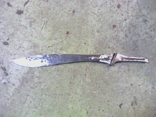

Grinding was a pretty much normal ti pain in the ass. However, this alloy releases a ghastly, poisonous-smelling gas when it's ground. Even a full-on charcoal gas mask couldn't block it out all the way. It makes me appreciate the non-poisonous ti-nb beta alloy I normally work with even more.
Straightening. :)
The blade was convex-ground to zero along its length. It is quite thick by the guard, and tapers rapidly toward the tip.
Apparently it looks like a "falkri," or falcata-kukri, haha.

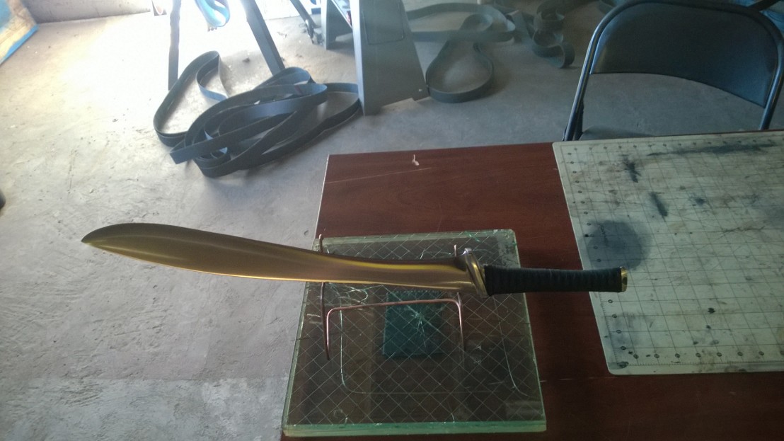

"Update! Just got it back from Sam, heat treated/pommel added/balance adjusted...and it's freaking awesome!" -WValtakis

The sheer amount of R&D that went into designing the alloy and blade characteristics is mindboggling...and then we hacked it up to make a sword:cool:;)
The distal taper built into the blade, the harmonic balancing...I maintain GE designed the perfect titanium sword by accident :confused:.
Even the ringing is weird... if you hang it by the pommel and thwack the Blade it's got a normal ring that dies off in about 10 seconds, but there's a dull hum that continues for over a minute:eek:
