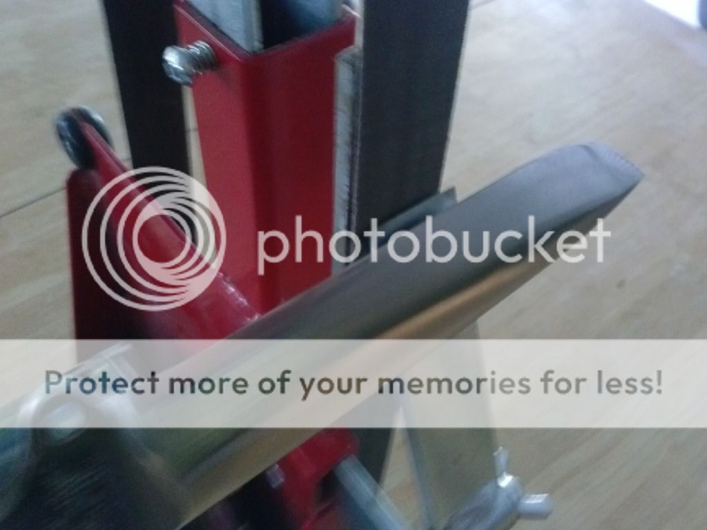

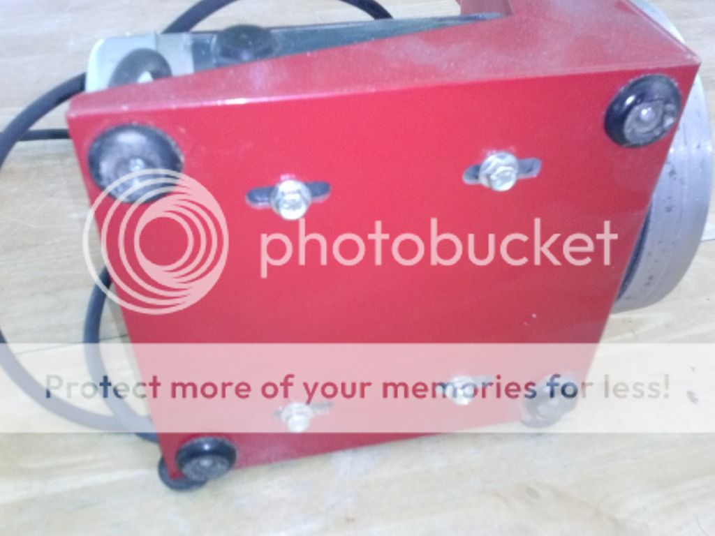

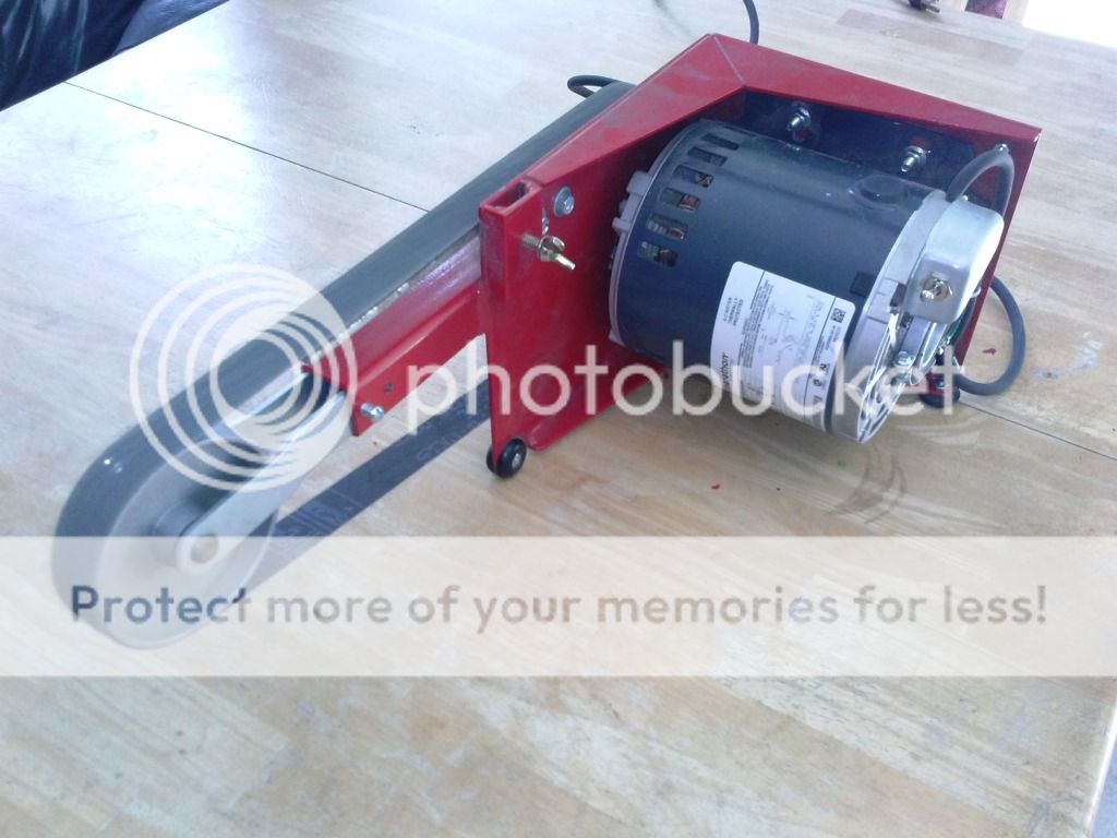

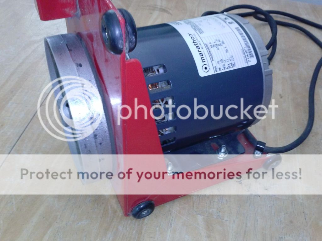

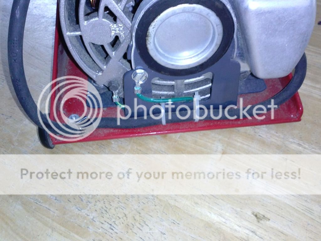

Here are the bumpers I added. There are a total of seven. Four on the bottom and three on the back for laying the machine horizontally.
Also, mounted the power wire to keep it out of the way and added a piece of leather to the platen to smooth things out on contact.

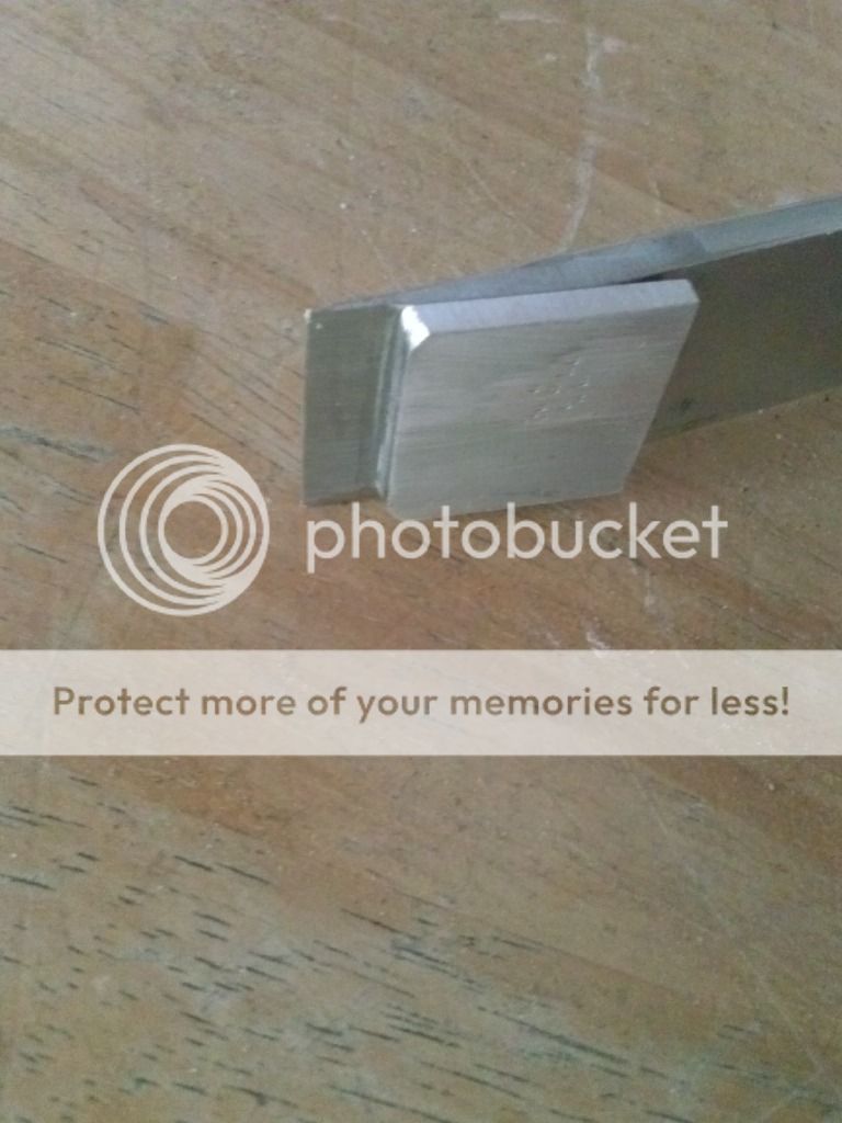

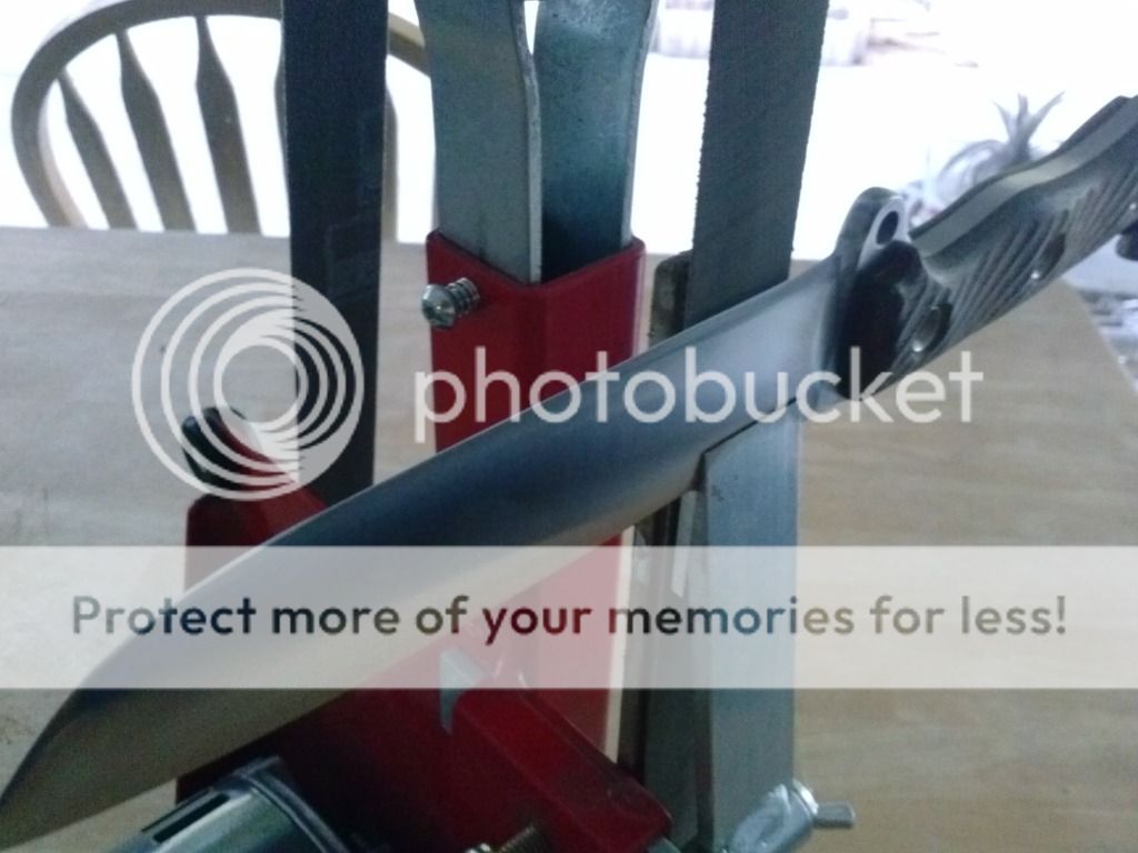

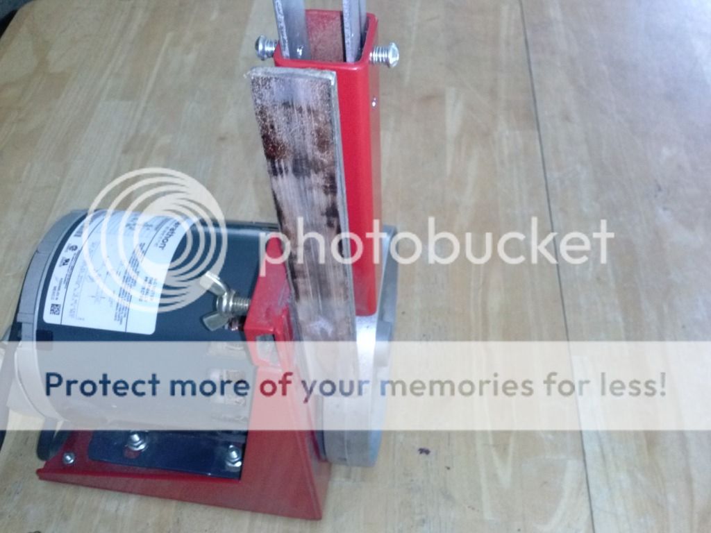

I added this piece of aluminum with JB weld to create a jig for setting edges and re-profiling.
The spine rests on the aluminum then the edge is introduced to the belt and moved across. The blade is completely locked in at all times at a set angle all the way around the belly to the tip. It is pretty much fool proof, very easy to use and provides excellent results. The angle is adjusted to any degree by moving the jig in or out.
The very first time I used the jig I took this .22 Busse with a thick ass grind down to about .18 with thinned out shoulders. After I set my angle I removed the platen allowing the belt to wrap around the blade for a zero convex grind.
Not a single problem, everything went perfectly, even, and the knife went from a slug to cutting like a laser.
Good thought on the jig, however it seems dragging the spine across a fixed guide will cause the bevel to change throughout the edge. I hold a thumb against the guide, using the other hand to drag the knifes spine across it adjusting to hight of the blade.
I'm not sure what you are describing. The spine and edge on most blades are parallel so the edge remains even. I can raise and lower the angle of the spine to some degree as I make each pass to accommodate any curves in a blade. I do a dry run with the sander off while setting up. To keep any curves in the blade consistent, I pick the imaginary spot on the belt where I want the edge to contact as I make the sweep up or down and adjust the spine accordingly.
Keep in mind this jig is for keeping things even during heavy material removal. I do all my sharpening free hand. I could see using the sharpening accessory as intended on thin kitchen knives but I find it difficult on thicker blades. The other thing to consider is if I have it set on 25 degrees and I am sharpening a thick knife with a wide, full flat grind, the angle of sharpening is not going to be 25 degrees. It will be more because I am adding the angle of the blade. Think about a wide saber grind. If you place the flat part of the blade on the accessory you will be getting the proper degree. If you place the bevel of the blade on the accessory the degree will change.

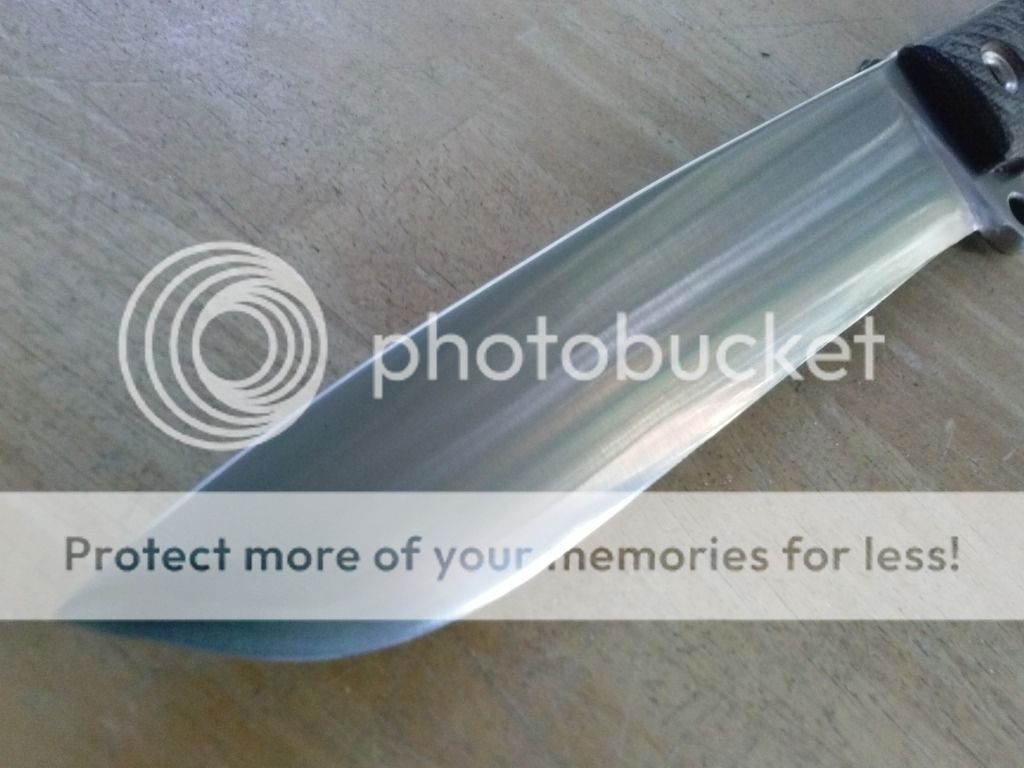

I like this grinder very much. This is the first knife made on it.
