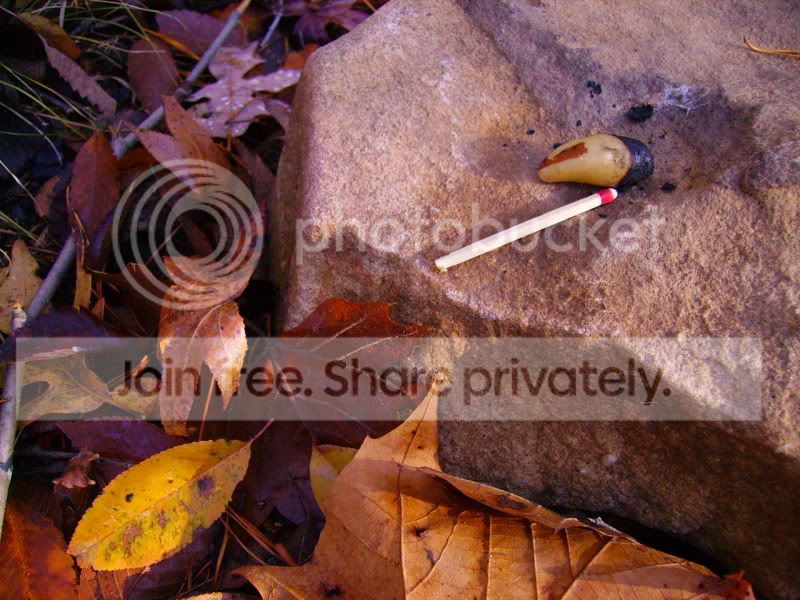

Due to weather work was delayed one day...so...I took the opportunity to go out back and experiment a bit. Using only one match, a Brazil nut, and some damp wood I started a small fire...it was small but enough to let me know how much Brazil nuts could come in handy out on the trail, serving the tripple purpose of being edible, making a decent candle, and as a firestarting material under some circumstances.

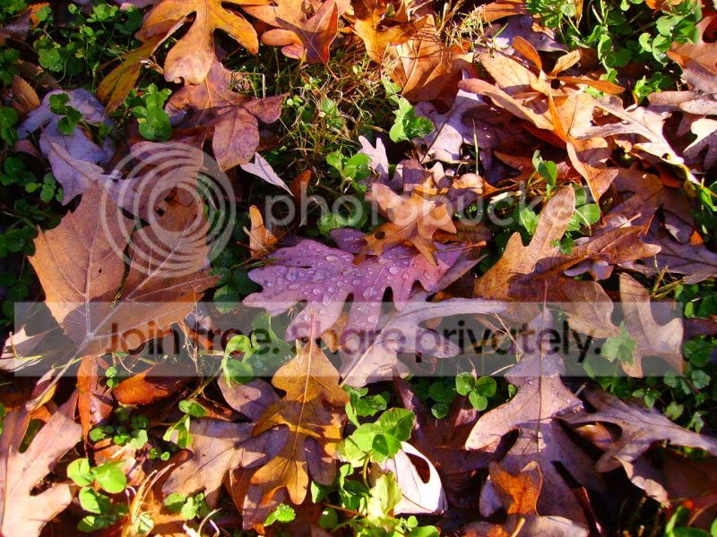

The conditions were very damp after three day of precip. with the previous day's precip. being a wintery mix of snow, sleet, and freezing rain.

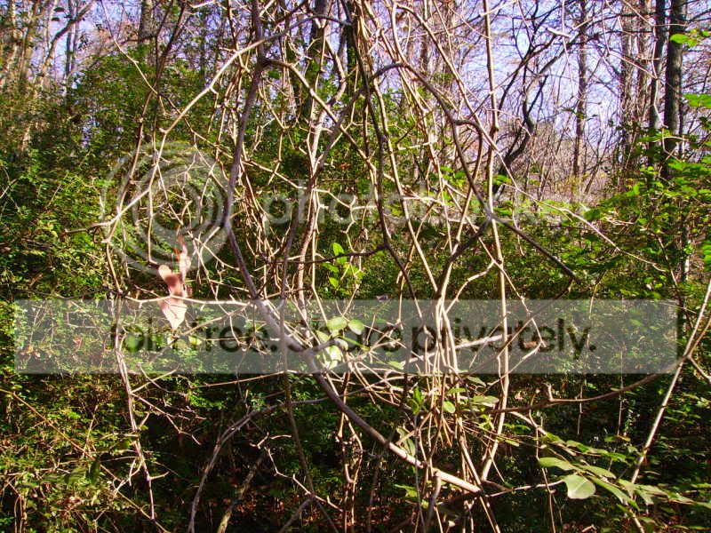

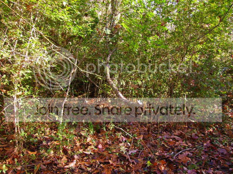

I picked my smallest tinder from some dead vines hanging above the ground
and the rest from dead branches tangled in vines and other limbs

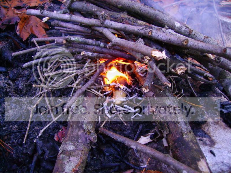

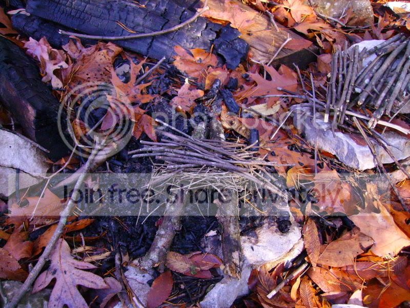

I prepare my tinder and kindling as always, smallest to largest and ready to go

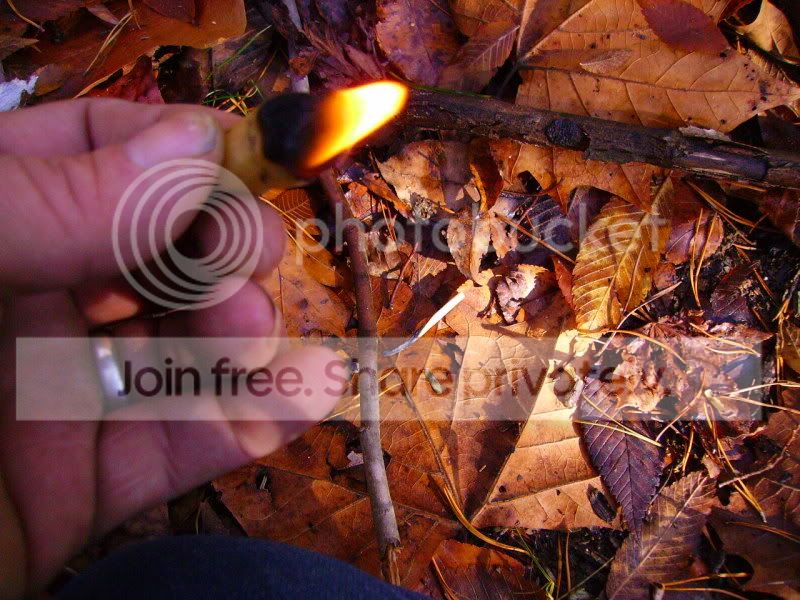

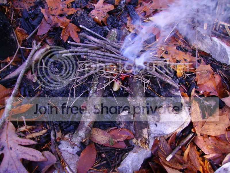

then using only one match and a Brazil nut
I light the fire, you can see all the steam.

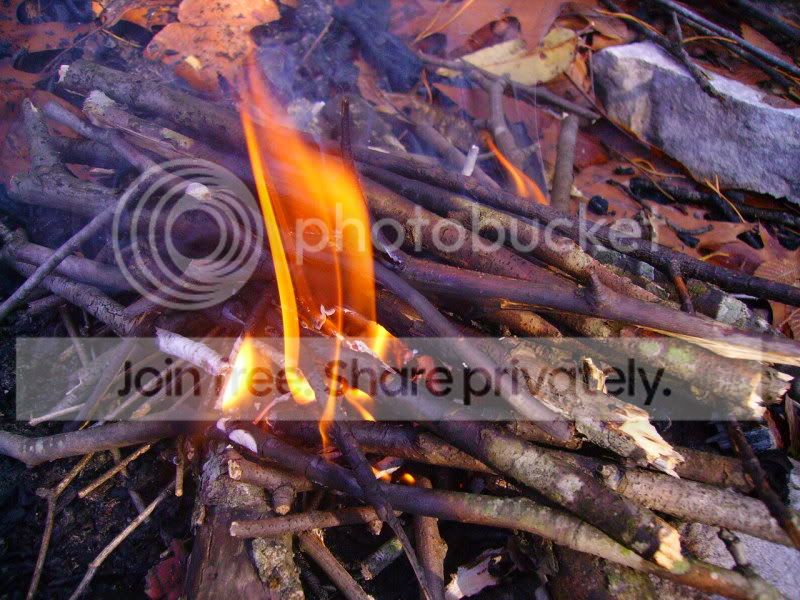

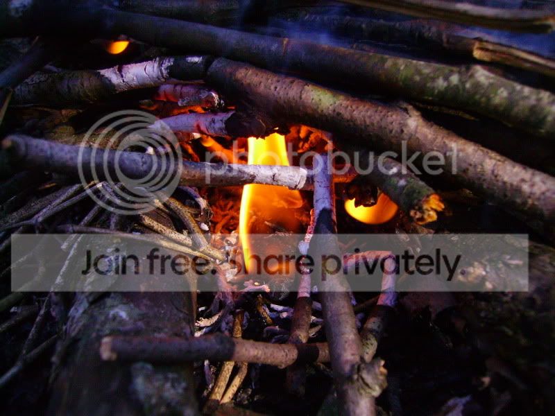

You can see the Brazil nut burning well and drying out the damp wood above it in this one
I didn't do enough prep to actually get a good fire going as I didn't have that much time to kill and didn't want to have to put out a big fire, but it was plenty to let me know how well it would work in the future.
