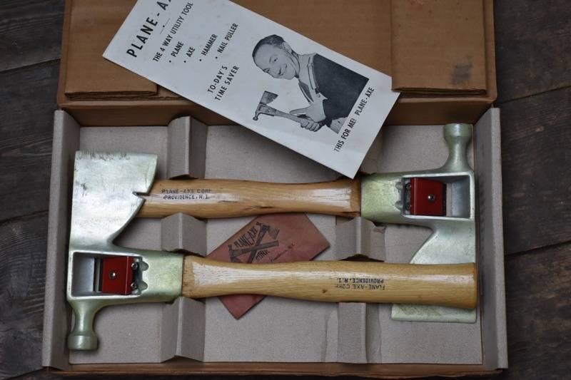

I'll add a couple to this thread. Here's a pair of NOS Floataxes. Hollow aluminum with a steel bit, lightweight to carry on an aircraft. Designed to be filled with water or wet sand to give it chopping weight.
And I was able to acquire this pair from a fellow forum member in a trade.

Square_peg those are both very interesting! The Floataxes are such a great idea. I would love to see how it feels in the hand being full of water or sand as you swing.
