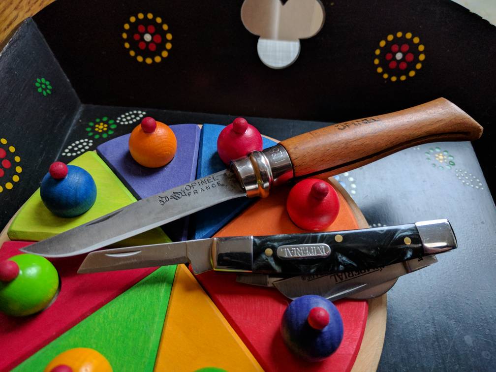

To keep up on the knife content, I use an Opinel #8 for the 'heavy' work and an Imperial Congress for the detailed cuts:
Well, this thread got me inspired to pull out the Congress Carver this evening. I only had really small basswood blanks, so I worked on this little guy. I might decide to paint him up and turn him into a tree ornament.

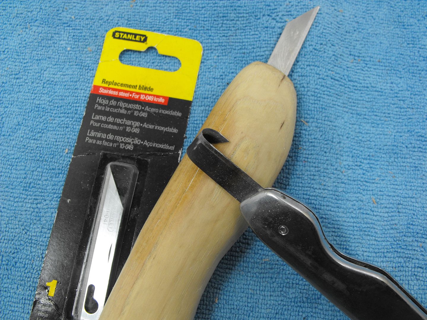

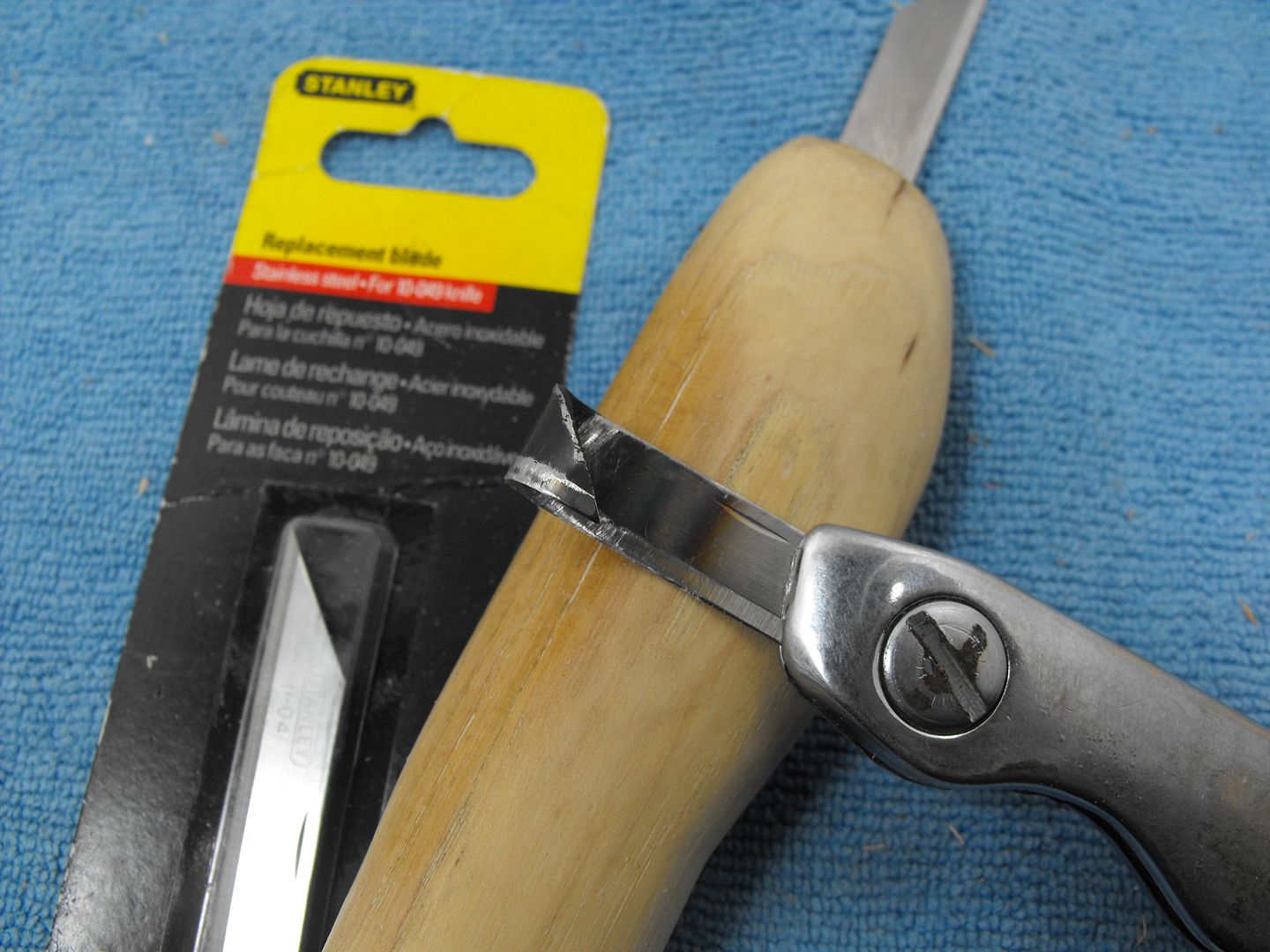

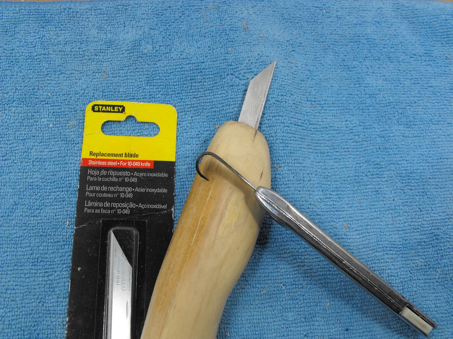

Luckily, I'm a whittler, not a carver, so I won't be needing gouges anytime soon. My spoon knife was a lot less work than that. I just heated a blade for a Stanley 10-049 utility/pocket knife, bent it into a U shape and dropped it into a pan of oil. Ugly? Check. Functional? After five years of use, gotta check that box too. Would I warranty it to someone else? No way, but it works for me. And if it does break, I'm out a buck and a half and 15 minutes of labor. Pretty sure I've gotten my money's worth out of it already.
If that works use it!
Does this thing keep an edge after this treatment?
If it does - wonderful.
I may have to do some experiments with some of the utility knife blades in this connection.
If this works it would sure speed things up, and provide people with really inexpensive crooked knife possibilities.
That's pretty slick. Do you magnet test etc or did you just wing it and it all turned out?
Does it hold an edge like O-1 at Rc 60? Nope. Did it ever? Nope. Can I carve a spoon bowl without stopping to sharpen it? Yep. As far as I can tell, it's no better or worse than before I mangled it. It's made of some unknown stainless steel so I don't expect a lot from it, but it is adequate for my limited and simple needs.
Just winged it. All that magnet testing and air cooling stuff is needed to soften a file enough to work it, but it isn't necessary just to bend a utility knife blade.
