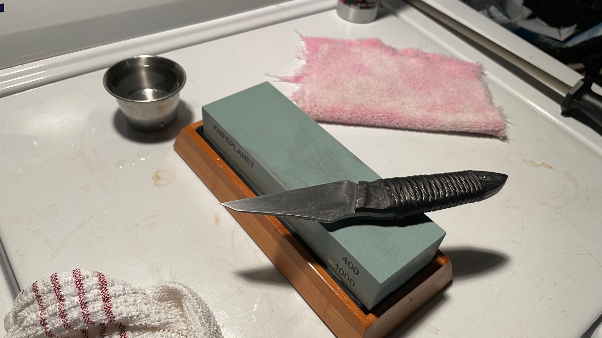

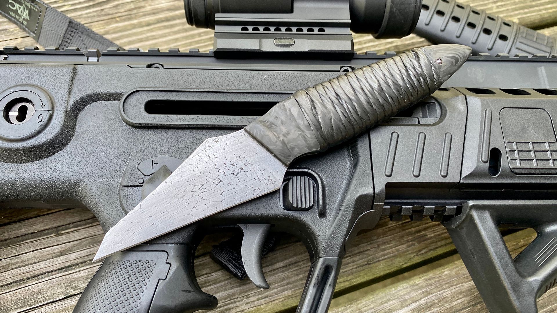

I got inspired by this thread and had a scrap of 3V steel the right size, so this is my humble addition.
3/16" thick with a high flat grind. Heat treat by Peters' to 60 HRC.
The scales are lightning strike CF.
Final bevel at 18 degrees, 1500 grit on a WE.
(very sharp)
I expect to have a kydex sheath made and try Joe's velcro carry.
