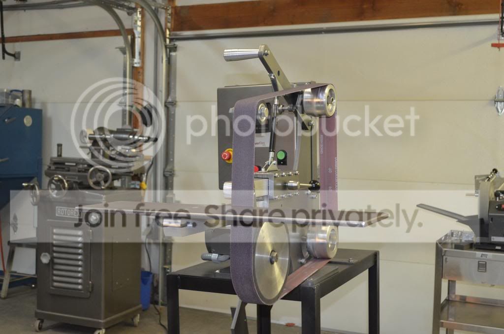

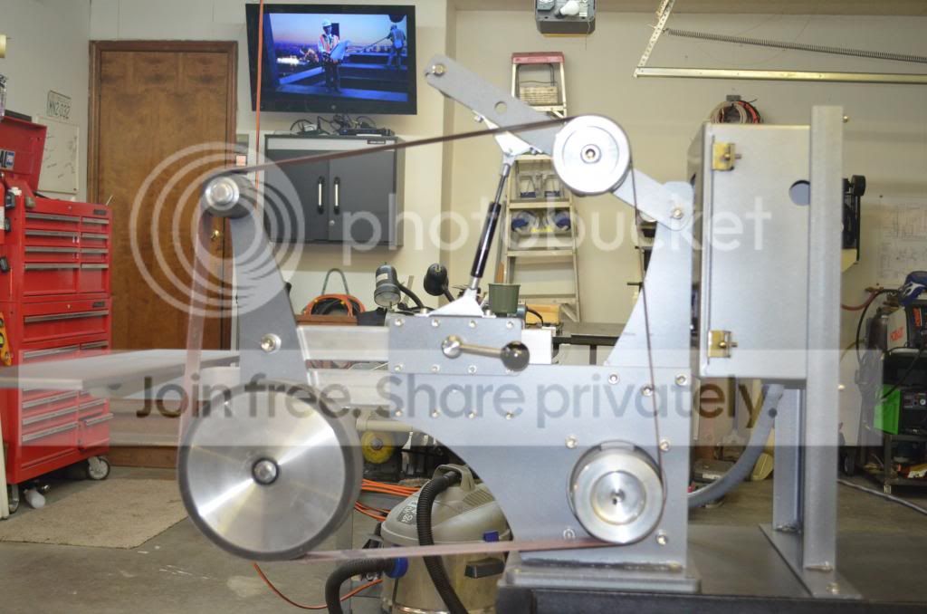

I can’t tell for sure from your pictures but this might work for you. First, my standard platen will adjust back and forth. I use this most of the time when I need an angle and the tool rest stays at 90. (second picture) I didn’t have the wheels for it at the time. I wasn’t sure that would cover everything so I made a second rest that is fully adjustable. (also in the second picture laying on the shelf) The second (adjustable) rest will work on the tool arm for the “fixed” rest. It simply works off the pinch method I don’t have a good picture of it but if you look below the rest in the first picture you can see a hole was drilled and slotted so it could be pinched by a screw and hold a bar. It works great when you need a bit more adjustment.
I wish I could give credit to the guys I got the ideas from but they all came from random searches.
Theiskell - Ok. First, that is not a work shop you have there..... that's a surgical ward. At least throw some old tools and some swarf on the floor even if just for effect. :D
That's a fine piece of machinery you have there. And, a very cool concept.

Thank you.

LOL I get that a lot when I post pics of tools in the garage. If there is one thing I hate, it’s walking on metal chips and grinder dust. A shop vac and a leaf blower are my best friends. I guess I chosen the wrong hobby to get into.
I also catch a lot of crap for the TV
Nice looking grinder build Theiskell.
Unfortunately, the grinder Peter has doesn't have a tooling arm slot (not even one) like the GIB/EERF grinder does. It simply has a shallow depression along one side that the stock tool rest rides on with one retaining screw. The flat platen itself is mounted via a shaft to the grinder body itself, so it's a bit more complicated that just making up a standard arm like you can use on the GIBs/Wilmonts that have 1.5" extra tooling slots.
