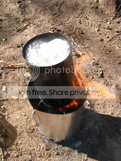

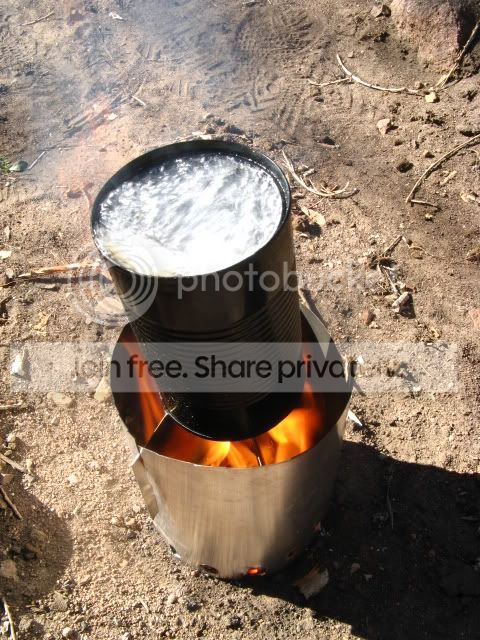

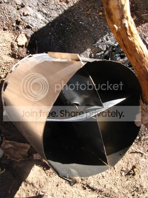

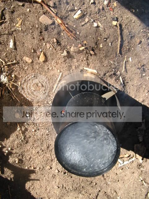

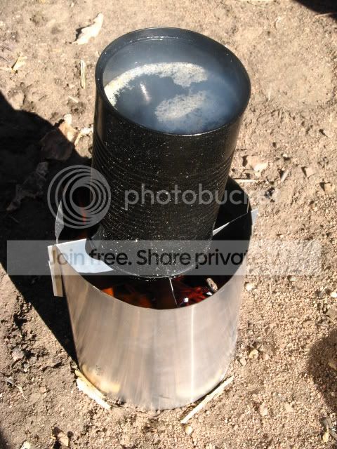

Just made up my own in about half an hour with some aluminum sheeting I had.
I made a smaller version similar to the junior. 6" tall 5 1/2" diameter.
It boiled water in about 6 minutes. It is VERY windy here today but it did well as long as I kept feeding it with fuel. At first I tried a large pot but it blocked off all air circulation and the flame went out. I'm sure with a plan and more time you could make a more solid stove.
The aluminum was a little thin. My pot supports melted!

Seems like it would be a PITA to pack and carry those cans? Bruche you the man! Use a couple of ss bike spokes in the heavier guage like I did and your pot supports won't melt.
Haven't done it personally, but coat-hanger wire comes to mind as well.
That's a great idea. Would save more weight and you could have multiple holes for different heights. The sides didn't seem to get super hot.
