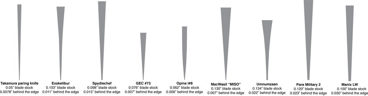

Which one would you consider thin?
I prefer knives with a thin edge and either a thin-stock blade or a wide blade to compensate for the thickness (alternatively hollow grind).
Really not a fan of hollow grind for cutting anything as tall or taller than the blade. FFG or Convex do so much better for slicing food or cardboard (for example) where the hollow wedges up. As such I don't buy the 'hollow is the best of both worlds' argument. I have a feeling that it's the worst of all worlds. Not strong enough for hard outdoors work and wedges up slicing anything thick. I think I'd be happy putting up a well made FFG/Convex fixie against a good hollow grind blade of the same thickness either in the kitchen or processing wood outdoors. I believe I know which would involve less effort in general and be safer to work with.
The following is just my own extremely cynical musing but I've often wondered whether the current popularity of hollow grind is just a way to make overly massive and overly thick tacti-cool blades actually be able to cut anything. :D (ducks for cover)
The Pm2's I have are listed as .14" thick, though I haven't checked my caliper. Which model is .12"? Or does blade stock mean something different?
