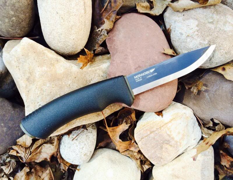

I wanted to know if anyone else has experienced this. I've noticed on the HDs and Bushcraft Black I've owned they have a micro bevel. For me, a micro bevel on a supposedly flat scandi grind is not acceptable so I always just take it to the stone, zero it out, and then maintain from there.
Have you noticed the same thing?
here's a pic of my bushcraft black, just because who doesn't like pictures to liven the thread up:

Makes sense. I should clarify that my knives from Mora were never "dull". They were definitely working order sharp, I just like my knives very sharp....especially if you claim to have a flat scandi grind.
Grease,
I noticed that there is a slight hollow grind on them. hhmoore eluded to that as well when he stated the sharpie method he used to check the contact surfaces on a his stone. When working on the bushcraft black I could see that there is a slight hollow grind. In fact, there are still very faint grind marks in the middle of the actual grind in a couple of spots on my bushcraft black. I don't mind them, I just wanted the edge to be zero'd by my stone. I wasn't trying to make the grind flawless. With a little more time I'm sure I could.
