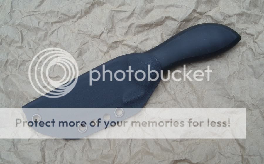

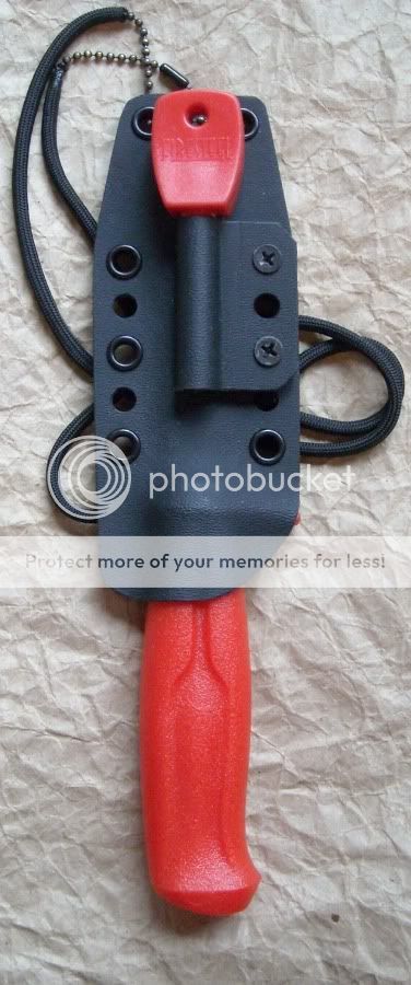

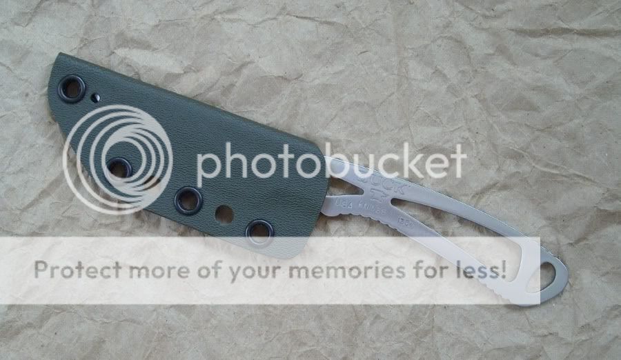

There are multiple factors...
The weight of the knife is a factor. If lightweight, .060 works just fine. I have made probably made over 100 sheaths for Mora knives, and .060 is more than sufficient for the task. Or, I recently built a sheath for a Spyderco Moran, and since it is so light, same story...
Alternately, if the knife has a shape that is less 'kydex-friendly', then a thicker material can be employed, because it will apply more pressure to the shapes/topography where the retention is taking place. Thin skeleton knives are a good example of this...
Sometimes color is a factor, if a customer wants Coyote Brown for instance, it is only available in .093, in which case, if it is a neck knife, you make allowances, and it will sheath a neck knife, just fine.
Then again, some folks like a heavy/solid sheath. Others like a thin/lightweight sheath.
Kydex is susceptible to the cold, and will crack when it gets really cold.
1/8th inch, usually described as .125, is usually used for structural elements, like droppers, belt loops, yokes, things like that. I have not run into a sheathing problem that I felt needed .125, though I have used it for droppers...
Hope that helps.

Thanks a lot and nice work on the sheaths in the pics... I can see your obviously experienced, so i will ask another Question while i'm here. How do you determine the space between gromet holes in order to get good retention, but not to much retention?
Thank you for your kind words!
And the answer to your question is... there is no one answer. The higher the retention inherent in the sheath, the farther away the rivet should be. The lower the retention inherent in the sheath, the closer the rivets should be... It really is alot of trial and error, and there is no universal answer that I have found.
One trick is to copy what someone else has done, right down to rivet placement. That usually yields a decent product. In the beginning, I did that a couple times.
