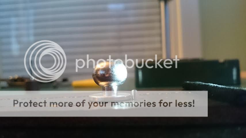

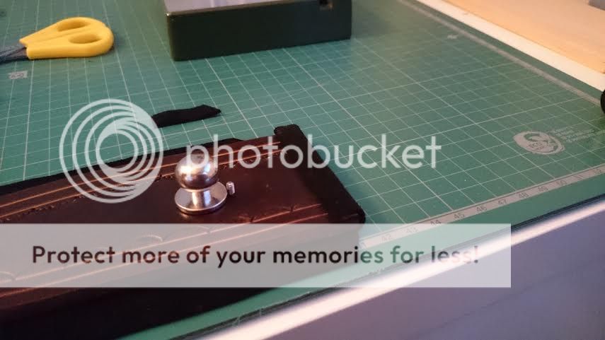

It looks a lot like some of the newer sheath studs they are carrying at The Leather Factory. They have at least a half dozen different sizes now, its real nice. May not be at all stores though.

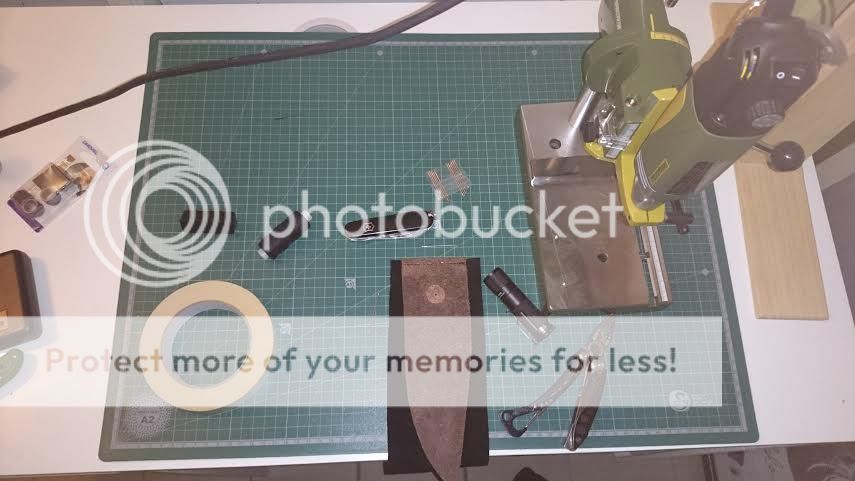

Could you also describe your drill/dremel set up in detail?

The stud was bought from Tandy Leather Factory. I wanted a big one, because I want to be able to stick the sheath in the belt with small risk of it sliding through.I, too, am curios about the dremel/rotary tool set-up. Also, where did you source the stud? That's a bit larger than I'm used to seeing, but then I've seen them made by the knifemaker, as well as folks using miniature (doll house or the like) drawer knobs.

I'm sure the Dremel works fine. The Proxxon is great too though and not that much more expensive, so I went with it.My little Dremel press served me very well for several years and was retired only because I bought myself a large benchtop press. Not rickety by any means, action is smooth, and my stitching holes were straight.![]()
It's great for stitching holes. I'm also planning to use it for shaping the cocobolo for the handle of this knife. Other than that, I'm sure you can use it for many things. It seems that it's compatible with most of the Dremel bits also, so the selection of tools is pretty vast.Good lookin' sheat it will be. If I understood corectly you use proxxon for making stitching holes only, or for some other purpose?
You did mention hearing that the Dremel press was plastic and flimsy and I dont want anyone looking at one to think that it was indeed that. Simply correcting bad info. No worries at all.I'm sure the Dremel works fine. The Proxxon is great too though and not that much more expensive, so I went with it.
There are a few custom makers but the cost is rather prohibitive. Most of the leather craft providers have a good selection. Tandy has a few different sizes now as well. As Paul mentioned somewhere, the rivet back is far more secure than the screw back. You can also set that rivet back deeper in the leather using that nifty little anvil.Does someone knows how to make studs?
Thanks for info but I cannot order from the tandy now,(different reasons...).I have here some nickel like screwback but never saw here brass with rivet back.I will probably try to make from the brass rods.There are a few custom makers but the cost is rather prohibitive. Most of the leather craft providers have a good selection. Tandy has a few different sizes now as well. As Paul mentioned somewhere, the rivet back is far more secure than the screw back. You can also set that rivet back deeper in the leather using that nifty little anvil.
Yes, just some silly rumor I heard from random youtubers.You did mention hearing that the Dremel press was plastic and flimsy and I dont want anyone looking at one to think that it was indeed that. Simply correcting bad info. No worries at all.![]()
