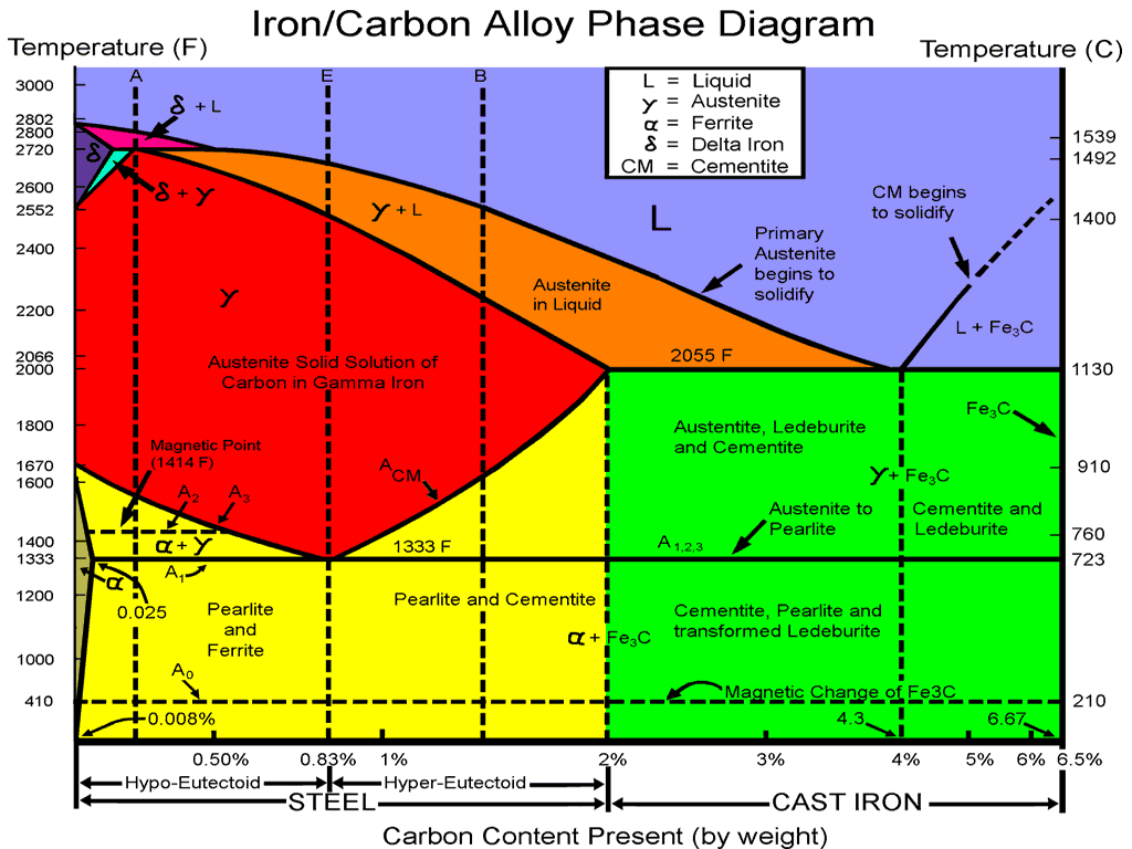

Question, and I apologize if I missed this being answered elsewhere: What temperature should I be pre-heating the oil (AAA) to for quenching this stuff? Googling, I see numbers all over the place from room temperature to 140F :confused:
Just picked some up as well. For those wondering, it ends up around $5 for a 2" wide bar in the thin stuff (0.065), $10 for 2" wide of the thicker stuff (0.130). Can't beat that.
Also, after being... scolded by Aldo for not using a real quench oil, I went and ordered 5 gallons of Parks AAA and #50. My wallet is feeling pretty light right about now.
What ever suits you. Just know the less viscous and warmer the oil (to a point), the faster it will pull the heat from the blade. You'll have to confer with TTT chart and see where the pearlite nose is and cross reference that with the phase diagram and the steel's carbon content. I'm using the McMaster 11 sec/"high speed" oil at room temp, straight into the 5 gallon bucket with mild agitation and I can consistently get 61-64 RC from 52100 and 15n20.
here are some generic charts.
