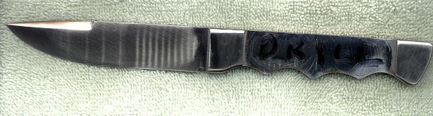

<font face="Verdana, Arial" size="2">Originally posted by matthew rapaport:
My first true custom is on its way. Its an integral from George Tichbourne. He has been kind enough to provide a picture which I have put up here: http://www.sonic.net/~quine/gifs/tichbourne4.jpg
It is a "true custom" in that it is one of a kind. The blade shape emerged out of my own idea of the ideal utility blade shape and size, in this case 4". George added the false back edge himself, I'll admit it does look really slick, though I think its effect on the knife's utility is somewhat mixed. The handle is one of George's from another knife.
What you can not see in the picture is that the spine is only 3/32" thick. I have a number of expensive and inexpensive utility knives in the 3" to 5" blade length range. With one exception, they are 1/8" thick at the spine. Most of the custom knife makers with whom I am familiar choose this width in a "small blade". Busse is an exception in going even thicker, but the only exception I have going thinner is a 5" long Mora2000 Survival knife ($26) that is only 1/16" thick!
The funny thing is that this little inexpensive knife (I could buy 5 of them for the cost of my next most inexpensive utility fixed blade) cuts wickedly, is quick in the hand, and even at 5" the 1/16" steel is still tough enough to take some pounding through wood to split kindling, and even some hammering (on the pommel) to use the point to dig channels in split wood (as in hollowing out a log). No, the Mora does not hold an edge as long as a Dozier, but for $26 bucks what would I expect? The real lesson though is that a somewhat thinner steel is still quite strong!
George and I talked about this for a while on the phone and by email. Since this was going to be a user at least sometimes, we agreed that 3/32" might be the best experimental compromise for his characteristic flat grind to the spine - just the way I like them.
I am very much looking forward to getting this knife and trying it out around the farm here for as long as I can. No, I won't see if it can dig rocks out of the ground, but it sure will be used to cut a lot of canvas, rope, hose, thin plastic, cardboard, prepare food, clean meat, debone chickens, filet fish, etc. If it performs to my expectations, I may have to revisit other elements of my collection and see if I can thin it out!

Great looking knife, what is the alloy is the blade?
George told me what he used, but I can't remember at the moment. Was a common higher end stainless if I remember, like 440C or AUS8. I'm sorry I just can't recall at the moment. Perhaps George will chime in again and remind us...

Sorry guys, I shouldn't even try to answer anything before I have had my second coffee, the finished blade is 3/32" not 3/16" and the tang is 1/8" to give some stiffness to the handle. The starting material is 1/4" 440C, a favourite of mine.
The idea of using a very thick blade on a dive knife is reasonable to give it enough mass to hack with underwater but on dry land unless you are making an ax the extra mass is just so much more to carry.
Distal taper where the blade thins towards the tip as well as from the cutting edge to the spine is desirable in some cases where the tip is used frequently to start a cut such as a hunter beginning to dress an animal or a chef who dices with the tip of his chef's knife. A big bowie which is used to chop with or in the hands of a youngster who likes to stick it into trees and such should have minimal distal taper as it weakens the tip. In fact when I make bowies for buckskinners who are into throwing axes, hawks and knives I make sure that the tip is very meaty.
