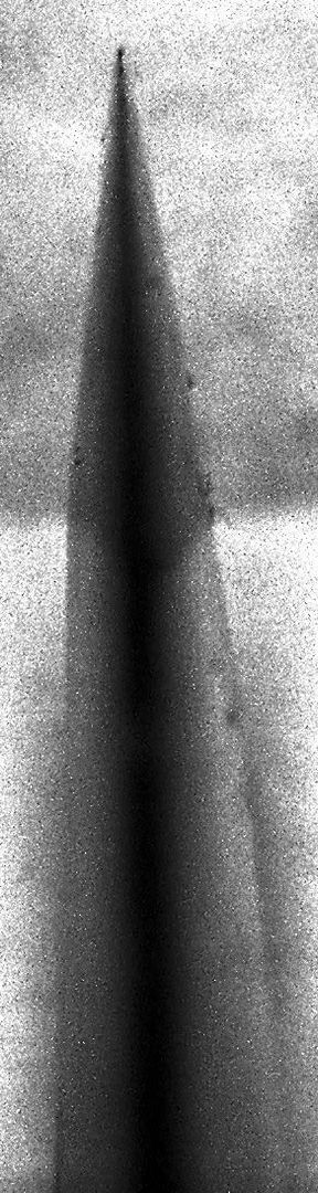

Personally, I would leave well enough alone. If the khurkuri arrived with a thick edge, then it's intended to have a thick edge, for heavy duty chopping. I.e., if you buy a station wagon, it will always be a station wagon, even if you put a sports car engine in it! On the other hand, if you look at them in profile, HI blades tend to have scarily acute edges, sort of like a Finnish puuko. Here's a digitally enhanced photo of the edge angle on my Giant Chitlangi Bowie (24" long, 59 ounces!):

I would guess that blade came with a fairly thin edge but maybe not.
Probably best to thin it only a little before using it. Then see how it holds up.
Personally, I think you should sharpen it first. They don't always come all that sharp.
Ryan is right that the final angle is very acute. When I sharpened my 20" CAK, keeping the original angle, it will even slice thin grass with ease. Depends on what you want to do, really. Since yours is a knife, you can probably get it very thin if you aren't going to chop with it. Otherwise, try sharpening it, keeping the geometry it has now.
