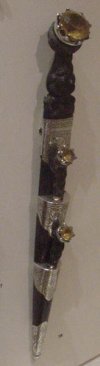

I just got a fat GW and an AD so thats a bit of both. All I need to do is attach them to my FFBM sheath and i'm good to go for nearly any task I tackle. Like the pic (only not so fancy :D).
If however I had to choose I would go fat, just means a little bit more work convexing and polishing to try and get the slicing factor up.
