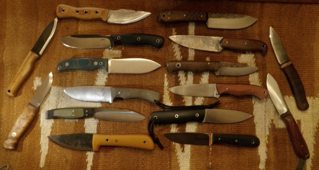

Many different knife styles will work doing Bushcraft related chores.
A review of the knives in the Bushcraft Challange will show the variety of features our knifemaker's think are important.
Testing these knives has shown me how well the majority work,
...changing my views of what's required in a Bushcraft Knife. :eek:
Stay tuned for the results of the Challange. :thumbup: :cool: :thumbup:
