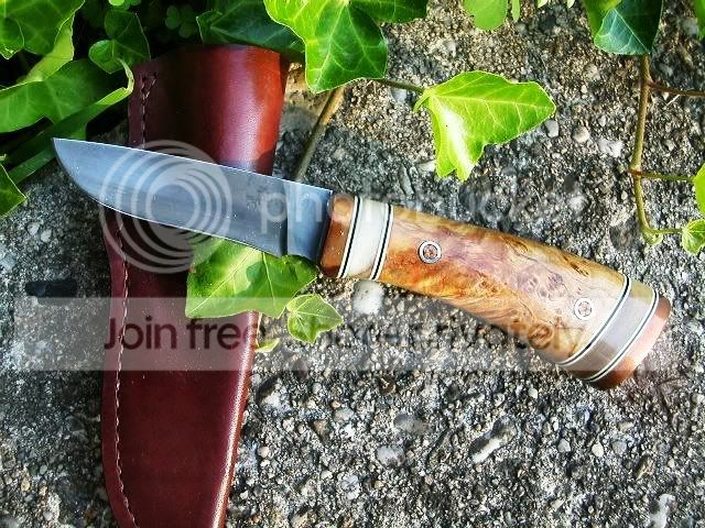

Ron Leuschen used copper front and back on this knife, even in his homemade mosaic pins...
Ariel made some coppered damascus bolsters for this one...

I use them on my guards as well....this is my current style of horseshoe rasp knife and I can't make enough of them right now...as soon as I complete one, its out the door. Most folks are liking a satin finish from 0000 steel wool over the high polish finish.
Copper is a bitch to work with though, gummy when machining and it sure gets hot quick (duh!).
It takes a nice hammered finish. Use a highly polished small ball peen hammer. Anneal frequently.
