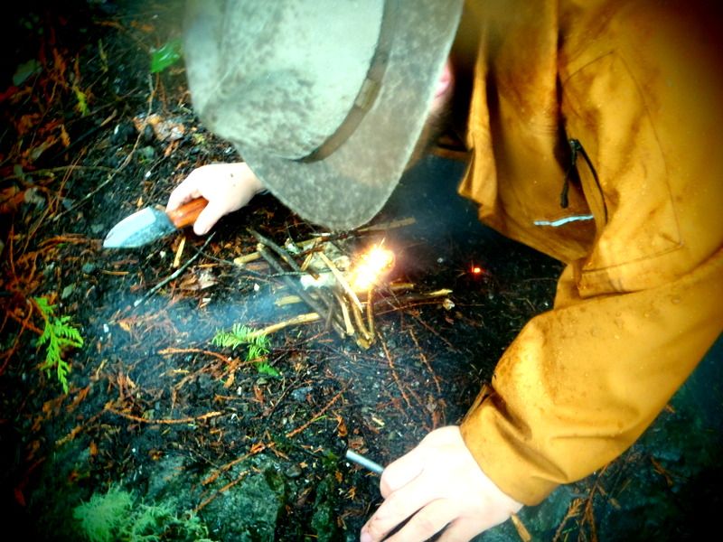

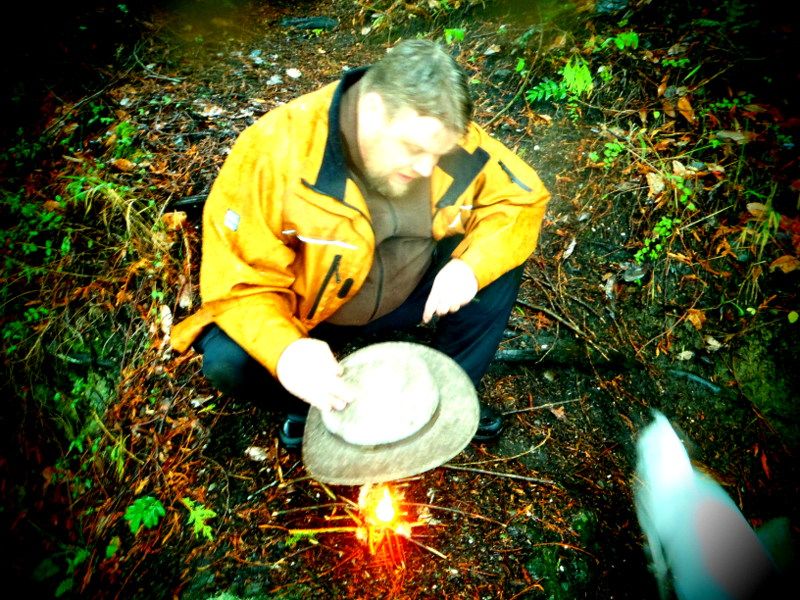

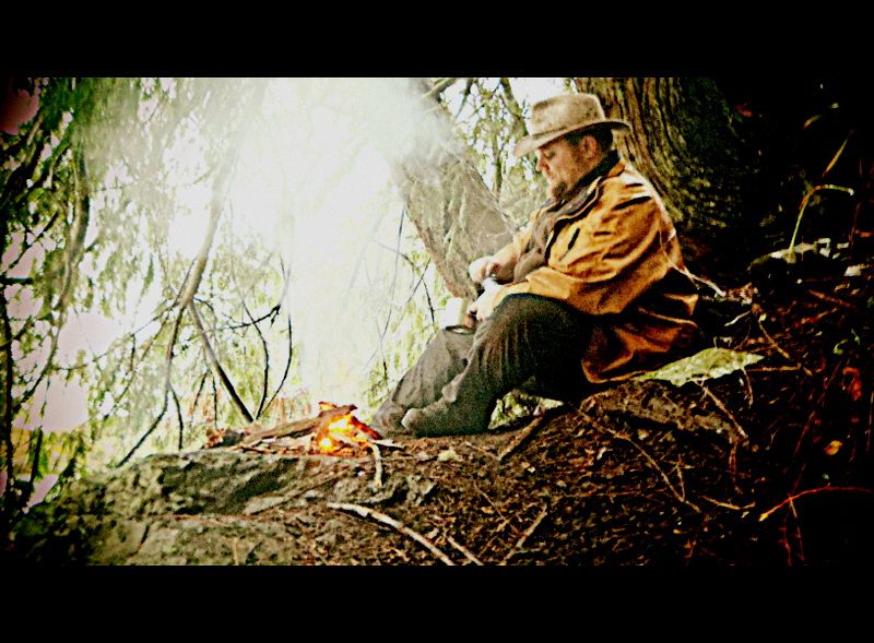

I told ST he was up first, we began with the ferro-rod and all seemed well at first.
Now we hadn't picked the ideal location as we wanted to make the fire near the water, the only place that wasn't submerged was a rocky outcrop partly covered by some trees. Everytime the fire started to take some water would drop down and put it out, ST tried using his hat to protect it.
Now this fire must have gone out maybe half a dozen times. The ferro-rods sucked under such heavy rain, we tried ranger bands and they caught but soon went out, we tried PJB's and they too went out !!!
About to give up I went in search of some fatwood for one last try, we were also now relying on a Bic lighter to start the fire.

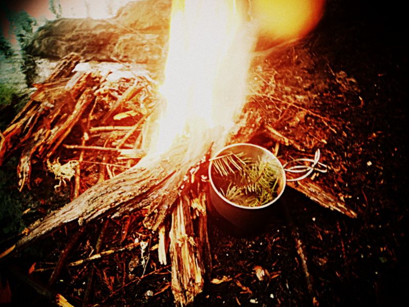

Finally we had success, the fatwood took and we soon had a nice little fire. ST was amazed at how stuff that he thought would guarantee fire had failed so miserably !
We threw some pine needles into the water and made a cup of hot tea !

so was it the ferro rods that sucked or not having fatwood to use with the ferro rod?
this has been a rainy one here in the PNW rain forest. we have had over 2 inches of rain today and are supposed to get another 3 by morning.
I guess the ferro-rods buddy, we tried natural tinder mixed with resin first and the ferro-rods took so long that the tinder just wetted out !

As explained in this thread the issue was not the rod. The ferro rod did as it should have, it started the fire for you. The failure came from prep and material selection, which you learned quickly and went to look for fatwood. You could have started that same fire using your rod. You could also have carried waxed cotton which will burn for 20 minutes and dry your shavings and thinner than pencle material. The bottom line is this shows how important it is to go out and pratice so you know when to look for fatwood, split wood, and doing the prep proper. You may only get one shot at a fire when you need it most. Take you BIC if you must, but also have three or four other methods available. In this case carrying dry tender out have helps too, be it fatwood, shavings, or whatever. The ferro started the fire just fine, it was what happened before and after that caused the issue.
