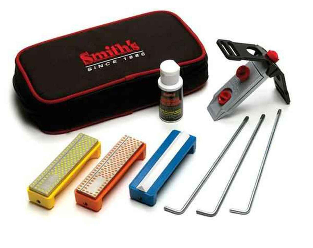

I've been fine freehand sharpening my traditional knives, but I found this Smith's system on clearance at the local hardware recently.
It has opened my eyes to the advantages of a guided system, but now I'd like something that's not so terrible.
To be able to correct the often uneven edge on Case knives or vintage Ebay finds would be great.
I don't know much about guided sharpening systems, but I have a few simple criteria that I hope can be met.
Under $100
Works with small slipjoint blades
Manual operation
User adjustable, no preset angles.
I would greatly appreciate any recommendations.
I looked on their website and all I'm seeing are models with a selection of preset angles to choose from.
I'm looking for something adjustable.
I don't wanna be taking off tons of steel when I get an uneven hand ground edge that doesn't match any of the preset angles on my sharpener.
