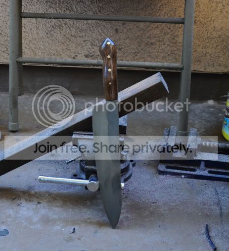

I would be sending it off for heat treating. I guess I'll pass on the sabre grind and use a convex grind. It'll look a lot better on a kitchen knife too. Spareparts, would you mind posting a couple of pics of the knife you decided worked best for you?
Normally I don't post my pics here because I feel sooooo outclassed by the pros, especially when my hamon failed. But the knife works great and was alot of fun to make.
The picture isn't the greatest but you'll notice that I gave it a continuous curve that almost doubles back on itself near the handle. For me, this feature is great when rocking the knife as I cut and mince.
