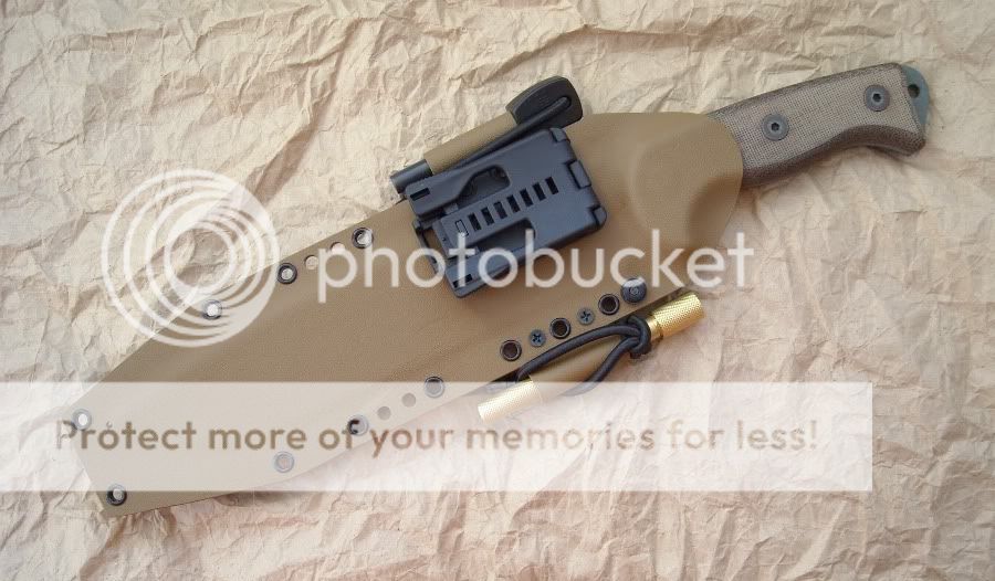

So how did you do this one?
Does the handle not get stuck?

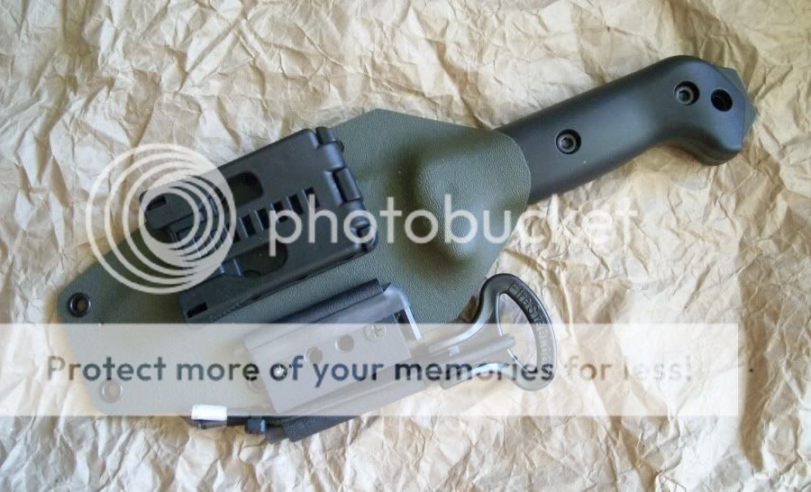

And this one for the BK2 does it not get stuck in the handle screws?
Erdbeereis

And this one for the BK2 does it not get stuck in the handle screws? http://i496.photobucket.com/albums/rr327/mdpoff/sheath-2p-bk2-od-plus.jpg

Kydex is very flexible. The retention on those two sheaths is set by the spacing of the eyelets from the handle, so nothing is getting stuck.
