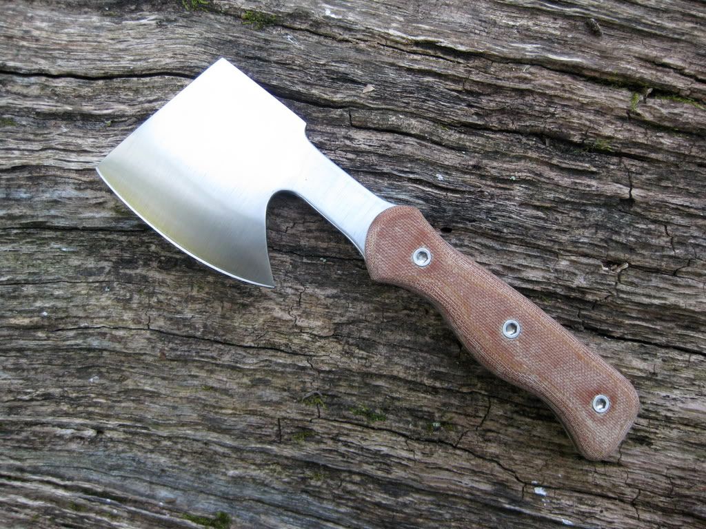

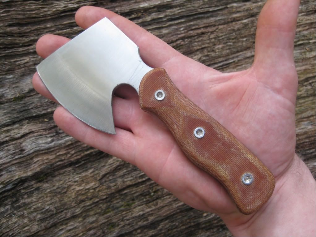

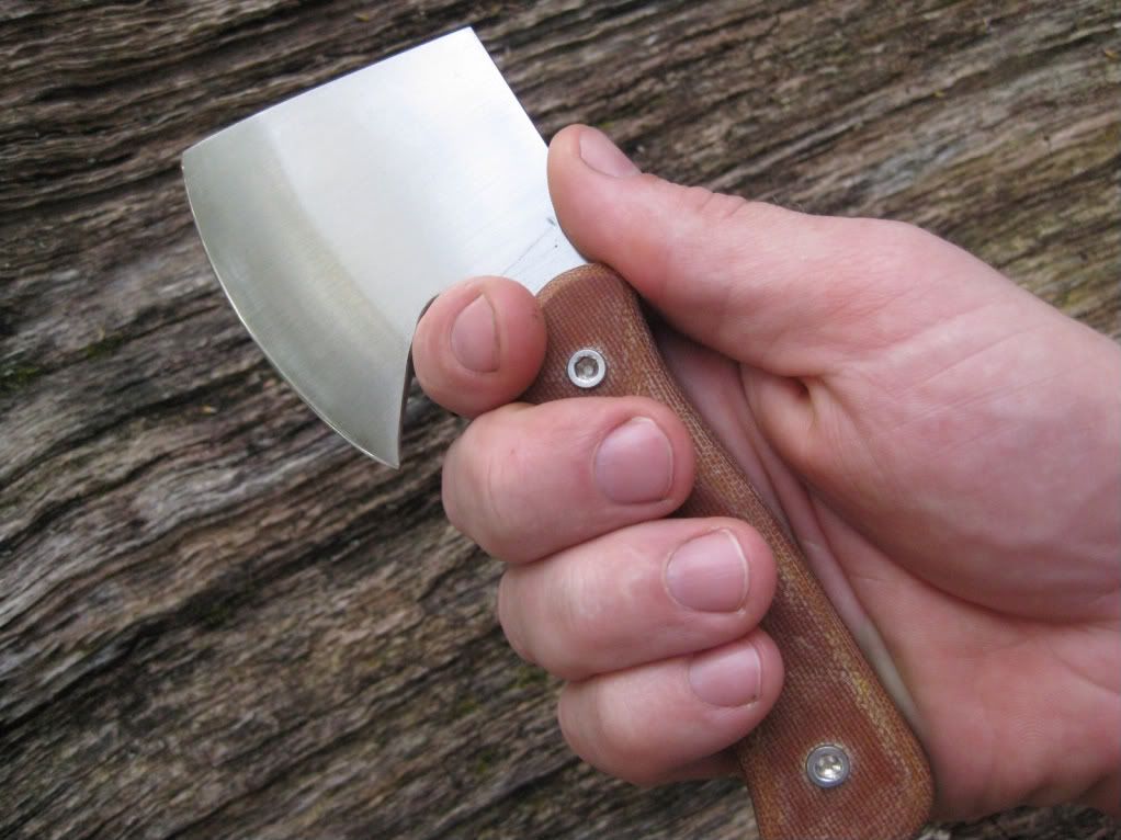

I'm new to this forum, but here are a couple that I have made:
3/16" thk A2 tool steel, 2-1/2 in wide.
This one is the same dimensions except for the longer neck:

Blade User-good looking little choppers, they remind me of the busse paul's hatchet blade, pretty cool.

more info on the make please.....I have been looking for one that small for a while now...the short one....
stephen, good looking little hawk, like all your stuff, but i am thinking of a wider bit (like the beard on the bottom, but on both sides) and even a lighter weight head...
my main goal with that design would be a very light little chopper that would feel weightless on the belt or in a bag, but would pack alot of punch when swung. i would want the wide bit to maximize possibly chip size with fewer strikes, but i would also want a pretty good curve to it, to give a fair amount of penetration into the wood due to the small contact area. i suppose if i get a forge running i could try my hand at this sort of thing, hopefully someday soon...

I made these for my own amusement. They are ground from 3/16" A2 tool steel. The small one is 2-1/2" x 7" with a 3" cutting edge. They have been tempered at 400degF for an approximate edge hardness of 60Rc. The small one is realy more of a slicer/ulu type than a chopper as the short neck really limits the chopping action.
