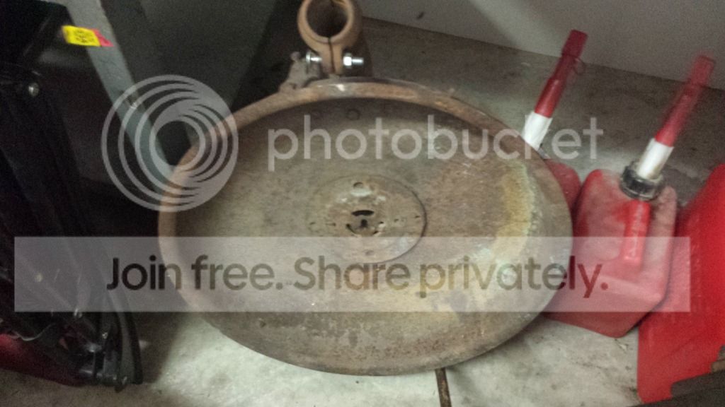

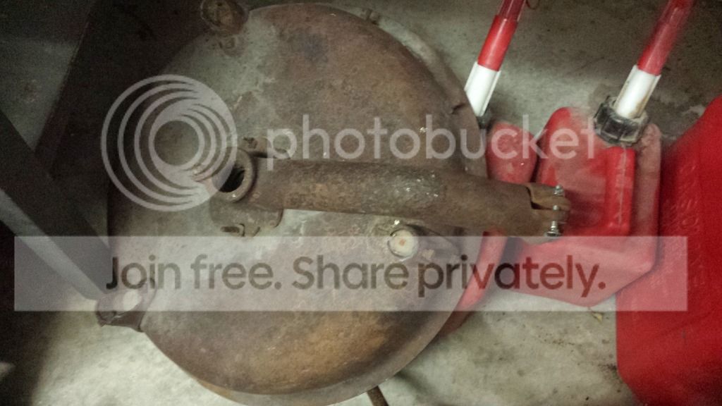

Hey Nathan, where do you live? If you're interested in paying fright, I'll send you an old coal forge I have, it's just the fire pan, but it's yours if you want it.
Oh never mind, I just checked your location. Fright from Texas to England might be a bit cost prohibitive!
Anybody else want it?
