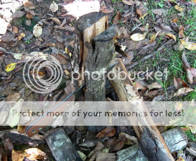

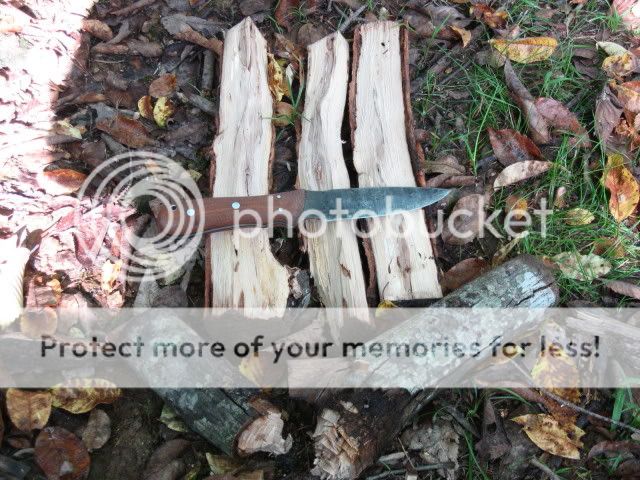

Koyote Leuku Passaround thread. Four inch knife, 0.095" thick of 15N20. Lets just put this to rest. Posts #46, 138, 147, 165, 181, 244, 251 - all different users, all different woods - same knife - batoning.
Here is the link:
http://www.bladeforums.com/forums/showthread.php?t=611325&highlight=leuku+passaround
If batoning were so damn hard on so-called thin knives than this one should have broke. Right?
