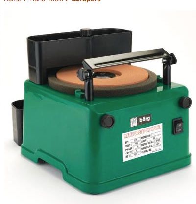

Alright, I want to get one of these for thinning behind the edge, I know I know, im going to practice alot with 50+ OLD pocket knives my grandpa left me and some cheapos before I run any of my spyderco's. Anyway it has the option of a 1000 grit and 400 grit ..
1/6 hp @ 420 RMP so once i get to my harder steels, ZDP, M4, S110v, Any advice on which grit wheel to get or both??
I WILL NOT BE SHARPENING WITH THESE Edge pro w congress for that. Just thinning here
Thanks, Drew

I'd consider a belt grinder, you might find it slow going on that wheel unless you're only using for changing angles. For really thinning out the primary grind I don't believe that will work as well as other options.

So my 2 concerns about that were overheating the blade which I don't know hot that is? Just keep dipping it in ice water ? And price of you off the top of your head knew of any or would think a <$170 belt grinder would work is be all for that.

I have reprofiled quite a few knives with my 1x32 Harbor Freight belt sander. As long as you don't touch the very edge/apex and keep the blade cool enough to be able to touch it you will be fine. The thicker and larger the knife the better (heat sink). Certainly a slow speed belt grinder with cooling mist and cooled platen is best for this, no question.
I would agree you would be better off with a belt grinder. A Kalamzoo with a Mark Reich platen in the long run would be a better investment.

Ok I didn't know what a platen was, so I looked it up. So it's essentially a bar behind the belt that you can use as a flat edge? The ones I was looking at had platens, so I googled mark reich platen and didn't find anything. What are the advantages and do you know where I could find one online?

Close, but not quite. It's very possible to burn an edge and have the blade still cool to the touch. Fresh belts, rapid passes, and misting the blade with coolant all work to prevent burning. :thumbup:
