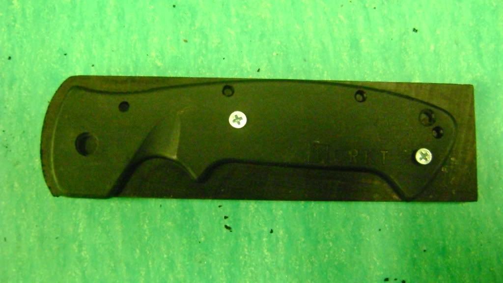

I'm making some scales out of Ebony (man this stuff is hard).I could only find it in 1/4 inch thickness so now I need a way to thin them out quit a bit. Any ideas..I'm thinking of screwing them to a large pice of plywood from underneath then using a belt sander. I don't know how this will turn out and would hate to ruin all this work. Also considering bringing them to a machine shop and having them milled down. This will insure they are perfectly flat but I was hoping to do everything my self..

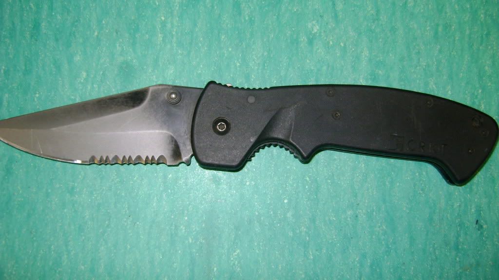

As you can see the stock is much thicker than the scales. the stock is 1/4 inch, the scales look to be less than 1/8..If I have to go thicker I will need to get longer screws which I could do. The original scales are Zytel which can be pretty thin as they are very hard..the ebony is pretty hard as well but I don't know if I can go down to the thickness of the original scales. I have a small table top belt/disc sander so I may try that but it will be a ton of work to get them down that far. I even used a grinder, the stuff grinds like steel leaving a super fine powder.

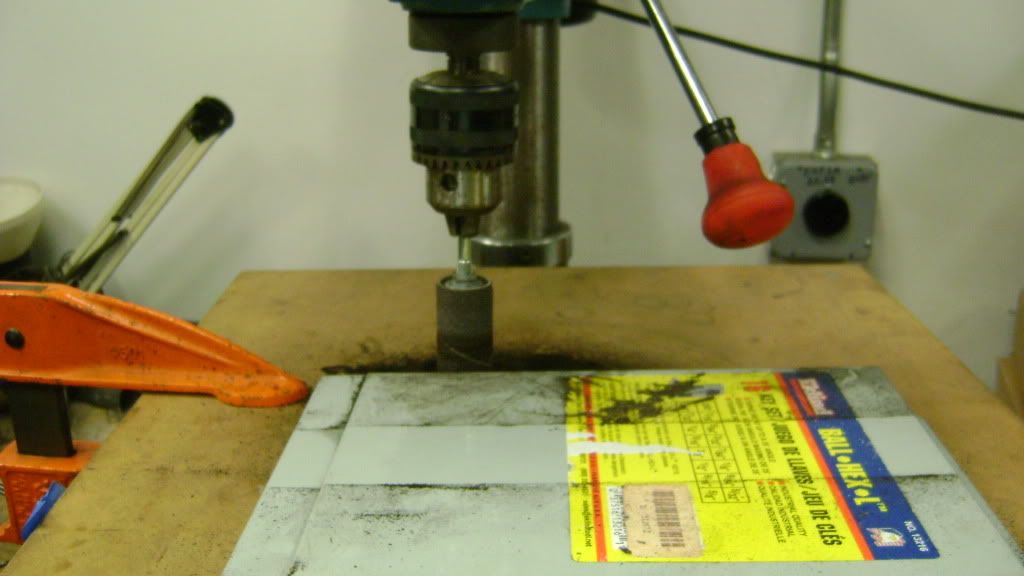

This is what I used, not the best but it works.

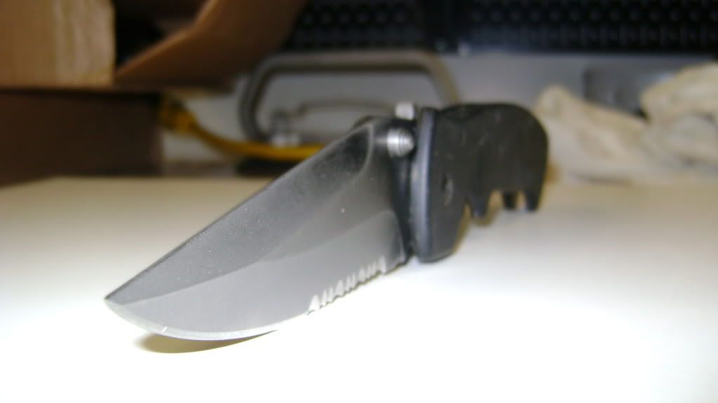

I ordered some screws from A knife making supply company..hope they fit as shippping doubled the price. I found the Fein tool we bought a while ago in the shop and used it to thin it out, worked great. The tool is one of the best things we have bought, damn thing can do anything. Going to start on the other scale today..and polish up the blade.
Wow, never thought this would this hard...another 6 hours and I just started on the second scale...polished up the blade, got rid of the scratched up black coating. More work next week...
