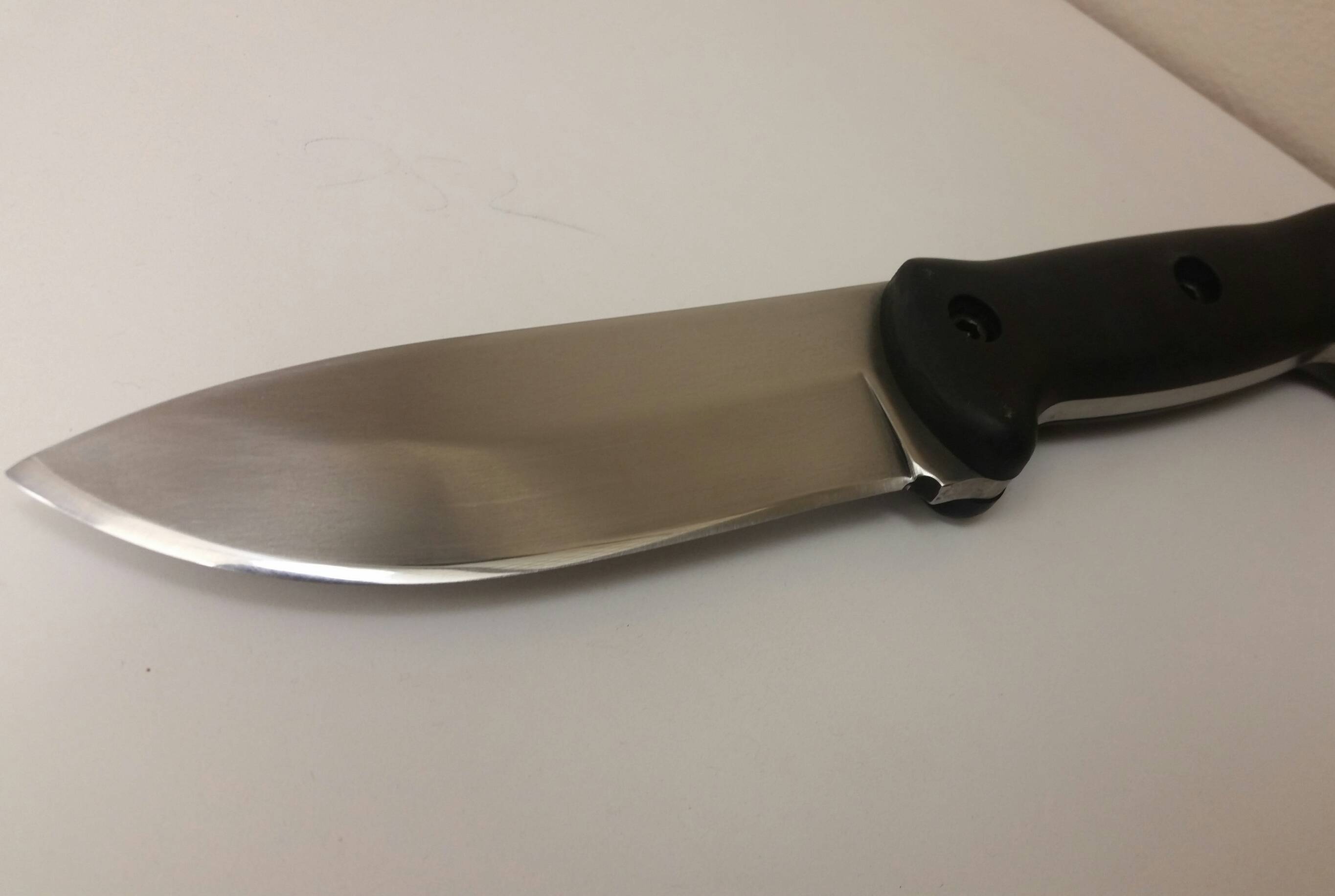

I've never stripped an essee but if it's like other knives I've stripped I had to start with 120-220 grit and spend hours with it removing all the pits, grind, and tooling marks. Then progressed up to 800 grit to get a similar finish to this..

I initially thought that I would only have to sand down the abrasive finish they put on the blade to help the epoxy stick. I realized I would have to work out the scratches from them grinding the blade after about 30 minutes with 400 grit sandpaper. I was able to get the abrasive finish off but the grind marks are still there. I found a place to purchase coarser grit sandpaper, so I will more than likely stop by and pick up something that will cut a bit quicker than 400 grit. Your Becker 2 came out rather well.
