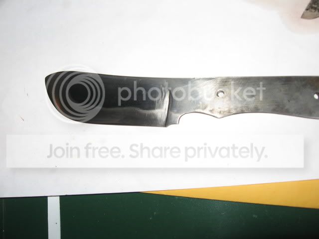

Hey guys, this one isn't finished yet but with Stacy's help this was my third attempt to get a visible hamon and a decent knife.
It's shown here at 400grit after a few minutes in some vinegar. It's 1080 forged and HT'd in 130 degree veggie oil.
As usual, I'm looking for opinions and what not so fire away.
I really liked the shape of the blade and the curves around handle around ricasso and plunge. Great job, functional and something in style :thumbup::thumbup:
To be honest, I'm not terribly happy with the plunge. It's my first attempt at it and it's not quite as clean as I was hoping for.

Kinda like a nessmuk or however you spell it. Nice hamon and Finnish? kinda being punny.

Wish my 3rd one looked that good. Keep er going.
