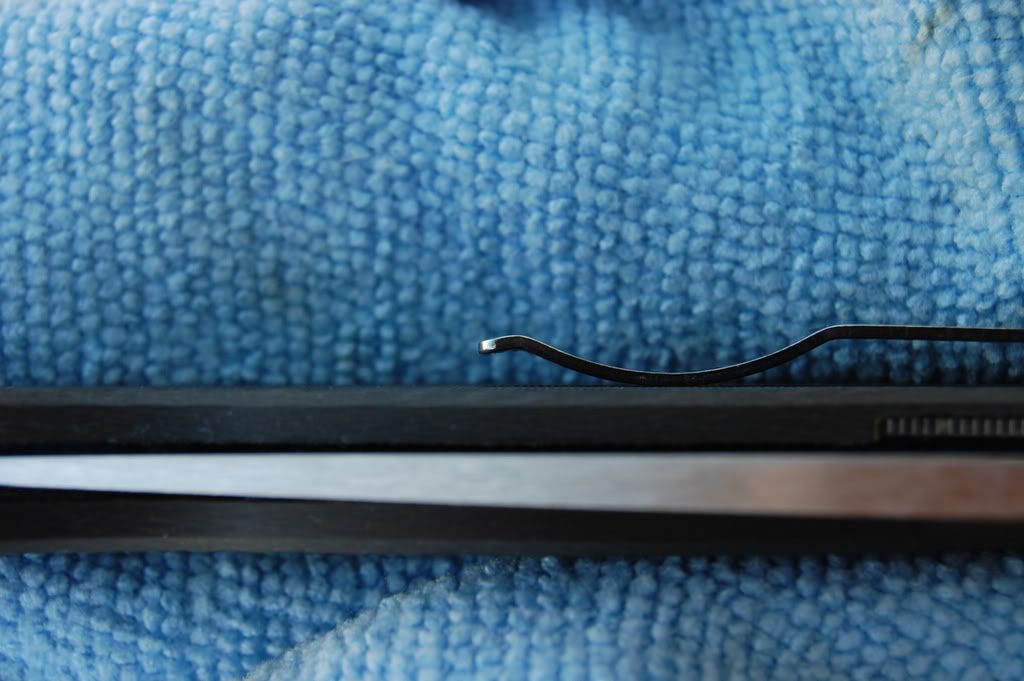

I have had similar problems with a couple of clips in the past that I solved by bending the very tip of the clip down.
This one is not as pronounced as some others, but it was handy. The trick is to get it close enough to the handle so it won't snag, but far enough out to hook the edge of your pocket when you want to clip it on. It can take some experimenting to get it just right.

Anyway, I don't have any pictures of the modifications but I took the clips off my native and salt and put the belt sander to them to round off the square corners on the very end of the clip. The end of the clip is now more of a round ball than a square. I think the square profile and sharp acute corners on the stock clip contribute to the snagging that happens. The end of the clip now looks more like the end of the clip on the knife in THG's post above (delica?). I then bent the clip down just like is shown in yablanowitz's post except with a little bit more of a severe inward angle.
