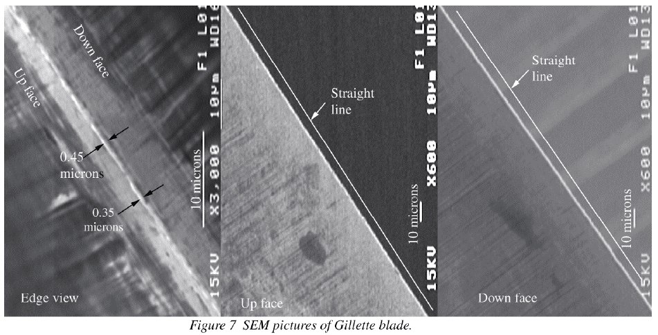

It looks like ASPEX is now offering free SEM imagery of whatever you send to them (limit of 2 samples). It might be really cool to see a very refined edge under a SEM.

If they are able to take SEM pictures looking directly into the edge (the same as Prof. John D. Verhoeven), then they may be able to measure the actual sharpness of your knife edge. That would be amazingly cool... With modern ultra-fine abrasives, do you think your edge is sharper than 0.4 microns? Now you can find out! :)

As for Verhoeven's electron microscope pictures: On page 5 of his tech report, Verhoeven says,"The majority of the experiments" in the report were sharpened to a included angle of 44 degrees. Most of us here use something around 30 degrees, but I don't think the 7 degrees per side affect his images too much. One incredible strong-point of the SEM is a fantastic depth-of-field, which is why most of his images can look directly into the knife edge. If you look at his pictures, even parts of the knife more than 10-20 microns are in focus; and this distance is in the plane of the photograph. If you do the trig for 22 degrees, then that represents a depth-of-field which is at least 24.8-49.5 microns, if not much larger.

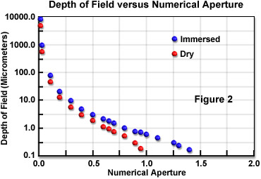

By contrast, for an optical telescope, the depth-of-field is a fraction of a micron; for an objective at 100x, it might be as small as 0.2 microns. See the column labeled "Depth of Field" in this table from Nikon (this is for the magnification of just the microscope objective):

Here's another chart for the depth-of-focus as a function of Numerical Aperature of the objective. For high magnification, the numerical aperature will approach 0.75 to 1.0 (or higher if you use immersion) for an optical telescope. At those ranges, the depth-of-field is around a micron or less. If the sharpness of the knife is already 0.4 microns, then your depth of focus is not much bigger than the roudness of the "ridge" you want to measure, which can make things difficult.

Verhoeven mentions on page 2, that "One of its [the SEM's] outstanding features is that the depth of field is much improved over the optical microscope, on the order of 300 times better. Hence, the SEM is capable of providing clear images of the edge of sharpened knives at magnifications up to 10,000x." (Brackets mine.) So SEM's have a huge advantage over optical microscopes in depth-of-field. This is why the SEM can look directly into the knife edge and give useful images.

P.S. If you unfamiliar with Verhoeven's electron microscope pictures, here is a random example of one. If you're confused, just note that there are three images. In the first image you are staring directly into the knife edge, which runs diagonally from top-left to bottom-right. This means both of the two bevels of the edge are visible and on the two sides of the edge. You can think of this as looking straight down on a mountain ridge. The next two images are from two the sides of the knife, so in each image you only see one bevel of the edge.
From these types of images (and others) Verhoeven was able to measure the sharpness of a modern razor blade at about 0.4 microns or so. Please note that this is a Gillette razor blade, so the included angle is relatively small (maybe 15-19 degrees inclusive), so within the plane of the image, the depth of focus appears to extend less than 10 microns to each side of the edge.
