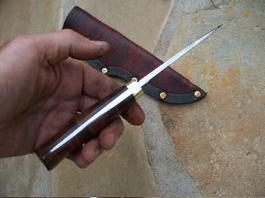

My first white tail hunt of the year is next week and I have been carrying the same ATS34 stock removal knife I made about 25 years ago. Love that knife but I have been doing some forging and wanted to field test some tool steel. I did a couple of things on this one just to try it out: the wood is cross grain and I did a mirror finish on the blade. I would not do either for a customer until I gave this one some hard use this fall.
5160 steel
Flat grind with a secondary edge
Cross grain desert ironwood handle. (I wouldn't try that with maple)
Overall length: 8 3/4 inches
Blade: 4 3/8 inches ( a little longer than I would want for white tails but maybe there is another elk hunt left in this old body)

I agree but I just like the warm feel and natural colors of wood. Can you tell I was a forestry major? :)

Would you explain the "secondary edge"? Thanks. :D
