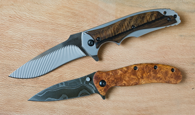

Stopped at my favorite wood shop today and found this 20x6x1.125" piece that somebody had marked "NFG"...
Looks pretty good to me!
I don't know the name for the iridescent white lines but I think they look pretty cool. They're skinnier and tighter on one side and it was harder to take a pic of the nice iridescence but I tried in the second pic.
Looks like quartersawn oak. The ray flakes are the tree's medullary rays that transmit sap radially through the tree. They show up when the wood is cut radially.
The ziricote on the upper knife shows a similar pattern of ray flakes (and so does the sycamore in the background). This effect is seen with many species of timber, but is unusually prominent on woods like oak.
