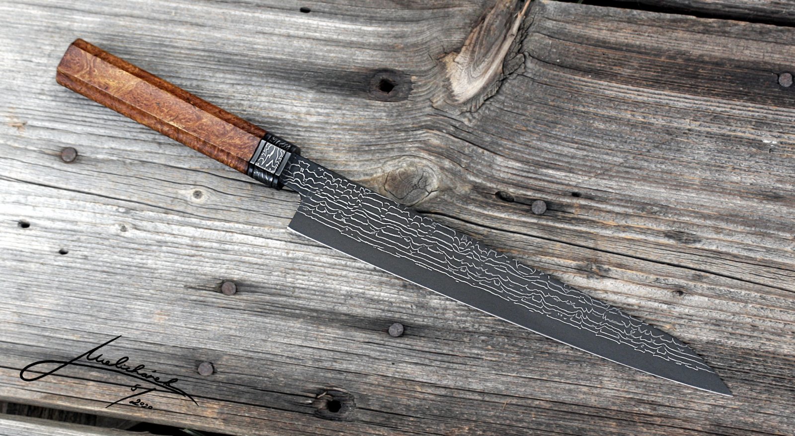

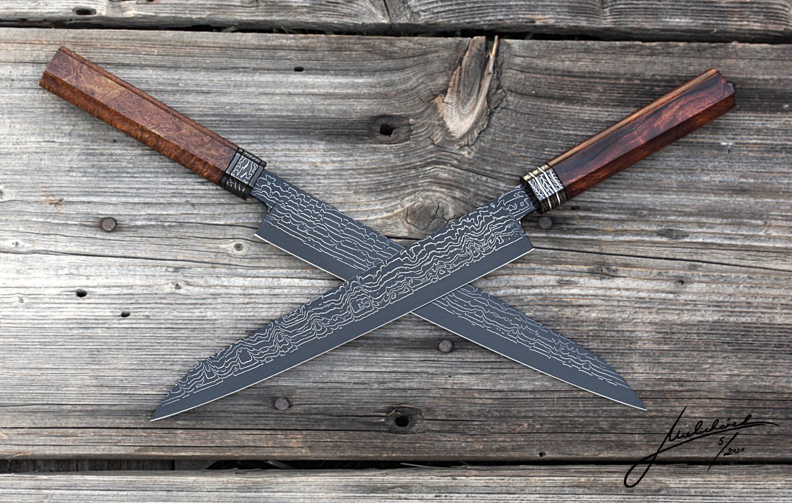

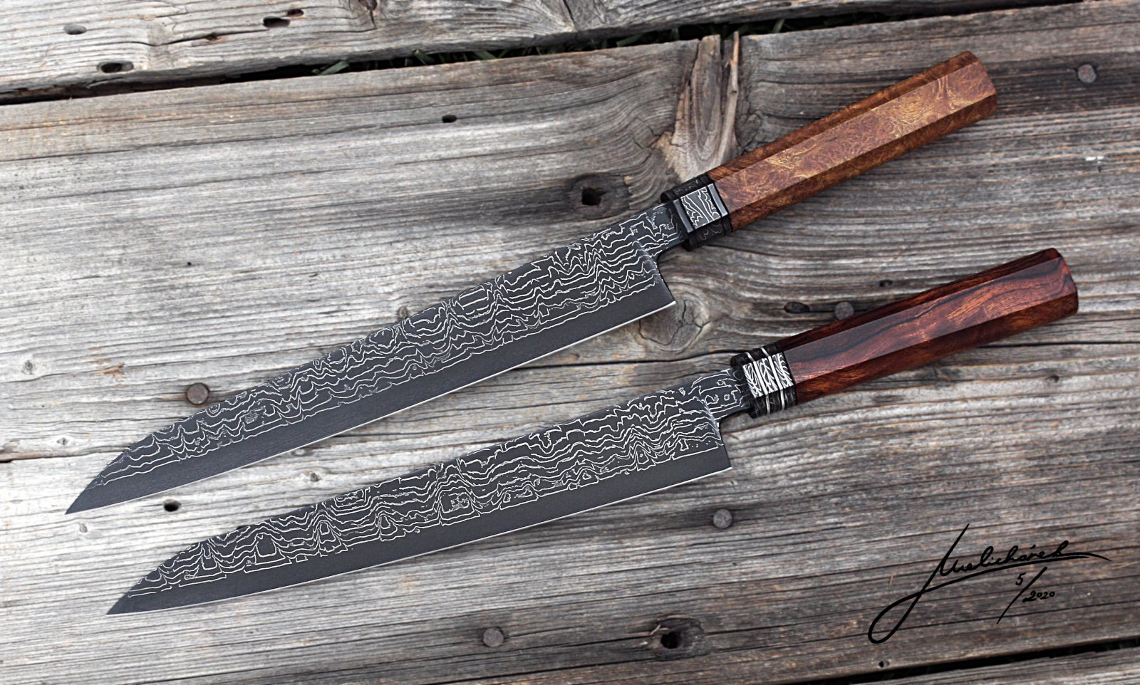

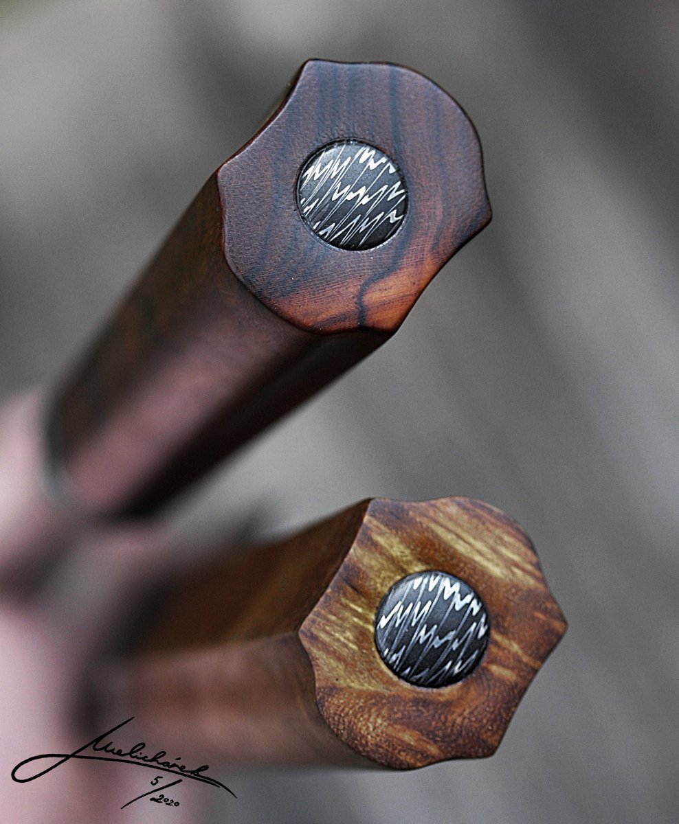

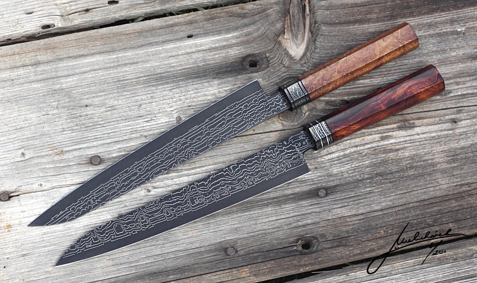

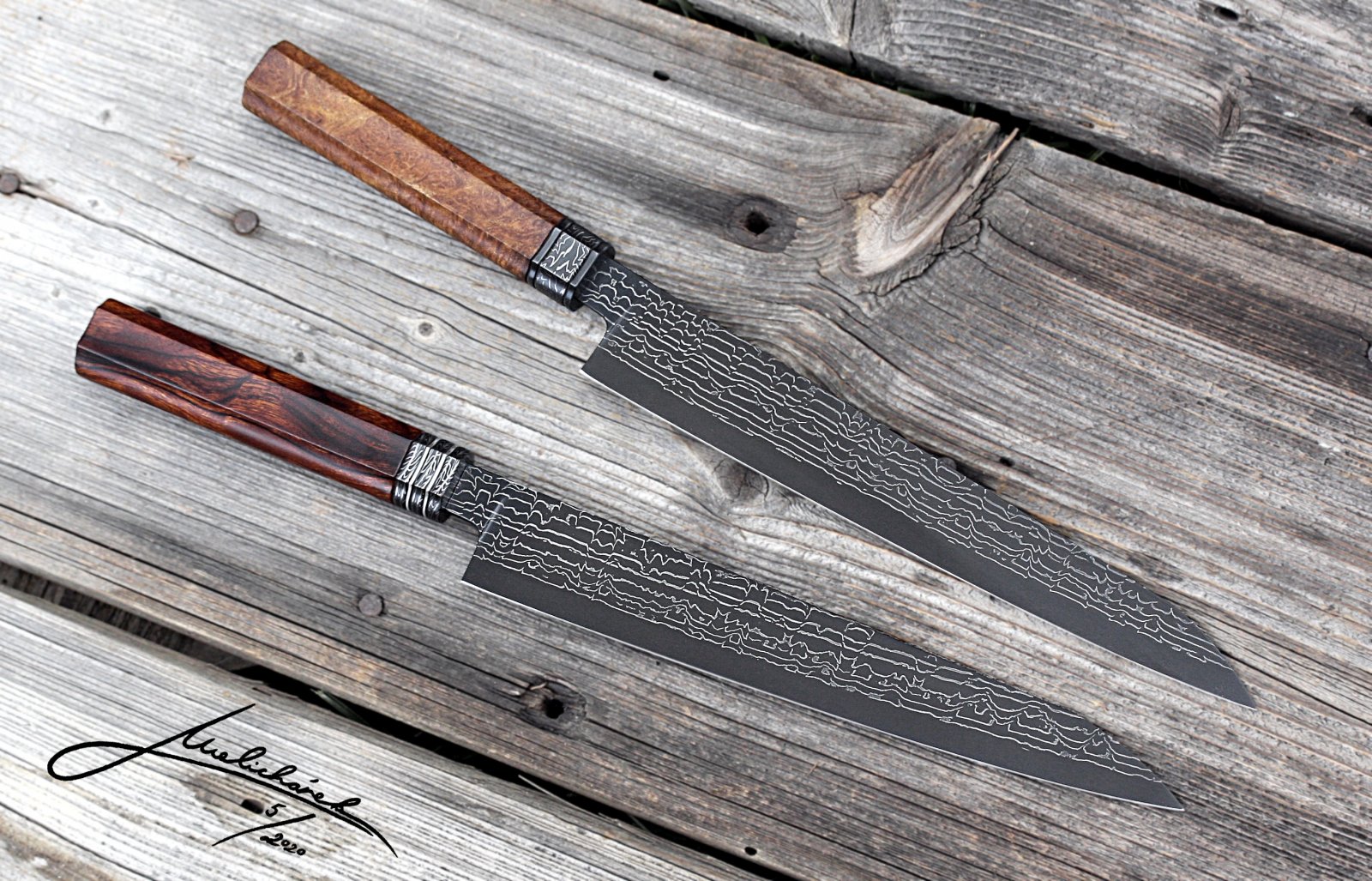

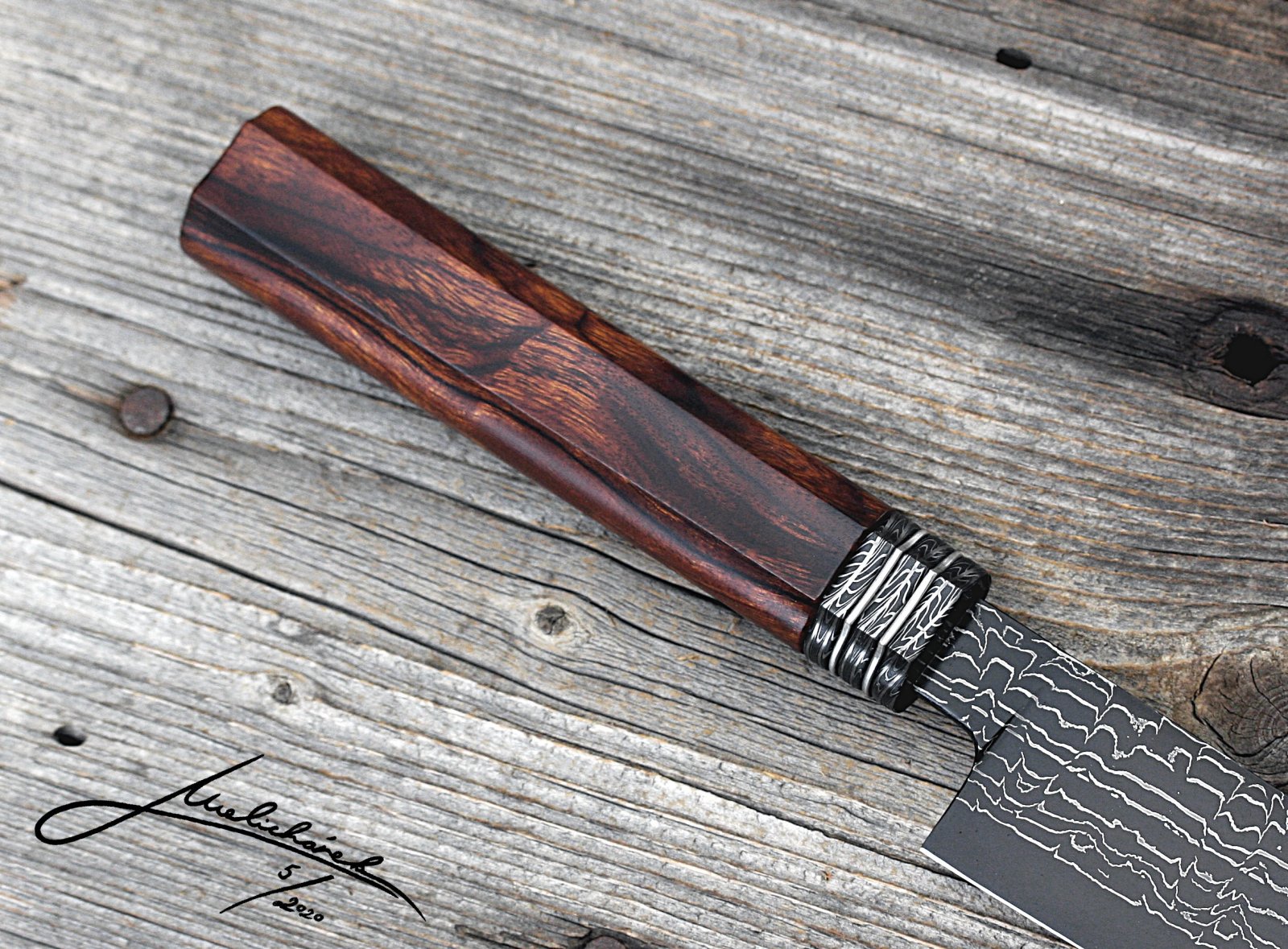

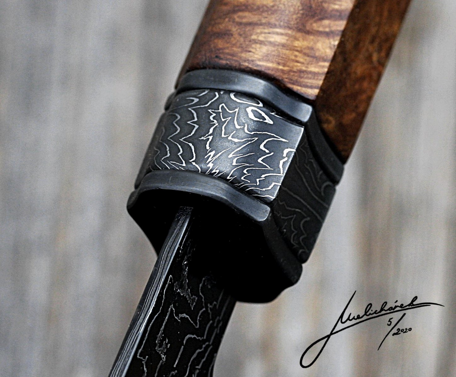

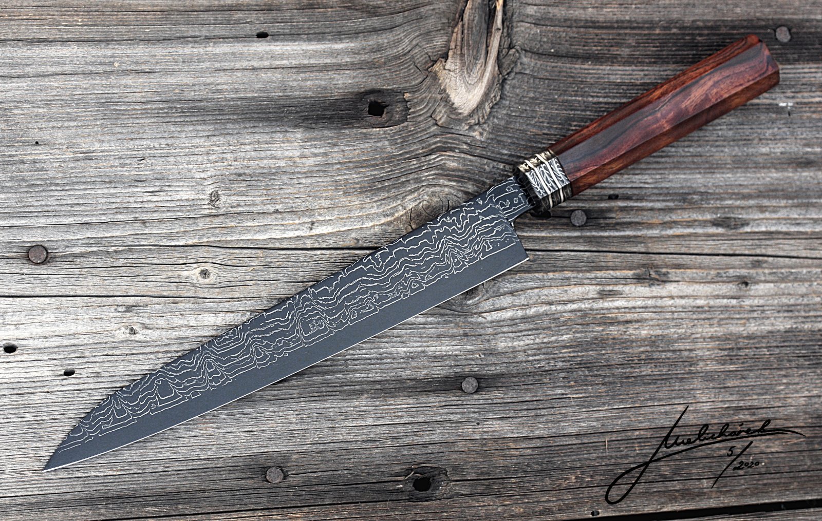

Hi everyone .

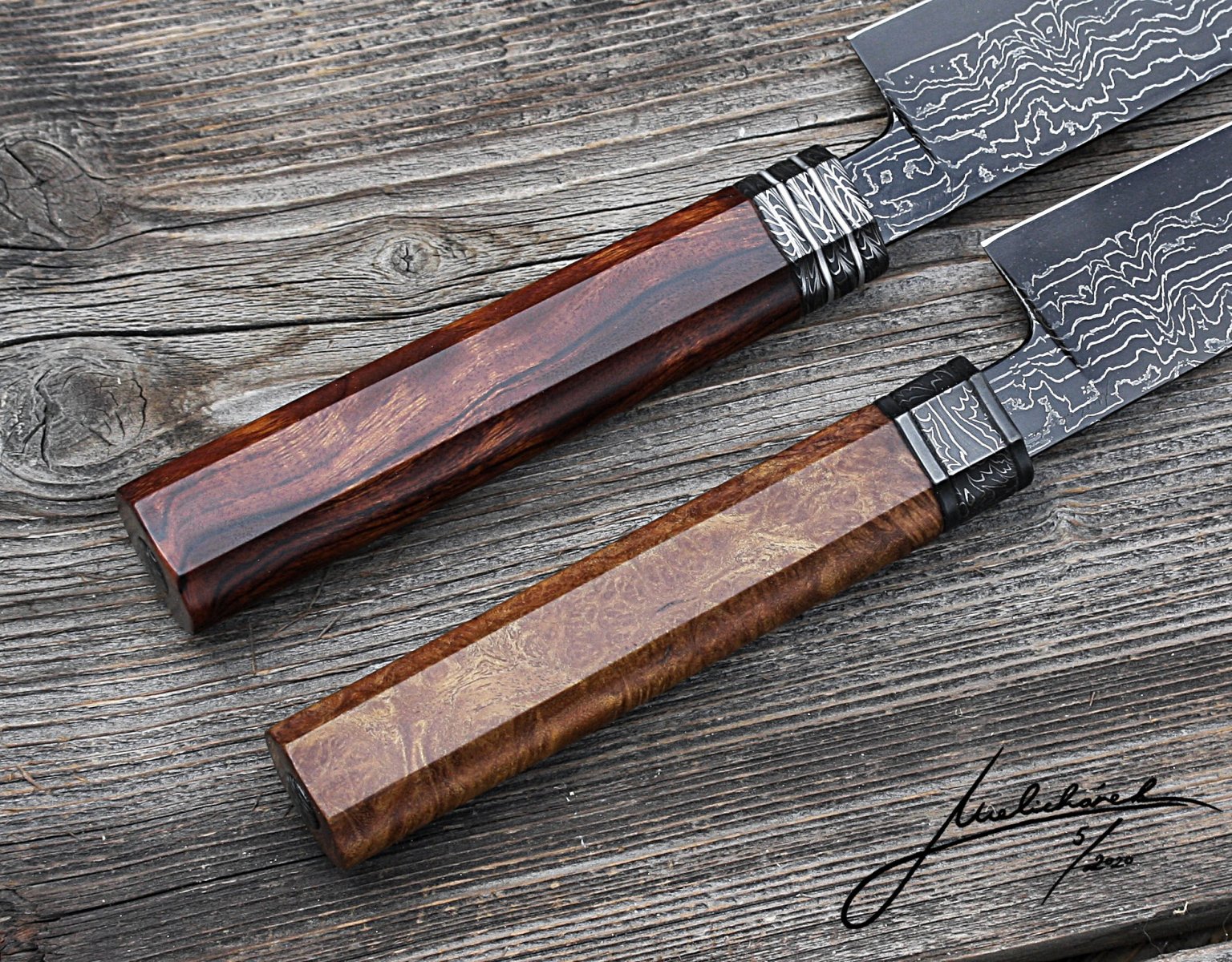

Today i finished a pair of sujihiki knives I've been working on for the last month. Two knives for two friends. They are pretty similar and yet little different, just like them I can say that according to the length they are definitely the thinnest and sharpest knives I have done so far .. Heat treat was quite thrilling but in the end they came out nicely The handles are shaped to something like "violin" crosscut. I hope they will like them and see you soon with more knives
bb Petr
Thorn and Rose

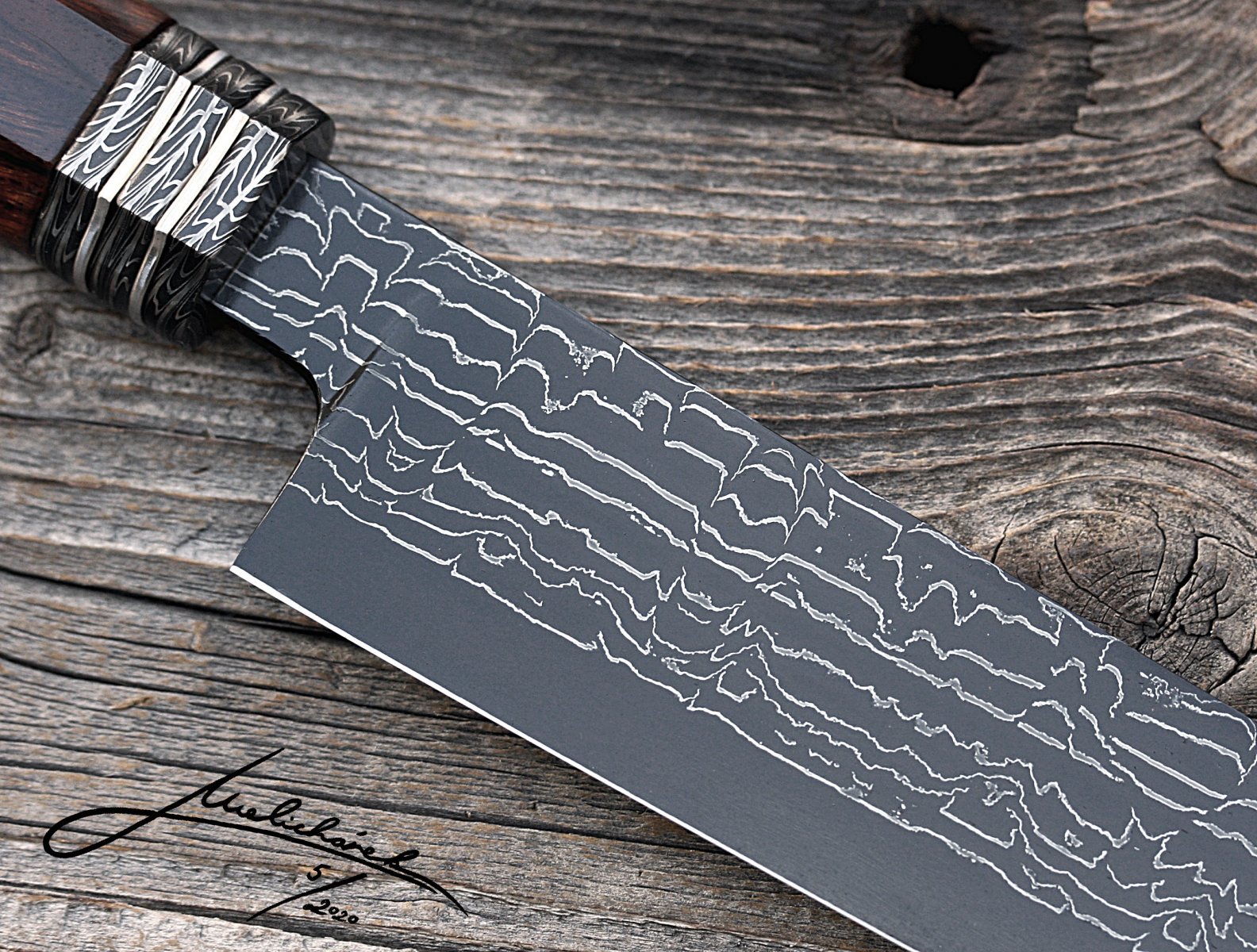

Blade - crushed W damascus steel 1,2842 (O2) + 75ni8 Uddeholm (15N20) + added edge 1,2842 (O2)

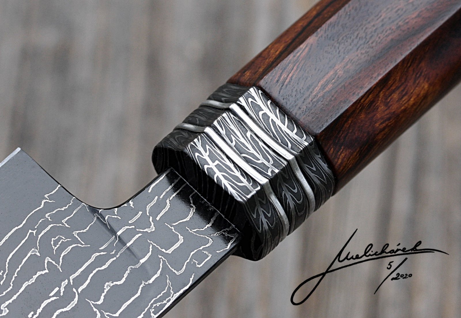

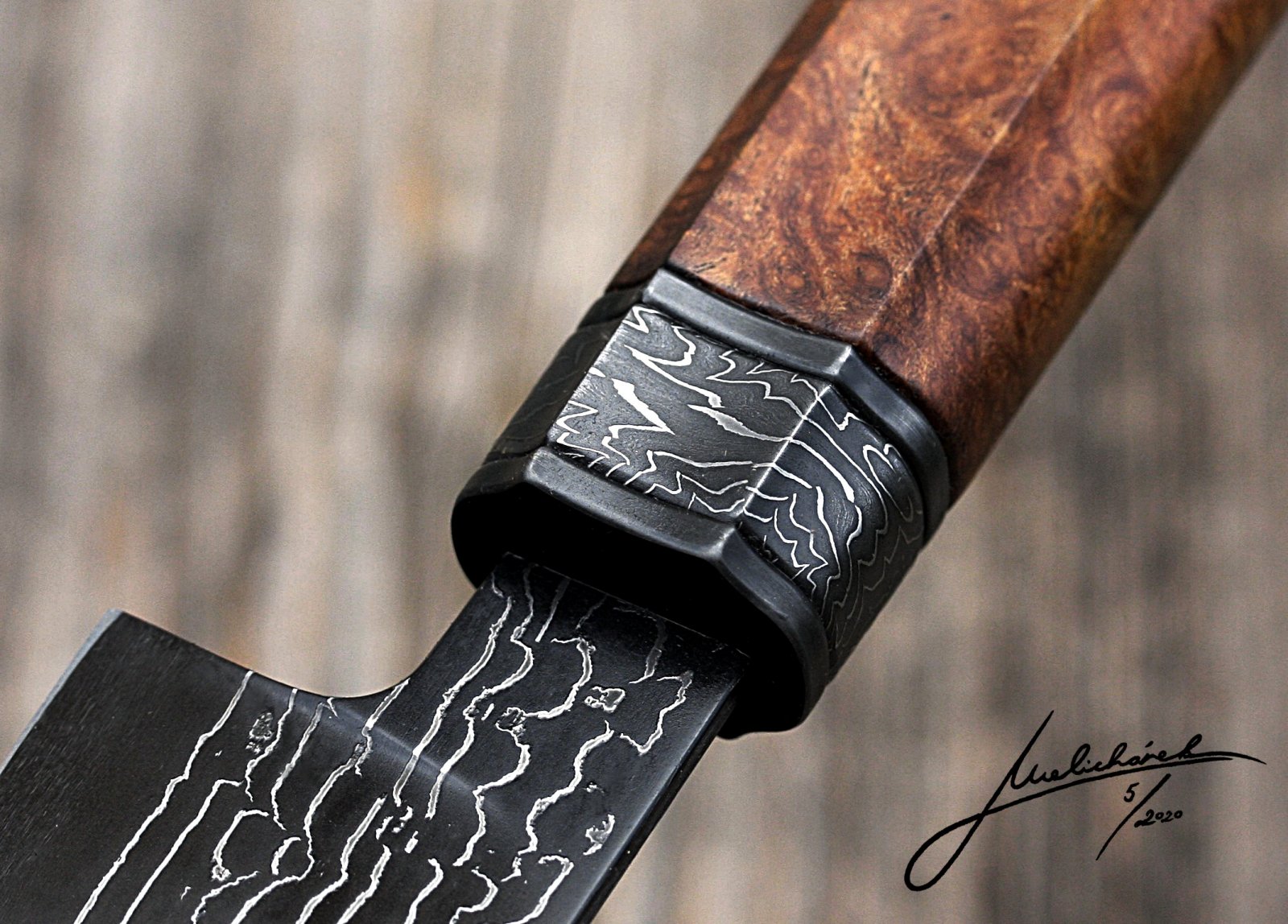

Guard - damascus steel 1,2842 (O2) + 75ni8 Uddeholm (15N20), stainless spacers

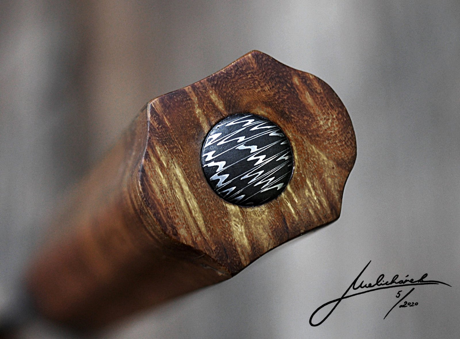

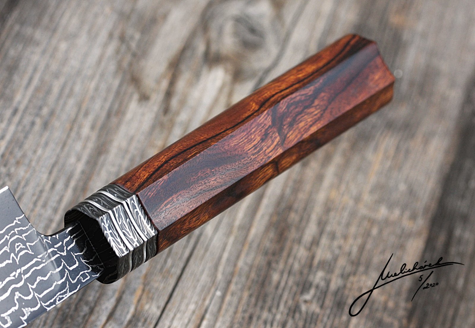

Handle - Black locust burl , Arizona ironwood
Average length - 40,5 cm (approx- 16 inches) , blade - 26,5 (approx- 10,5 inches).
Blade width at widest point 38 mm (approx 1,5 inches) , blade thickness-distal taper 2,3 mm (0,09inch) - 1,25 mm (0,049 inch).
