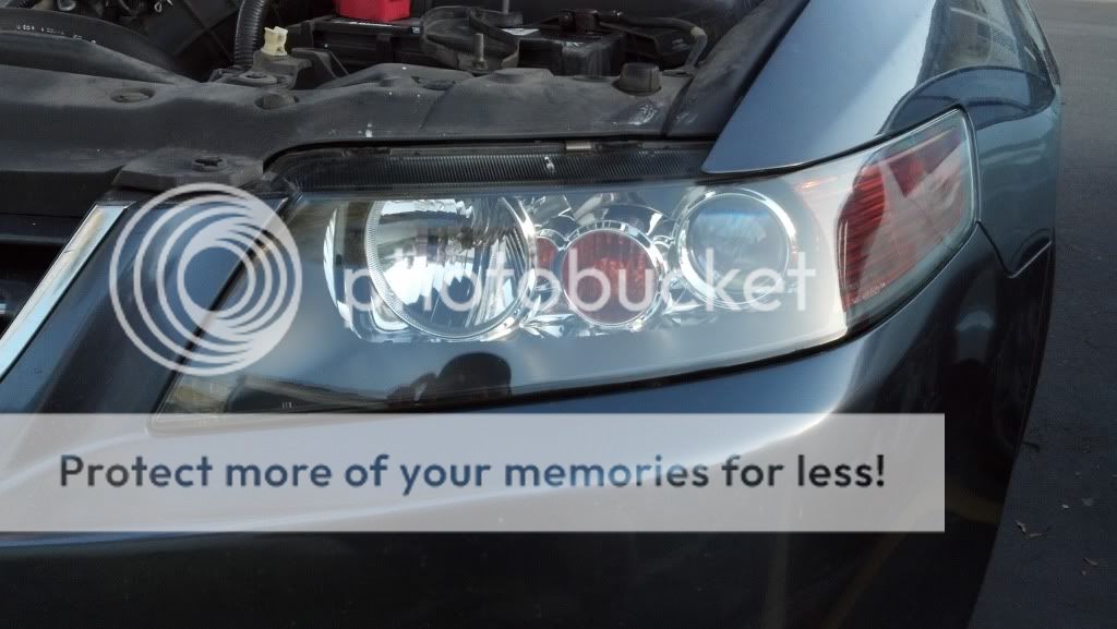

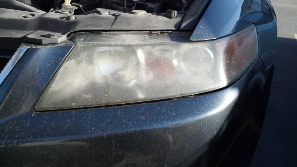

High grit sandpaper yes...plastic polish no. In my opinion at least. Finish sanding the lenses with 2000-3000 grit sandpaper until mirror finish and paint Helmsman Spar Urethane/clear mineral spirits mix onto sanded surface. Here's one headlight (of about 2,000) I skipped the polishing stage--the semi porous surface held the Spar urethane mix for about 2 years before any further degradation. Had I just polished the lens it would have re-oxidized within 3-5 months:
Before
After
Before
After
That is the worst I have ever seen. Is there a certain climate or condition that causes this? How old was that car? I have never owned a car that has done that myself.
Dry coastal desert air mostly. If I had a penny for every car with bad headlights I would have bought Benchmade by now. Very common problem. I moved on to a bigger and better market in San Diego so I gave up the headlights. I did just recently restore some lights for a buddy of mine and it was cool hanging out. I charged $99.00 for a set while I was doing it. Good supplemental income. To further answer your question this was a 2004 Acura TSX. These lights were severely oxidized, so much so that I had to start with 300 grit wet sand paper from 3M to remove that initial oxidation. A lot of Mercedes, BMW and Acura headlights have a very hard plastic that can be stubborn. If you start with a 600-1000 grit you will spend 5 times as much time sanding as if you start with a 300 grit paper...it really removes sanding time. If you have a Honda or a Lexus you will more likely start with a 600-1000 grit sand paper as the plastic is much softer.
