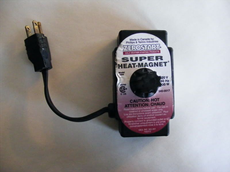

Magnetic oil pan heaters on hydraulic and oil reservoirs
