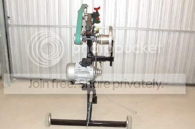

Thought I would share this
Its all done
daedong,
That's awesome. Talk about sole authorship, melting and pouring aluminum, then machining it to suit your needs, simply awesome.

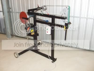

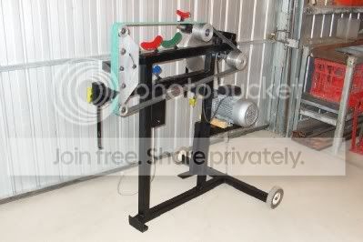

As you can see I changed the motor. The first was a 1HP 1440 RPM, It was in need for bearings and my belt speed was a little on the slow side. So I bought a new 2 HP 2850 RPM motor off Ebay. Its got plenty of speed now and lots of grunt. I probably will make a few attachments, small rollers ect for notching pipe.
O like the rolling frame. If a guy had an open shop you could wheel it to good light and put it away as needed. Excellent job
Too funny, after looking at the first pics of it in "dry-run" mode, I was going to suggest a support piece of square tubing under the front end. I see there is one in the final product! :)

That's a really nice sole-authorship version of the Unigrinder!
The belt travels at about 5000 FPM does anyone have any horror stories about grinders like this when a belt breaks?

See if you can setup some anchor points to attach the frame to,
so you can lean into the platen and the grinder disk w/o tilting
or moving it.

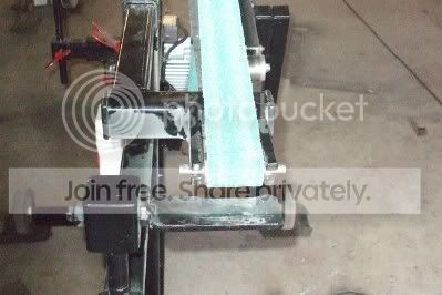

I have now made a pipe notcher attachment, It works really well.

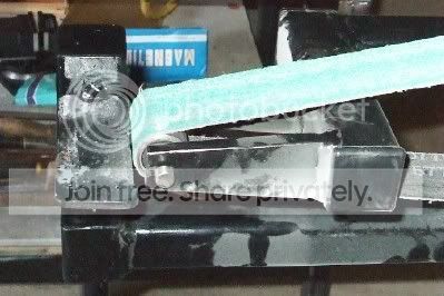

One way to avoid the belt slapping you when it breaks, is to add two very simple belt guards on your unit.
Where the two vertical posts are, add an upright piece of 6mmX50mm (.25X2") flat stock that extends above the belt about 50-100mm (2-4"). Tap a 12mm (1/2") hole in the top (above the belt) and screw a 100X12mm (4X1/2") bolt into the hole ,so it extends out over the belt. If a belt breaks it is stopped/retained by these simple guards, and does not fly around in the air and smack you. They won't interfere with belt changes at all.
