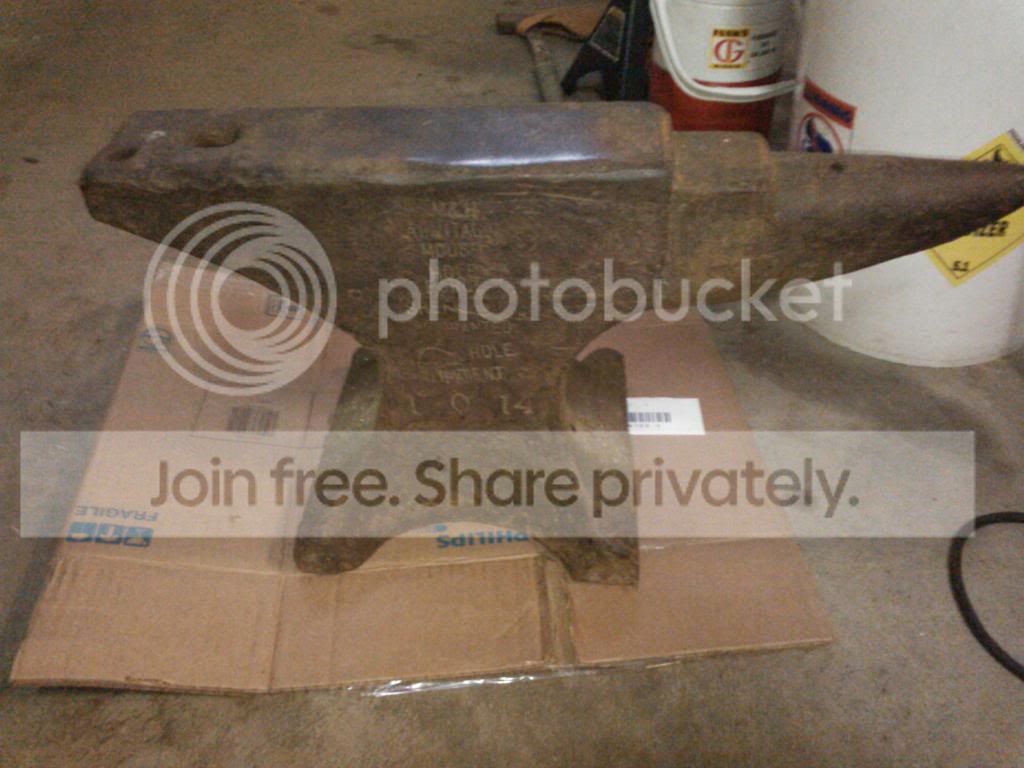

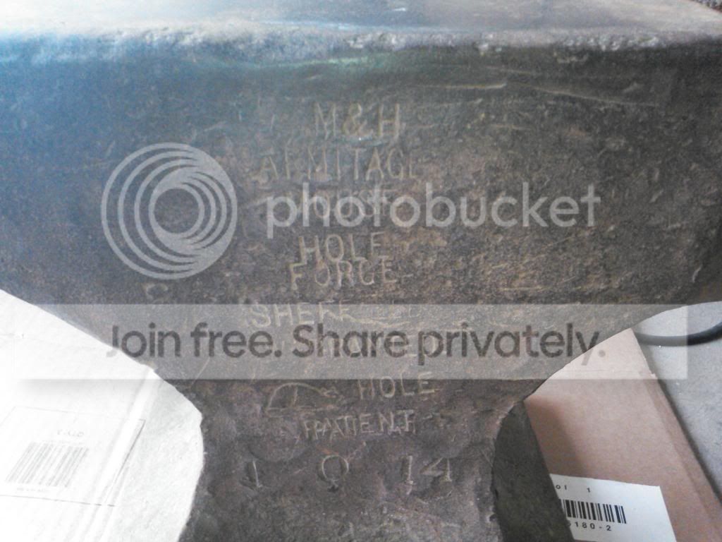

This is my new to me 1879 ( my best estimate ) Mousehole 126lbs Anvil
I only had online guidance for shopping but the top is flat with minimal pitting and decent edges. I used a 1in 52100 ball bearing in a marked tube and got almost full rebound 90% in all the workable surface.
I realize this is on the light side for what I will need but I will buy a heavier one in the future.
I have a total of $375 into it which isn't great according to some but after looking at 6-7 others this one was in way better shape than any I had found over several months of looking.
I love history and wish I knew where this has traveled over the last 1xx years.. I have to admit old tools like this make my imagination run wild.
