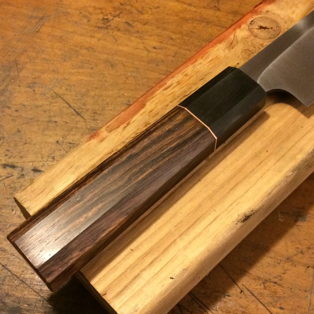

This knife is my first traditional Japanese style knife, first Wa handle or hidden tang of any kind for that matter, and first asymmetrical grind. It has a 36" hollow grind on the back done by hand with a curved sanding block. The back and blade face/ricasso are 800 grit hand finished, the bevel is scotch-brite satin over 1000 grit hand finish. Handle is cocobolo and gaboon ebony with copper accent. Of course being something new and different there are a few things I would like to get even better, but overall I am very happy with the results. Not sure what its fate will be yet, might keep or sell or sell/beta test with someone. At any rate, had a great time doing something different. It was one of those projects that kept me thinking about my next move, which are always the most fun for me. Thanks to Stacy and the others that chimed in with advice when I started the knife!
That is really a classy looking knife. Great lines and choice of materials.
Phil, really nice job!
Fit-up of the ebony bolster and handle looks perfect.

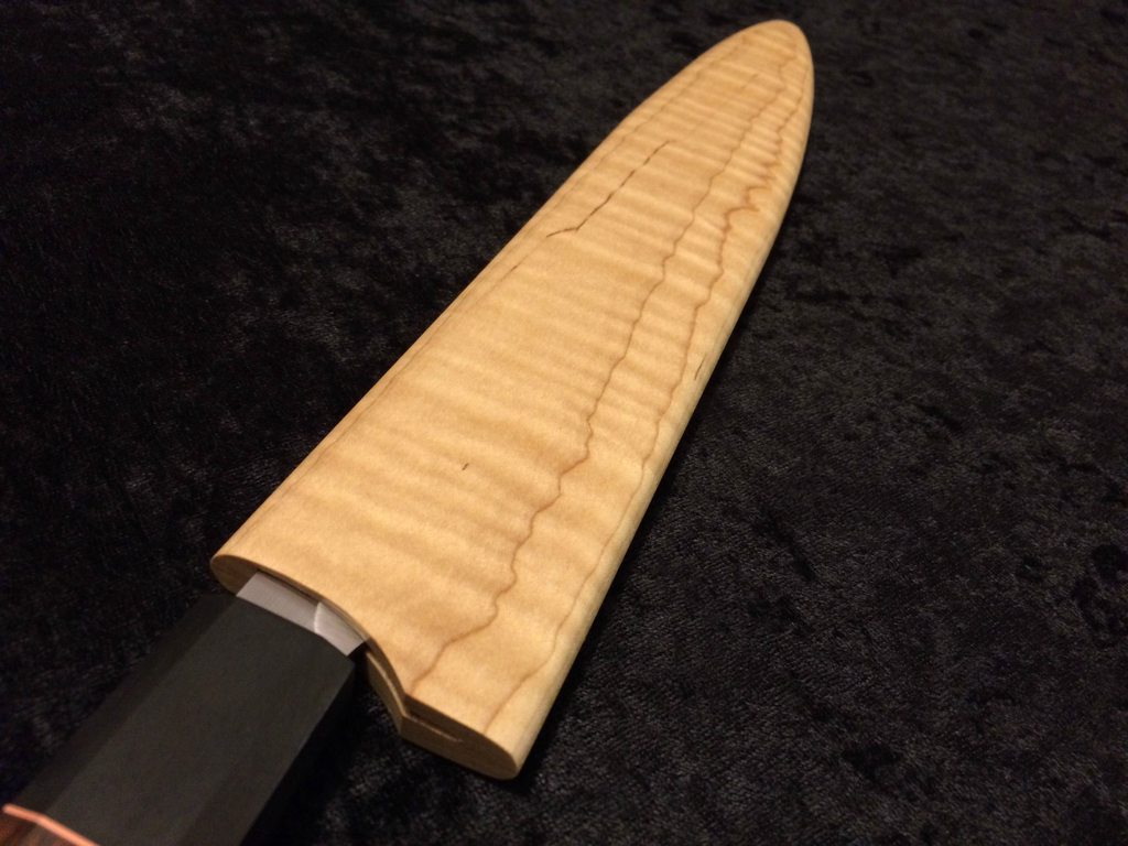

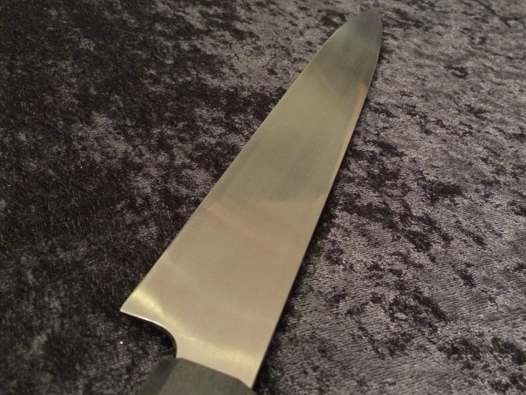

Thanks gents! Saya is already underway in curly maple, glued it up yesterday, about to go brave the cold shop to shape it. I'll throw up a picture of the back of the blade and the saya when it's done.
Wow, very nice work. I bet it was a chore grinding that urasuki by hand..What steel?

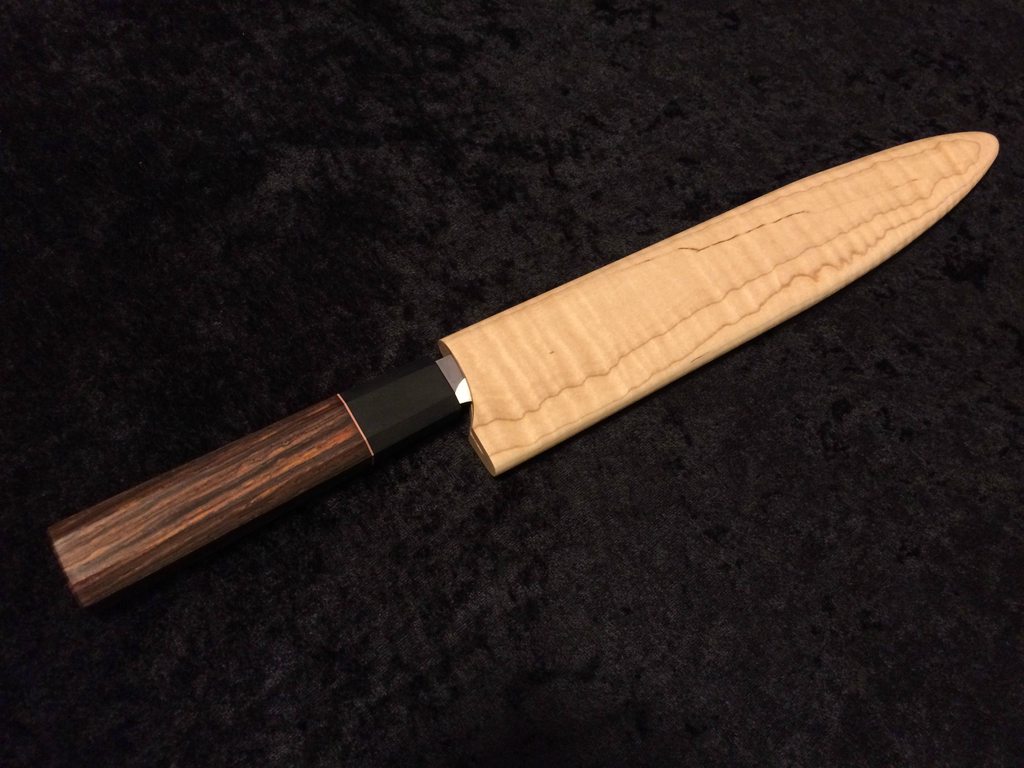

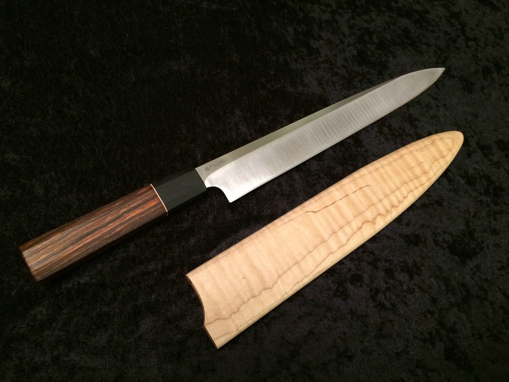

Better pics with saya, I'll still add a retention pin. I was finish-sanding S90V blades today, I've had it with knife stuff for the day. The steel is 52100 heat treated by Peters. I will probably do more of these, but switch to S35VN.
I'm curious how you will sharpen this one. On the chisel side, sharpen the full bevel?
I was curious about this too. I took the whole bevel down to 0.002" or so, then there is a very small convex micro bevel. On the flat side I just quickly knocked off the burr with the strop. It was very much an experiment figuring out how to make it work with what I have.

Your design looks really good Phil. I don't envy you the hand sanding the urasuki. Your blade is a great shape though.
I have roughly the same design with mine on the bevel, but yours is much wider. I'm sharpening mine now, and it's a real challenge.
I'd be very interested to hear more of your thoughts on this one. It was a real challenge for me to make, but very interesting too. Are you going to make another?

Saya came out nice.
