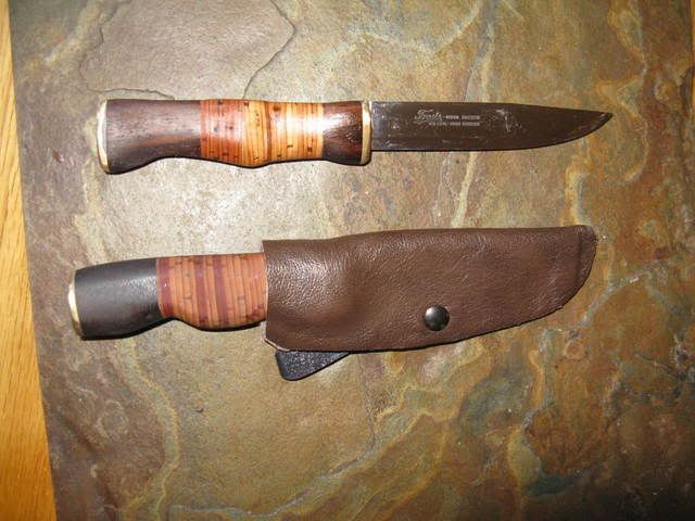

I use a lot of Mora Blanks to make knives for my friends and family, I highly recommend the Laminated and plain Carbon blades.
I also just finished a 5" Frosts Sandvik 12c27 and it is a really nice blade. Then again it was 25$ instead of the more typical 10$ ones.
