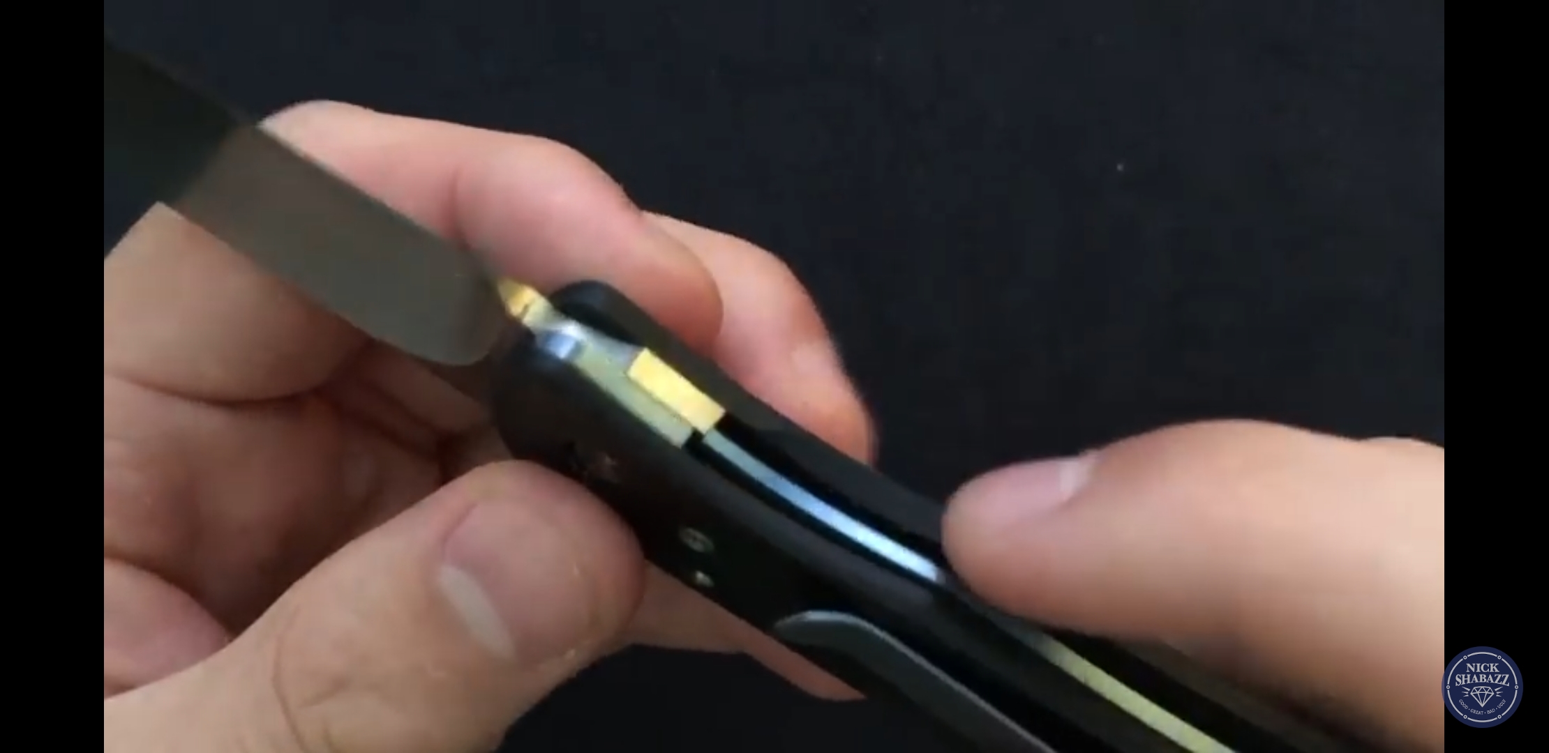

How does everyone feel about an asymmetrical liner lock? One that it has the single liner on the lock side. I've been thinking about building one of these and o ran across a nick Shabazz video of one now idk. Heres a pic to give you an idea what I'm talking about

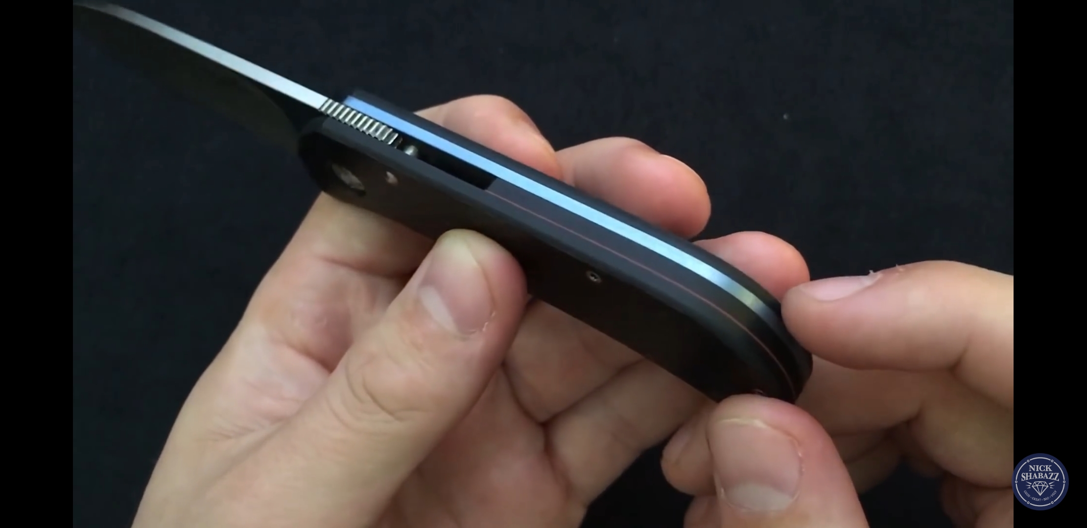

Looks like the lockside of the handle will be quite a bit thicker than the other side, that'd bug the crap out of me, however that probably won't be a big deal to most people. I say go for it, It'll be unique
I think with a thinner liner like. 050 it wouldnt be as bad. But with that thicker one it kinda sticks out pretty bad. Wasn't sure how others felt about it. I like that it saves on weight and thickness. I've already started making one and itll be just as secure as one with 2 liners.

Any chance of a picture of the lock? I'm curious.

Is it just me or when looking at the butt end, the knife is blade is symetrically aligned with the scales and both sides look to be functionally the same thickness?
Well for my liner locks I've been using. 056 thickness so the scale on the lockbar side, I can just remove .056 from the scale and then both sides will be symmetrical and more appealing to the eye.
D Danke42 here is a screenshot of the lock bar
