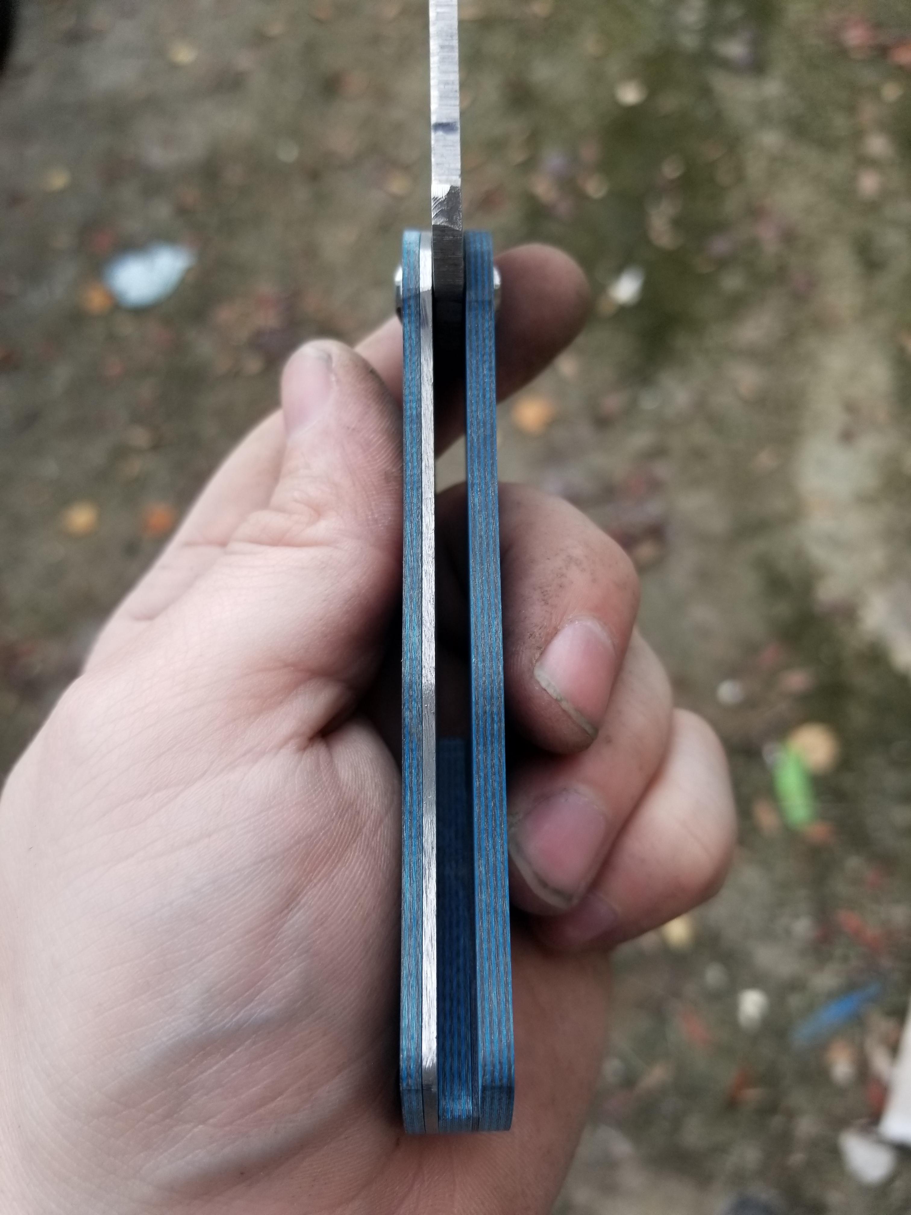

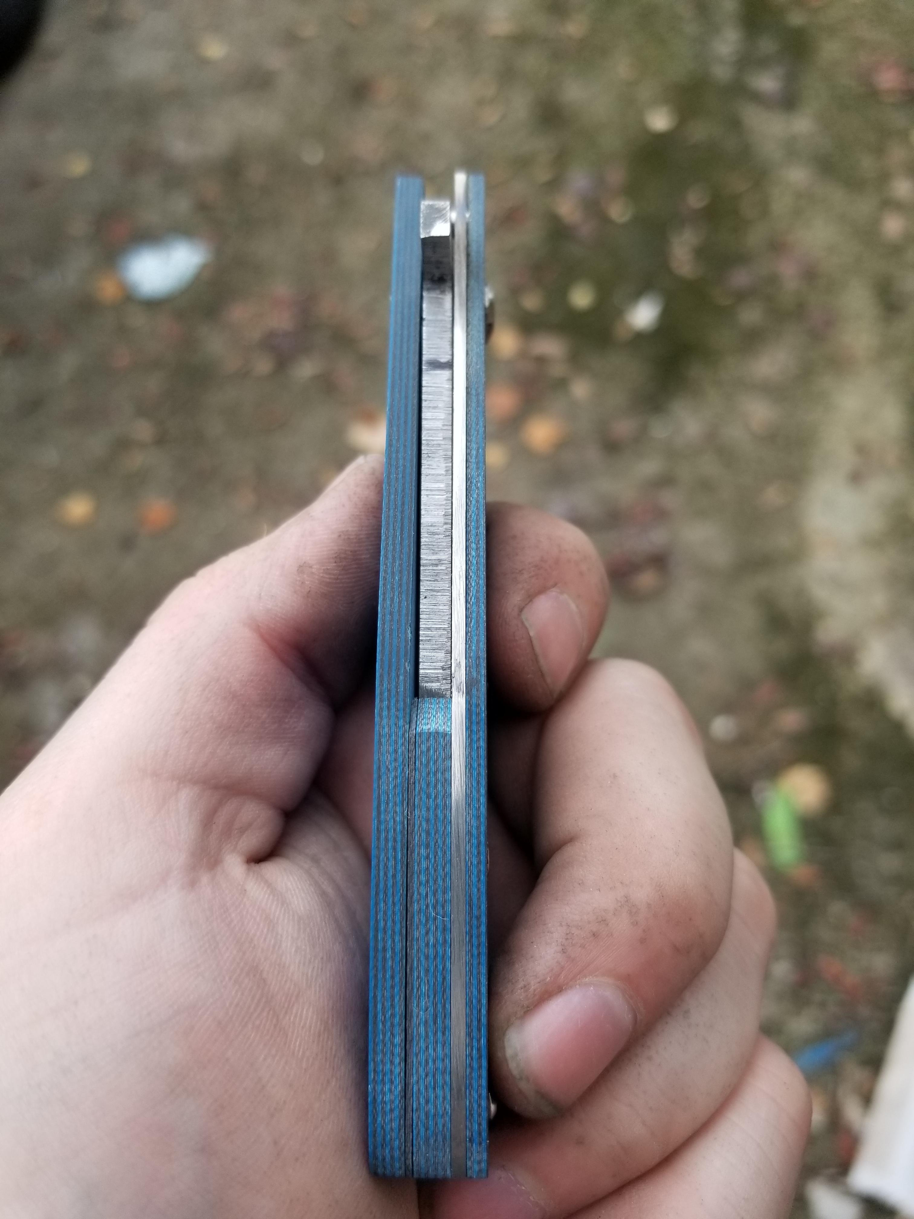

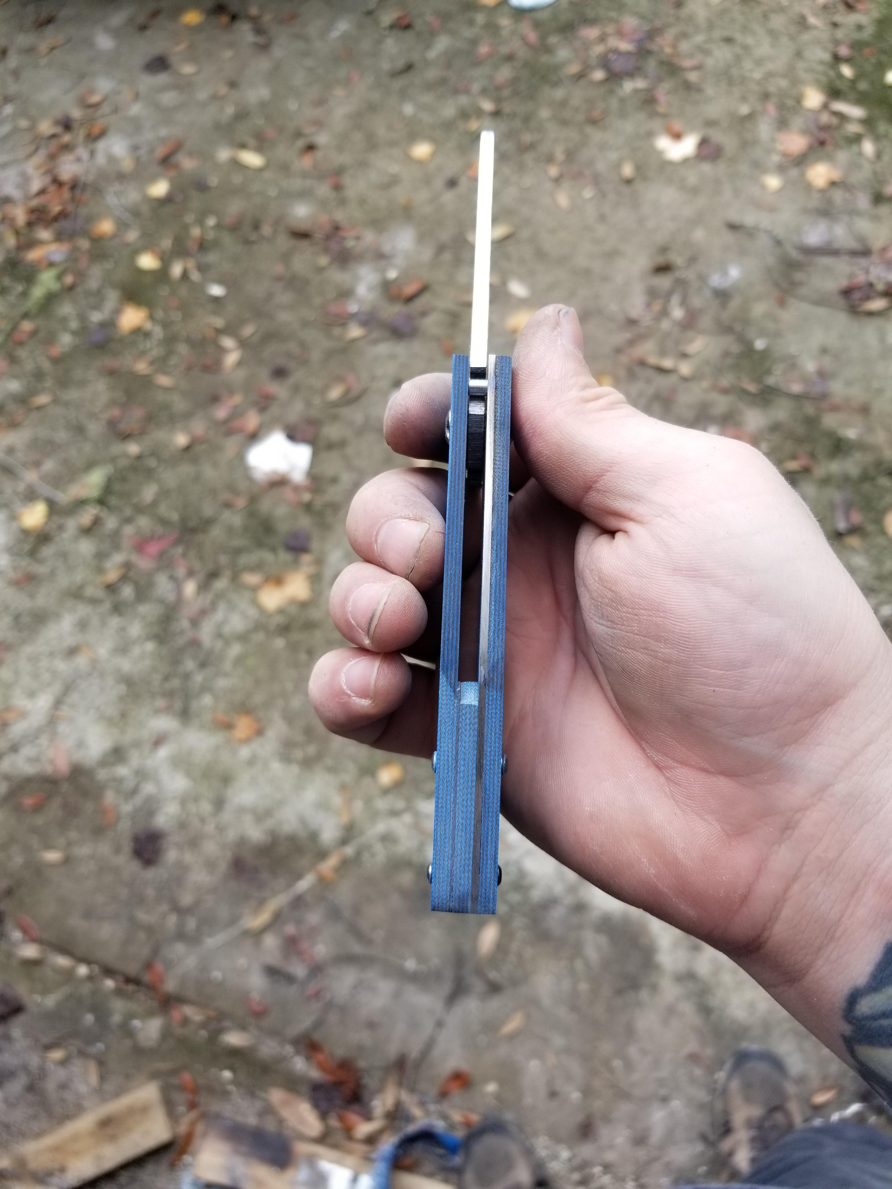

This is a .050 liner and I haven't thinned the scale to make them perfectly symmetrical.
That looks great!! It definitely improves the grip when both sides of the handle are even in my opinion. I have a Kershaw Skyline XL that isn't even on both sides and I think the ergos suffer because of it. I can't wait to see your finished product.
