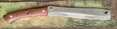

I think a 420hc Froe is a great idea! Or even a 104.
Buck prefers 5160 for the froe. It stays razor sharp too. Light touchup with a Big John ceramic rod is all I use. IMG_1298.jpegStill missing a fastener as Buck customer service has not answered any emails. I always have avoided 420 and still do. I like 5160,the edge retention has been just fine on my Siegle. I use it often for fruit and chicken breast, have yet to touch up the edge. It still feels quite sharp. I called BUCK CS after this post. They sending me fasteners for this froe.
Buck prefers 5160 for the froe. It stays razor sharp too. Light touchup with a Big John ceramic rod is all I use. View attachment 2983111Still missing a fastener as Buck customer service has not answered any emails. I always have avoided 420 and still do. I like 5160,the edge retention has been just fine on my Siegle. I use it often for fruit and chicken breast, have yet to touch up the edge. It still feels quite sharp.
I'm very familiar with Buck's 5160.
A rust resistant option would be nice tho....
And if 420hc is so tuff, why not?
